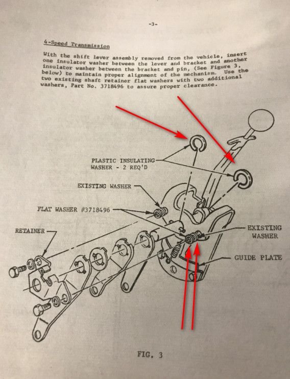

I am missing the plastic insulators although I do have a picture of what they look like (below)
I am missing the washer/washers that were supposed to be between the retaining plate and the body of the assembly
Apparently the existing washer + 3718496 was used to create "proper clearance according to page 231 of NCRS guide 63-64 (Technical Bulletin)
Anyone got a picture of what I am missing? Odds are 1 in 1000 but I thought I would ask 3 pictures below
