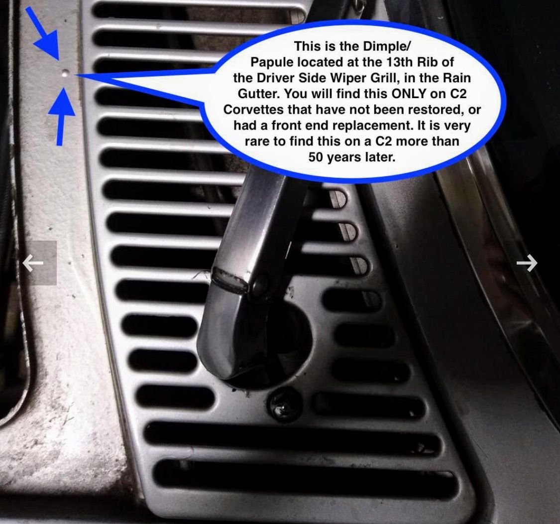

It this true?

Originally Posted by Dan J
I thought the AO Smith bodies did not have the pimple, just St. Louis bodies.
ALL midyear assembly-line upper surround panels had the "pimple" in the drain trough; there was only one steam-heated (steel) mold, at MFG in Ashtabula, and that plant fed the Body Shops at both St. Louis and A.O. Smith-Ionia. They both got the same panel from the same mold at MFG.

as far as I know it was on all mid year panels and I would think also on over the counter top surrounds too

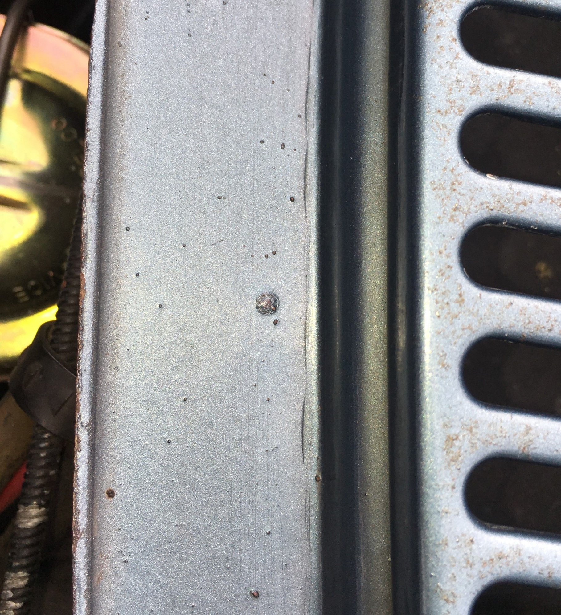

Here's one I took from a friends '67, I'm 99.9% sure its original.
My '67 doesn't have one because it's restored.

The dot had its own thread a while back, long and distinguished, a bit over the top, but befitting one of the few characteristics found on every C2. Now, there are those who claim that certain runs of cars did not have these dots, but those are likely the same guys who swear there were 67 327 cars with big block hoods. maybe did just a bit too much blotter acid...

Yep, my 65 Convertible still has its pimple next to the 13th vent slot.
