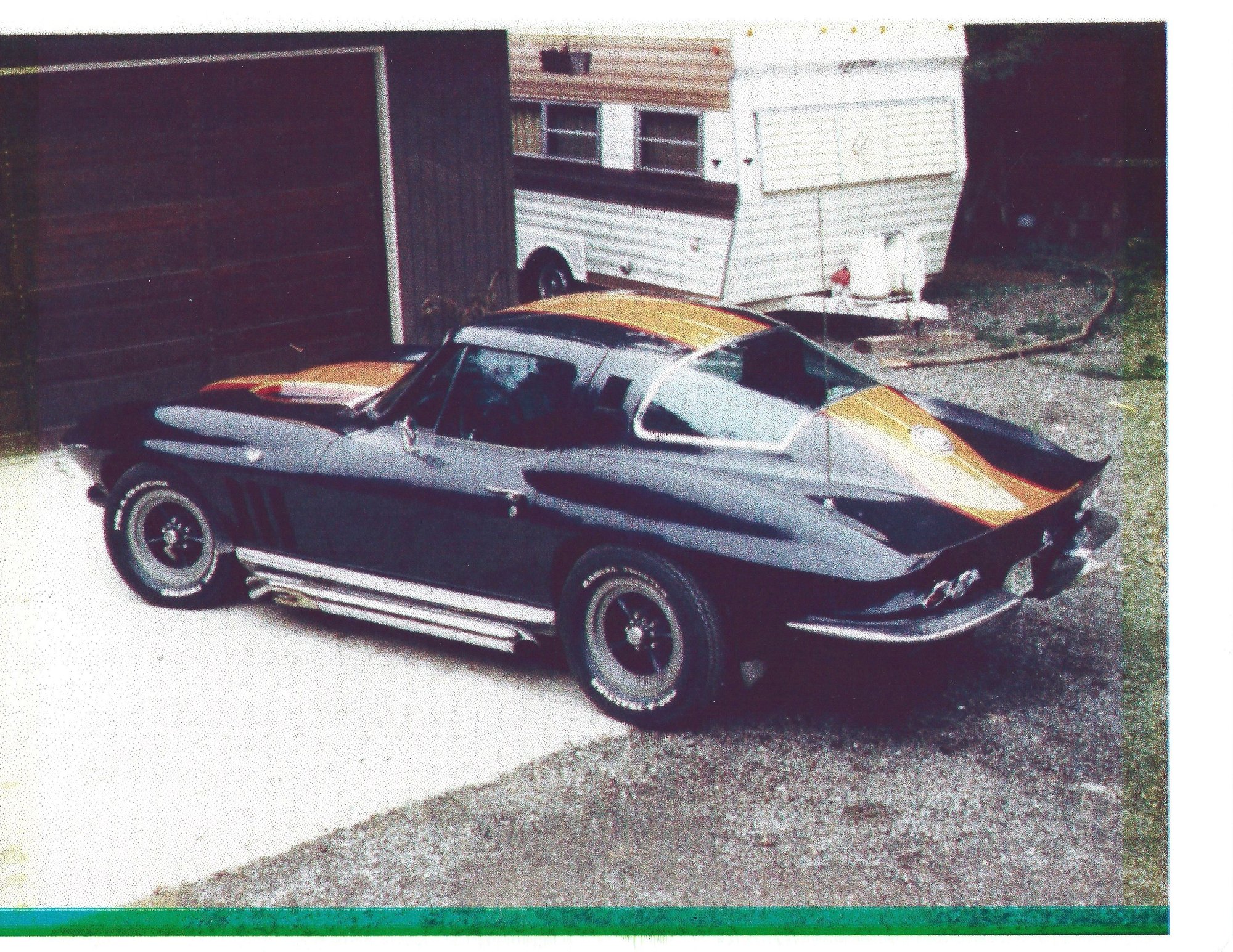

This was my first Corvette. Picture taken back around 1975. Before I had it painted I added that Ecklers front spoiler and the ducktail. There was a road near where I lived that I could run wide open. Before the spoilers at 120 mph I had to hold on with both hands to keep it in my lane. After the paint and spoilers I ran it up to 140 mph and could take my hands off the wheel. Couldn't believe the difference.
I like that car

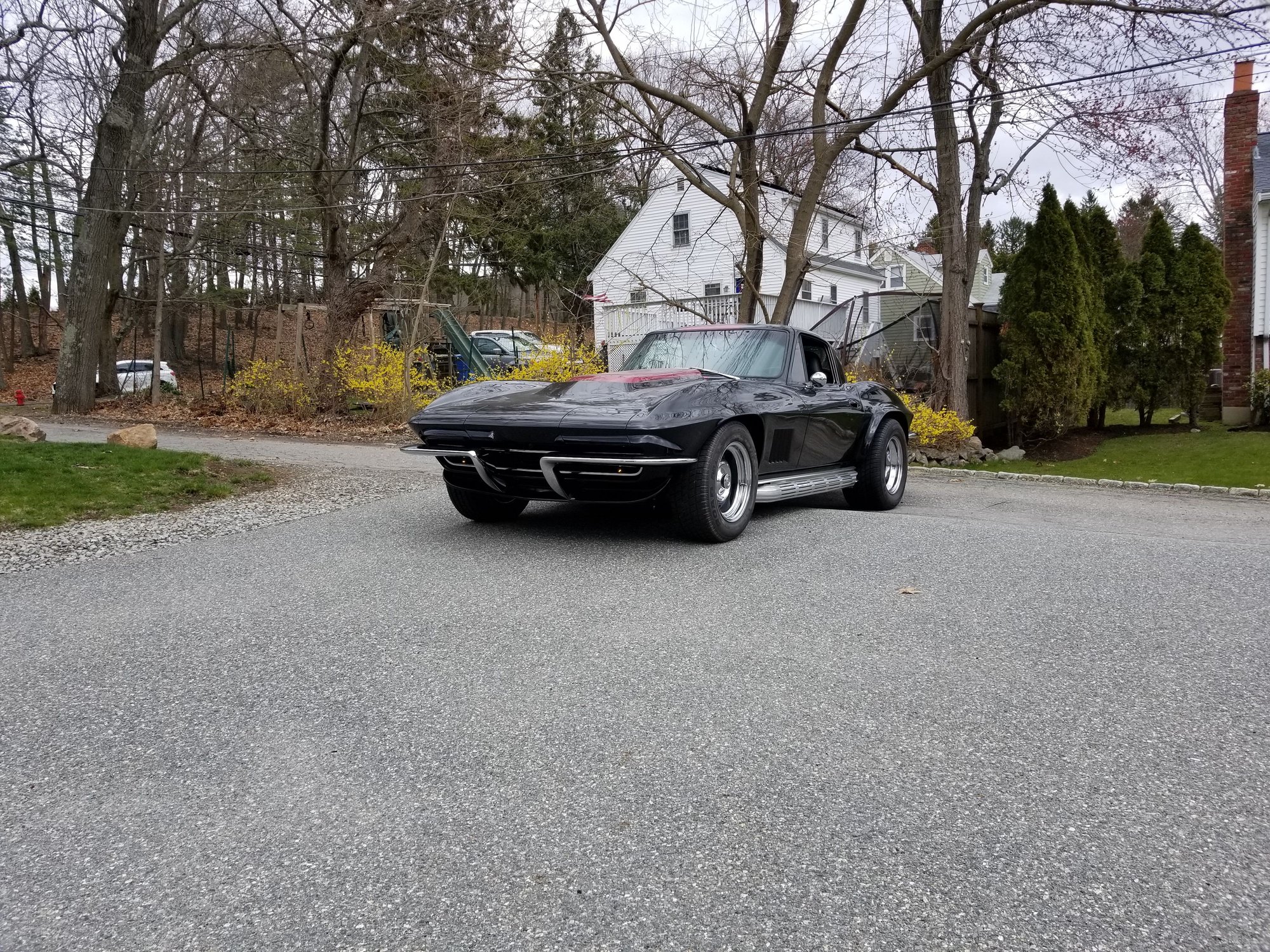

Originally Posted by Tom Austin
In the 45 years I've owned my car, I've wanted to put a front spoiler on it for the last 30 of those years. Well . . . in celebration of National Corvette Day . . . today was the day!!! As a few before me have done, I started with the 69 Camaro front spoiler, cut 3 inches out of the middle, glued it back together with JB Weld "plastic bonder". I reinforced the back with glued in strips of abs to give it some strength and sprayed it with some Rust-oleum Peel Coat "Rugged Coat" which is intended for Jeep fenders . . . it;s a cool "rubbery" coating that should last for years. I think it turned out OK!!!
This is an Eklers spoiler, tough to see because the car is all black.
I had to rework the ends of the spoiler because the parking lights were removed.

^^^ Yeah. I'd really like to see your spoiler. Looks like the day was overcast. Maybe a brighter day.
I will try to get a better picture this weekend if it's sunny out.
