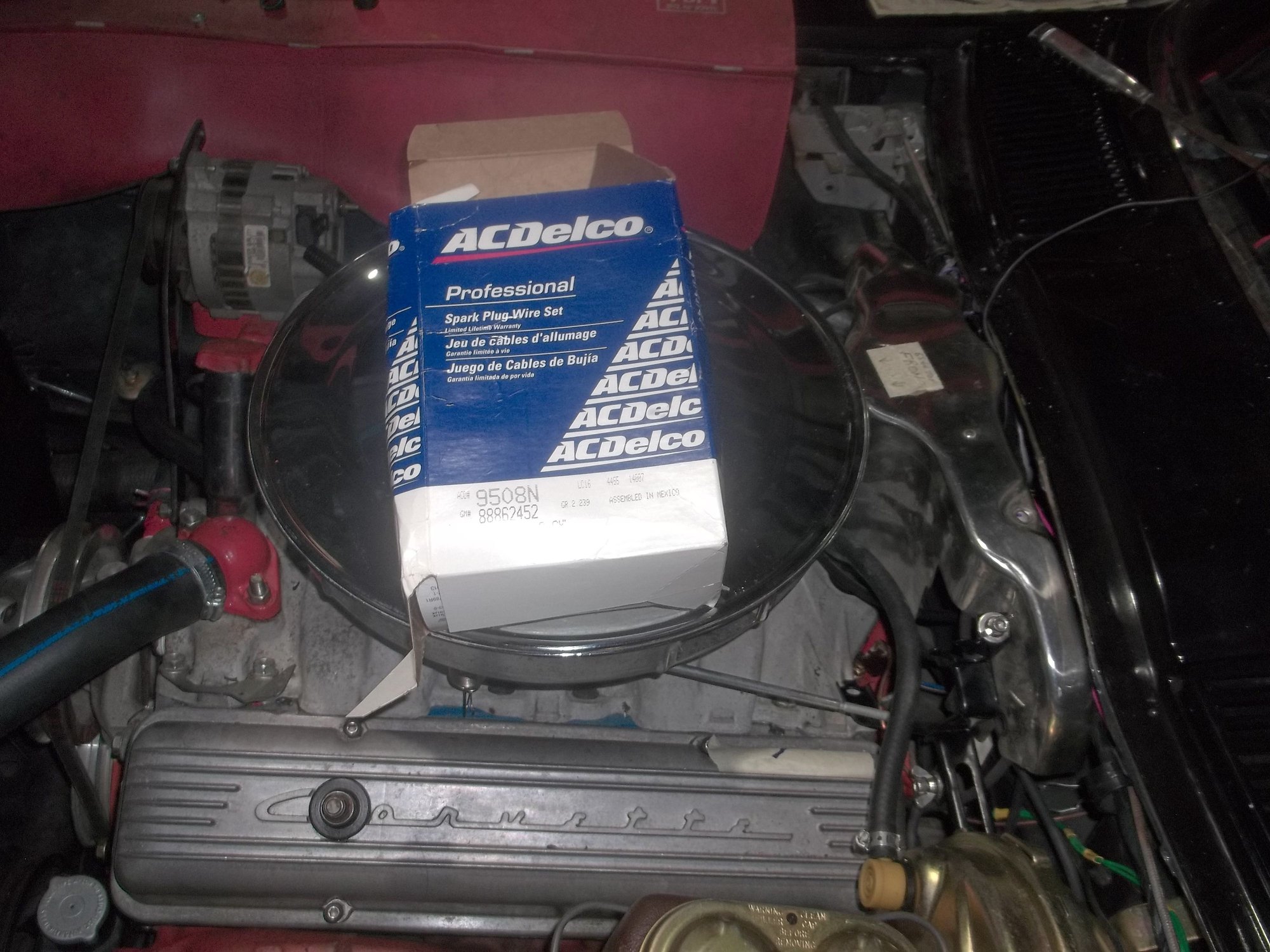

i'm doing this right now,,i just installed my original 64 365 intake on my zz crate engine.i wanted it to look as stock as possible so i had to use the 64 distributor as the crate hei would not fit the 365 intake..i used a pertronix and wanted the wire shielding and stock routing so i used the stock ac delco wires
the stock intake allows me to use the original air cleaner which also touched the hei......looks almost stock except for the aluminum heads john b

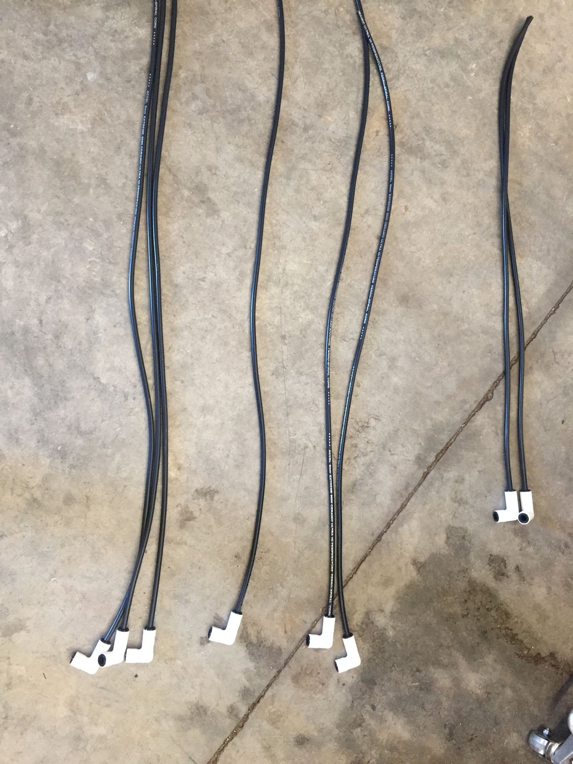

Taylor or MSD most FLAPS wires are junk. I like the cut to fit MSD wires personally. They are a tight fit in the factory wire holders but they do fit.

Another MSD fan. I used the MSD Super Conductor cut to fit wires. If you are staying with the factory plug wire routing, the standard Chevy set will not be long enough.
