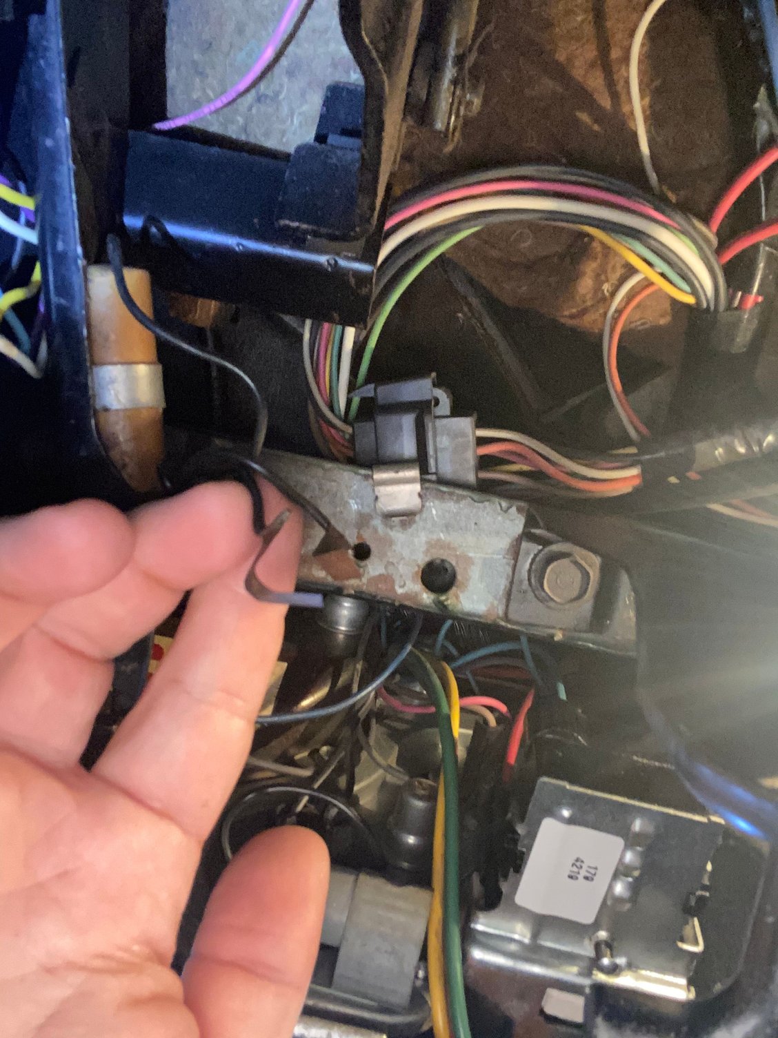

I removed the switch. I don’t want to break something but it seems like the inside should pop out? I was going to use a pick in the home on the top right. Is that correct or do you just clean and lubricate these three pins? Thanks in advance.

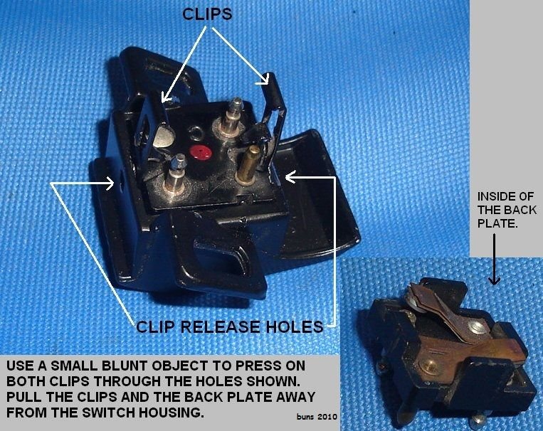

The clips on the ends not only hold the switch to the connector, they also hold the gut in. Do you see the little tang on each clip? That has to be released carefully with a small tip straight screw driver. That opens it up and then you can clean the guts with a alcohol based cleaner. Also, the copper clips can be sanded with steel wool or something soft. Steel wool the posts, check the female connection also. Some have said to use dielectric grease on the posts. I did not. Carefully reassemble, all should work like new. Dennis

Wish I had been smart enough to ask about those clips before I did mine. I spent a lot of time trying to figure out what I was doing. I do remember now that I had to take a point file to the contacts to remove some arc burrs before I used an emery board to dress them.

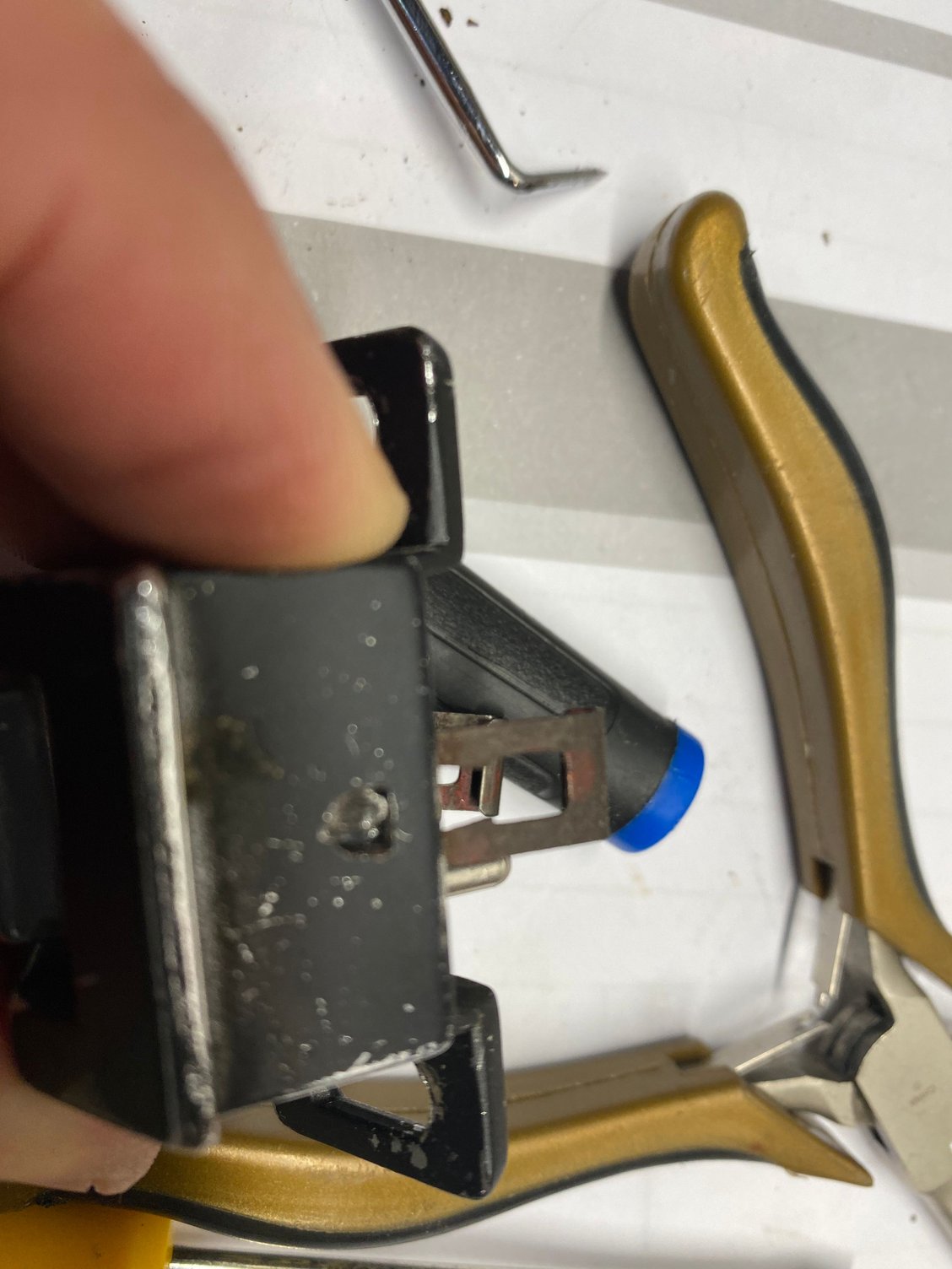

I’m probably an idiot on this but I popped the first one no probablem. The second one seems ground into the housing. I’m trying to push the clip down, use the screwdriver to release it and pull the guts out at once without success. Did anyone come up with any tricks for this? See how I’ve already worn the finish off.

Try pushing it back down some and then push into the hole against the clip. Dennis
