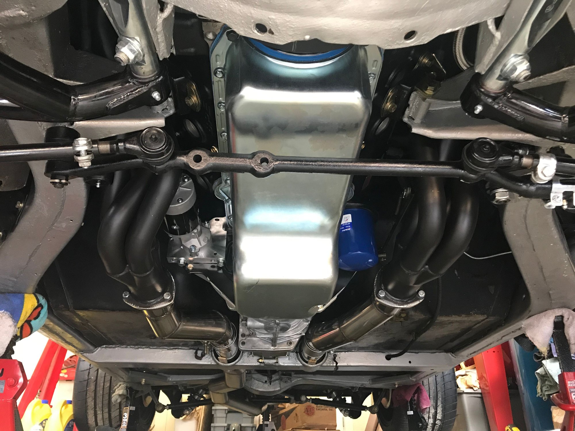

Here is a pic of how Doug’s hang under the car.
Still working on the driver side exhaust in this picture, but you can see they provide plenty of ground clearance.
