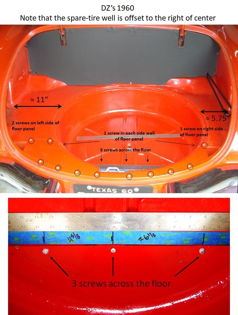

Can anyone supply a picture of the inner trunk panel showing the location of the 17 screws that all the vendors sell

I’ll toss this out for critique. I can count 17 screws and/or holes, but I cannot say if they are correct.

Thanks for the picture. All the vendors kits are 17 screws, but I'm not finding 17 holes

I may have more than 17.
Originally Posted by Todd H.
What year Corvette are you working on?
A 59 if I remember correctly.

My '60 is as above; 3 screws across the floor.
I believe 53-55 had 2 screws and I have seen at least one panel with 4 screws. 4 screws across the floor would get you to 17 total.
Hope this helps.
Dave Z

Year of car is 1959 Thanks everyone
