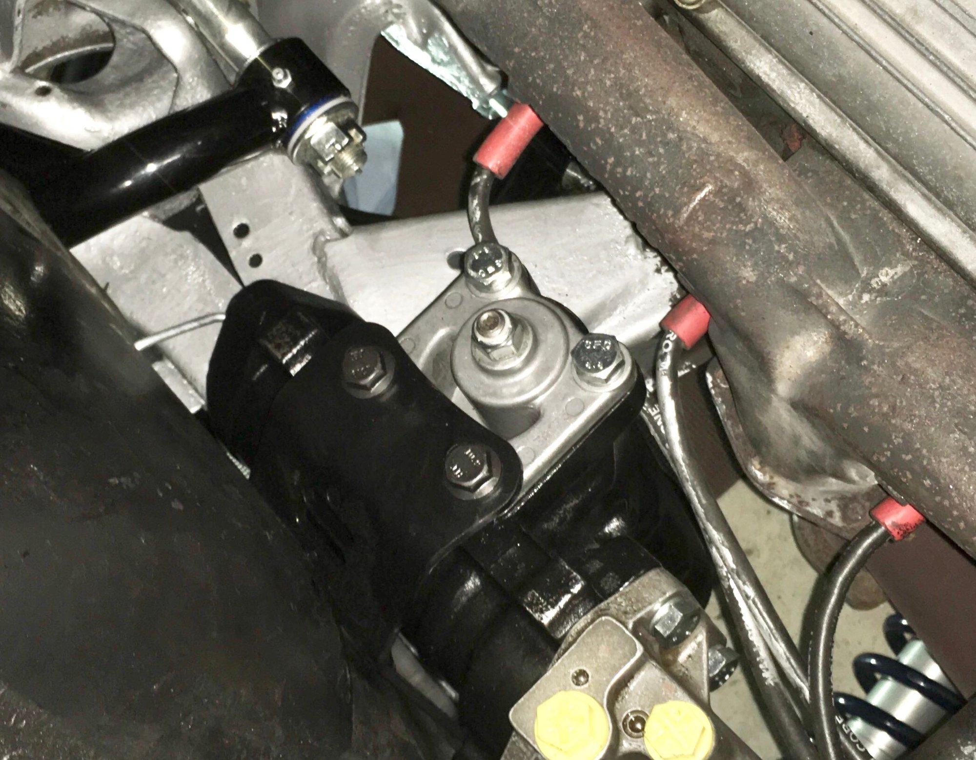

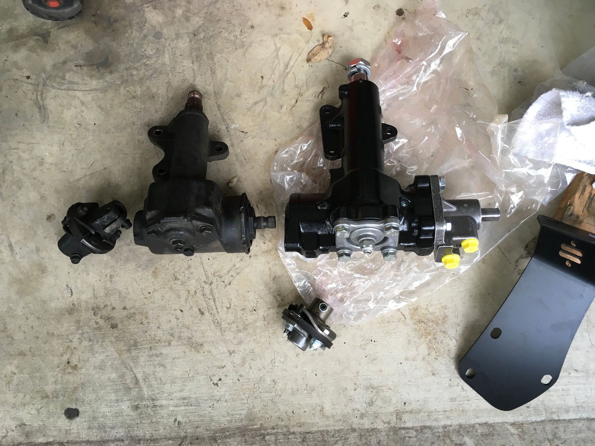

Here you go, Bossman. Works for all C2’s.
https://www.summitracing.com/parts/a...model/corvette
Stock box and rag joint on the left, Borgeson box and rag joint in the middle, Ridetech brace on the right.
Here it is installed. It sandwiches the frame using the three steering box mounting bolts to clamp the frame and two of the steering box cover bolts to then brace the box.

Factoid shows the reinforcement in his picture and it will help greatly in stiffening the frame where the steering box bolts up. I also agree that the steering will be very easy, perhaps too much for your liking but that can be fixed with an internal kit Borgeson offers for the pump or a valve you can buy. You will also need another additional pulley on the crank. I also bought a different pulley for the pump since the one Borgeson sends is for a BB. Dave
