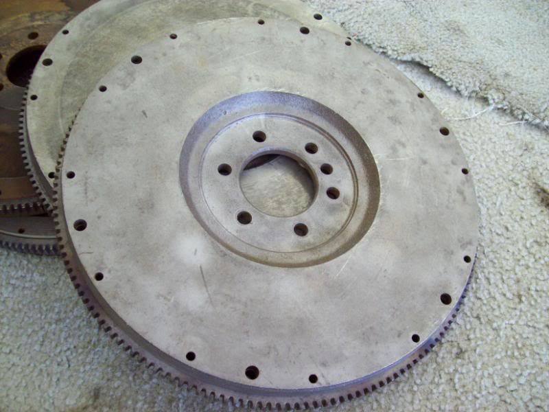

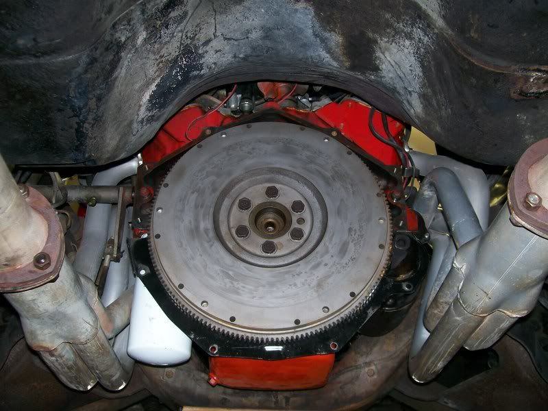

I'm 77, and everything I own has a Muncie, except the Cutlass which has a Richmond 5sp. I remove and install everything manually myself, BUUUUUUUUUUT, for the past few years, I have had to enlist a son or friend to raise and stab the transmission. I have found that jacks and other things just get in the way.
And I will agree, WHY THE HECK DIDN'T THE ENGINEERS DESIGN A REMOVABLE TRANSMISSION CROSS MEMBER??????????????????? The 53-62 models have a removable cross member and it makes life easier.
Regarding the ring gear on the flywheel---------------------AS MENTIONED, IT CAN BE FLIPPED OVER TOOOOOOOOOOOO EASY!
Once the flywheel is removed, the way I do it, is to use a soft drift (alum, brass, etc) and 3lb hammer and progressively walk around the ring gear, tapping it off a little at a time. Clean everything thoroughly. Place the ring gear in the wife's over (after it is clean) at 500deg for at least 30min (putting it in the oven heats it more evenly than a torch). Have the flywheel ready and quickly remove the ring gear from the oven, position it on the flywheel. It may and may not drop on all the way, so use the drift and hammer to tap it on until it is completely seated (BE SURE THE RING GEAR IS FLIPPED OVER TO THE FRESH SIDE OF THE TEETH!!!!!!!!!!!!!!). Now, you have a FREE, NEW ring gear!
Unless a flywheel has gouges, pits or scratches, I DO NOT, repeat, DO NOT have it surfaced. I put it in my Harbor Freight blast cabinet and thoroughly blast the surface for the disc. If it has heat spots, they come right out.
Here is the before and after blasting of the flywheel in our 70 Chevelle.

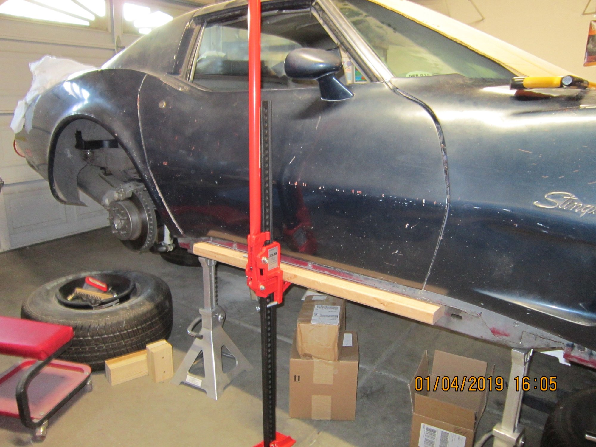

21" is a good height for under car maintenance. When I replaced my fuel lines I went to 26" and it's a little to high as I have to strain to bend up out of the creeper to reach many things. So 21" should be good as it gets for something like a clutch repair/replace. Now you can get some 4" blocks for the Quick Jack if more height is needed. I'll attach a pic of my body at 26" if that can help. BTW Home Depot has the QJ on sale now for $1,050 and that matches Costco pricing. I've been waiting for this QJ pricing but my garage is full and I'm trying to convince myself I can waite. Yes I have a low ceiling garage too.
I also worry about getting pinned under the car. Try to keep my cell phone with me when I dive under the car but sometimes I don't want to roll on it. If something happened no one would know it until the neighbors smelled something getting ripe. Not a glorious way to go. Take 2 for safety before diving under the car, verify your means of keeping the car off you (safety jacks) and your communications. I'd like to suggest Harbor Freight has some robust looking transmission jacks that I'm interested in. Much better than the previous floor jack add on trans holders they used to sell. The old floor jack adapters I found were pretty much junk and I was glad to get rid of mine at a swapmeet. The HF entry level jack is a small scissors jack that should fit a muncie/borg warner just right. And then for more money the HF trans jacks get better. It could make the difference between a physical battle with the trans and making it fun to remove and replace.
So FYI when I did my fuel lines I had to learn bendology to get those lines in and fastened down. The way I did it lifting the body one side at a time and only 26" is not the the way to do it. Lifting the body fully off is the way to do it period. I looked my brake lines over and decided their still in good enough condition but realized the brake lines are even more difficult and wouldn't try it just lifting one side at a time like I did my fuel lines. Just my suggestion unless those steel brakes line show nasty corrosion then leave them alone or at least until your ready to lift the entire body fully off.
Hope this will help ya.
Farm jack in place.

What kind of jack is that? It looks like the old bumper jacks. Is there a long arm that extends under the frame and body? It definitely takes it up higher than any hydraulic floor jack could. Thanks for the tip about the Home Depot sale pricing on the Quickjack.
Old Nov 9, 2020 | 02:32 PM
cardo0's Avatar
cardo0
Joined: Oct 2002
Posts: 7,098
Likes: 378
From: Las Vegas - Just stop perpetuating myths please.
Thats a farm jack. You mostly see them on off roaders. They are a little tricky to use and the arm extends only like 4" (note the 2x4 in the pic). If your not careful when racking it down and it becomes unloaded it just drops all the way.
If you expect to buy one I will wait for your opinion on the QuickJack before purchasing then.
