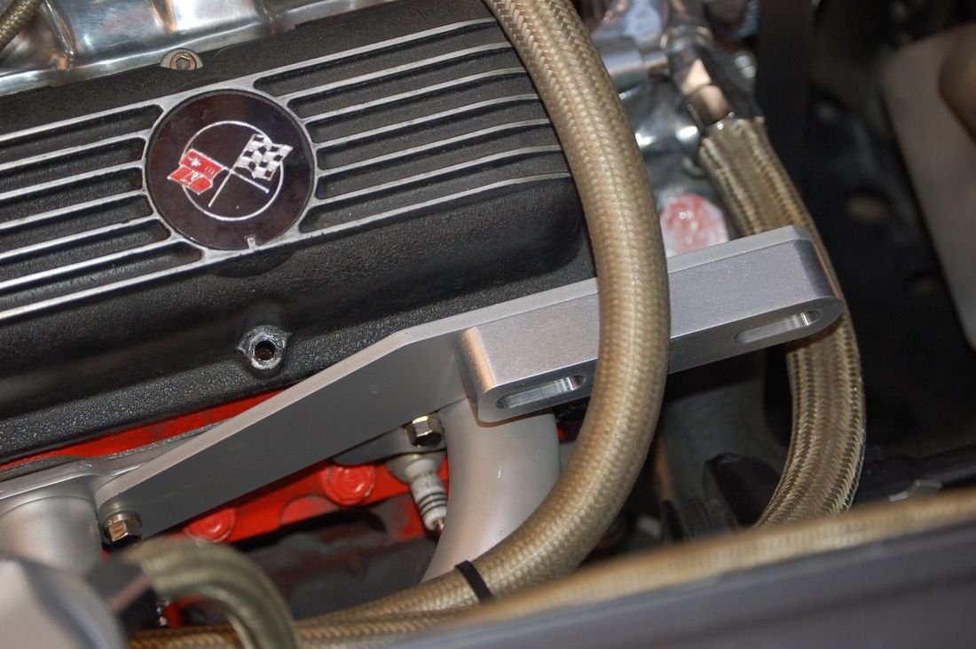

Originally Posted by silver 64 coupe
Do you by chance remember the model number on the Doug Thorley headers?
The stainless set is super clean. My question to the owner is about ground clearance? They appear in the second picture to be below the pan.
That's how my last set ended.
No, but they were ~1987 and designed for the '63-'67 Corvette. They were originally chrome. I had them de-chromed and ceramic-coated years later.
Note, how good a job they did using the thickest flanges (full 1/4") and thick-walled tubing of the day, and no ugly exposed welds to get in the way of the Header Power Bracket.
