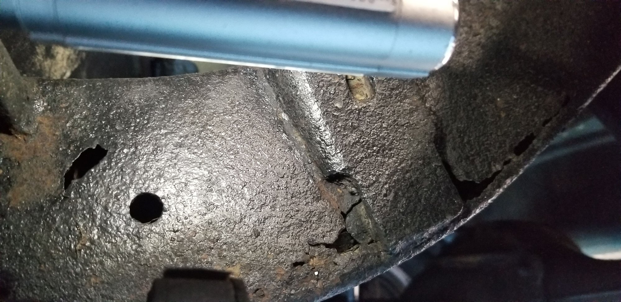

Bad rust is a deal breaker for me. There are just so many more cars out there for sale to choose from to bother with this. Here is a picture of a spot on a C1 that I inspected a while back. You can imagine how bad the rest of the frame was after seeing this bad area from just looking in the wheel well area. This car is not from anywhere near the "rust belt". The body on the car was unhit. The paint,top and chrome was freshly restored to a great finish. The interior with the exception of the carpet was original and in excellent condition. But at the end of the day it is just not worth work/money to bother with the car.
