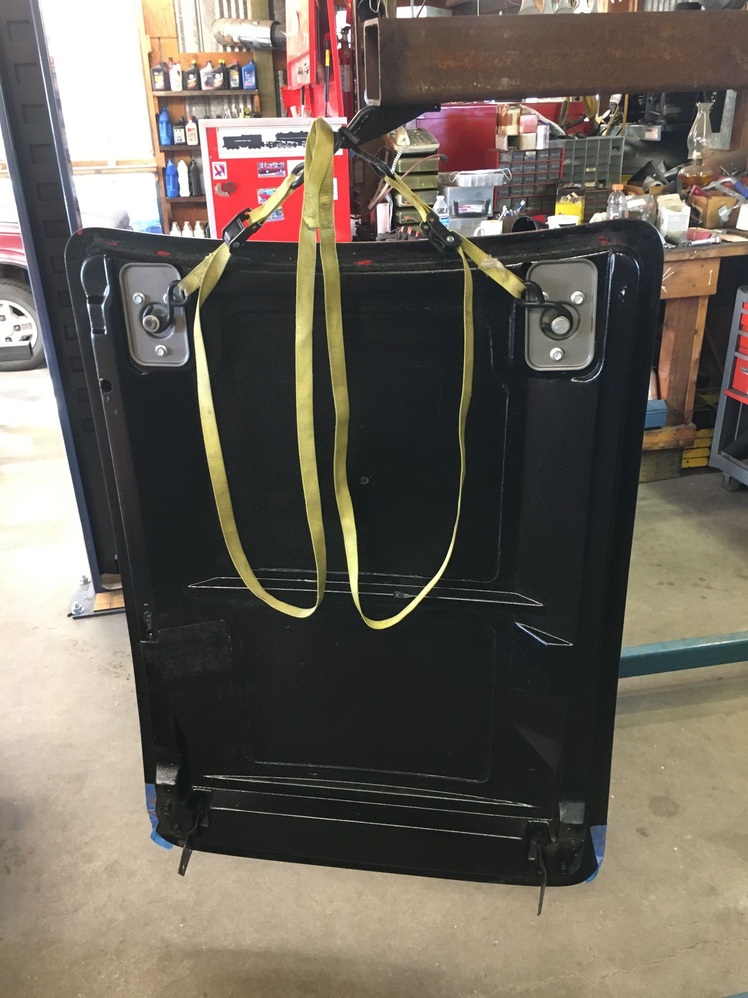

I pull the hood with my engine hoist. The hood will go vertical with the support unbolted and lift straight up. I tape all the edges but with two people it never hit an edge.

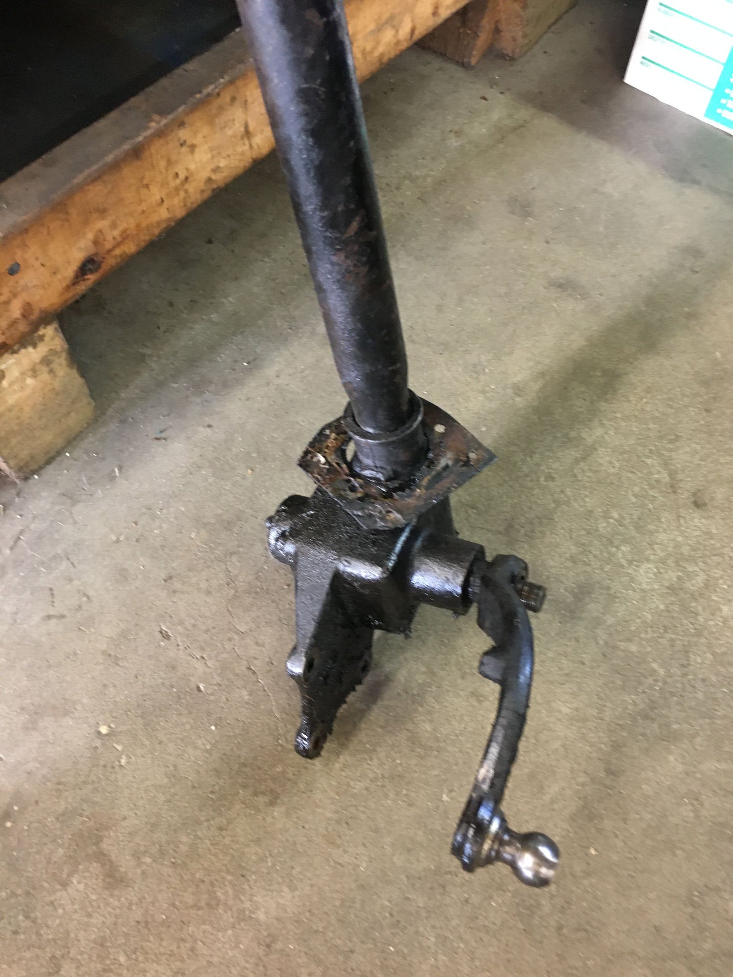

I bagged and removed the steering column after removing the driver side exhaust manifold.
It came out quite easily with my monster son doing the work.

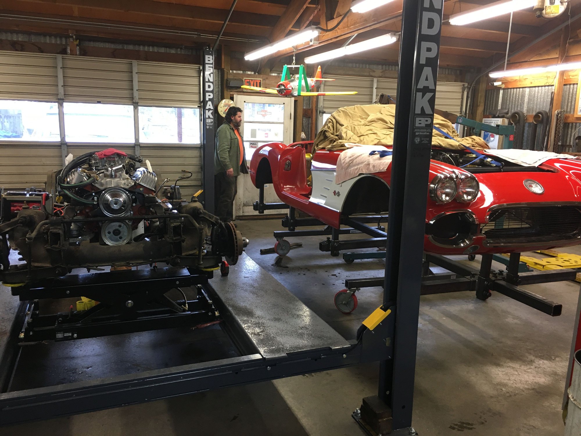

This is my Auto Twirler body dolly that I set up as per the frame spec drawings. This is a test fit on the lift for getting the body way up later for underneath work. Rocker panel metals etc.
Earlier picture on four post lift with suspension on two rolling jacks. Doors, trunk lid, deck lid, hood, seats, radiator, bumpers all removed.

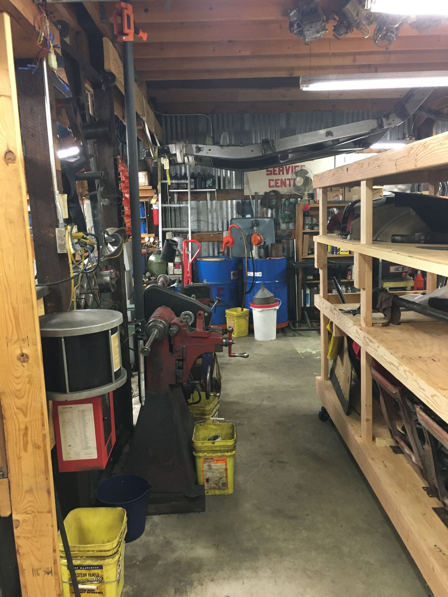

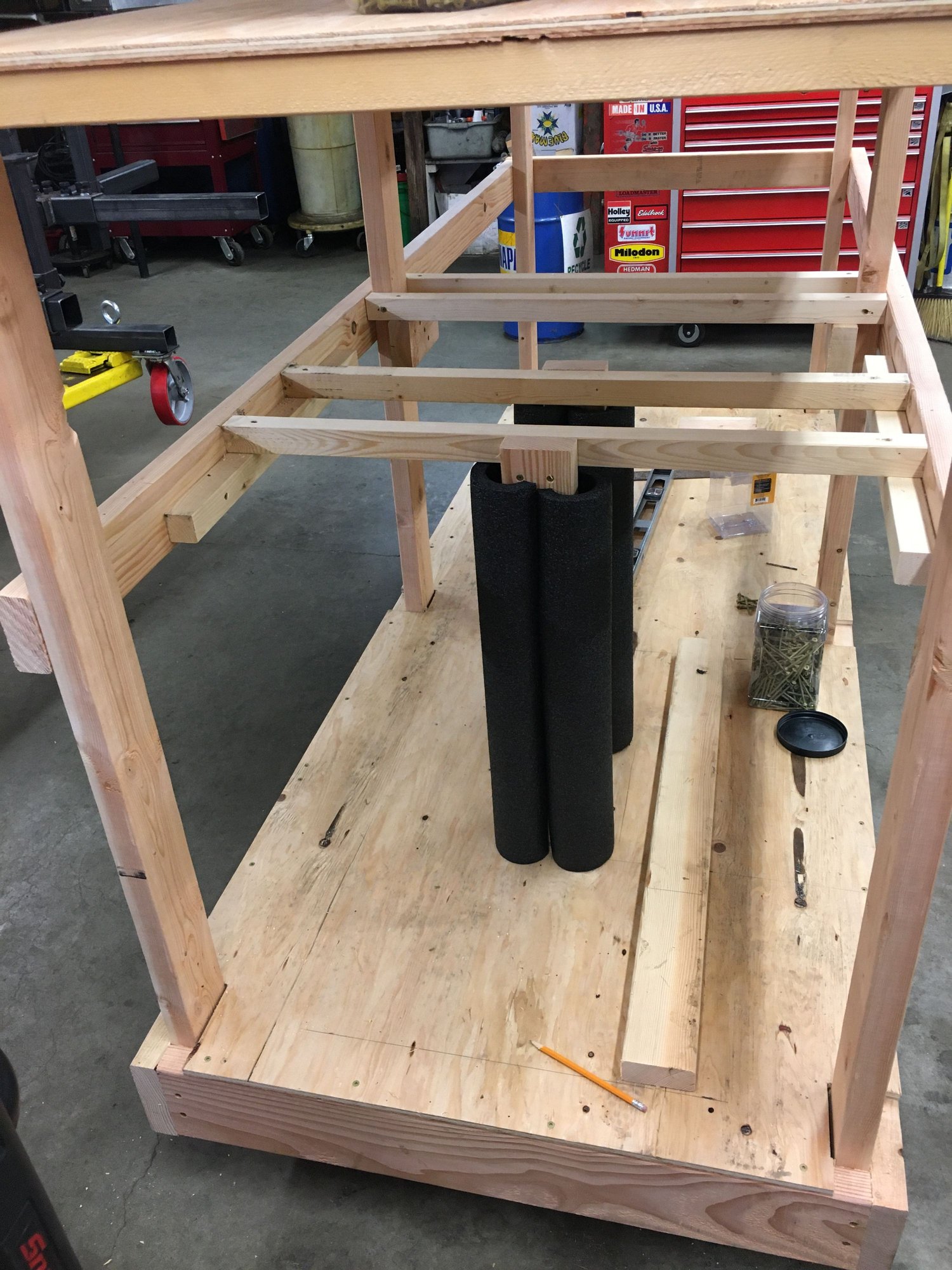

I built an 8 foot long four level cart to store a lot of the parts in one place. it is custom built to house the doors. The hood, trunk, and deck lid are all in another dry building safe from damage.

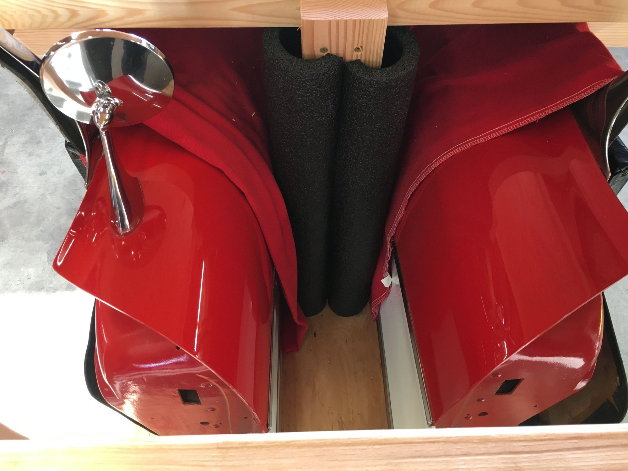

Doors are safe.

I rolled it into the other section of the shop for storage when ready to lift the body. You can see the new frame hanging in the background.

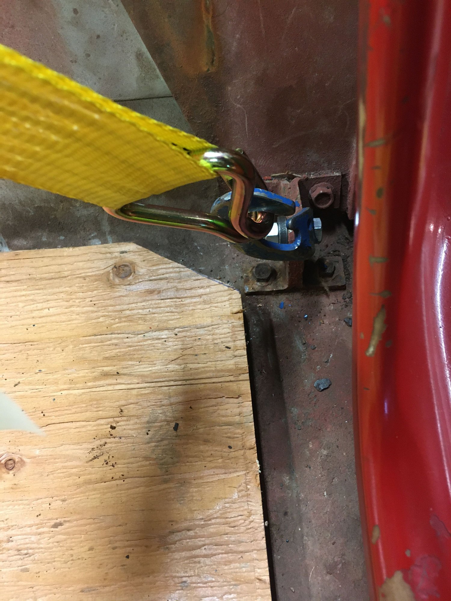

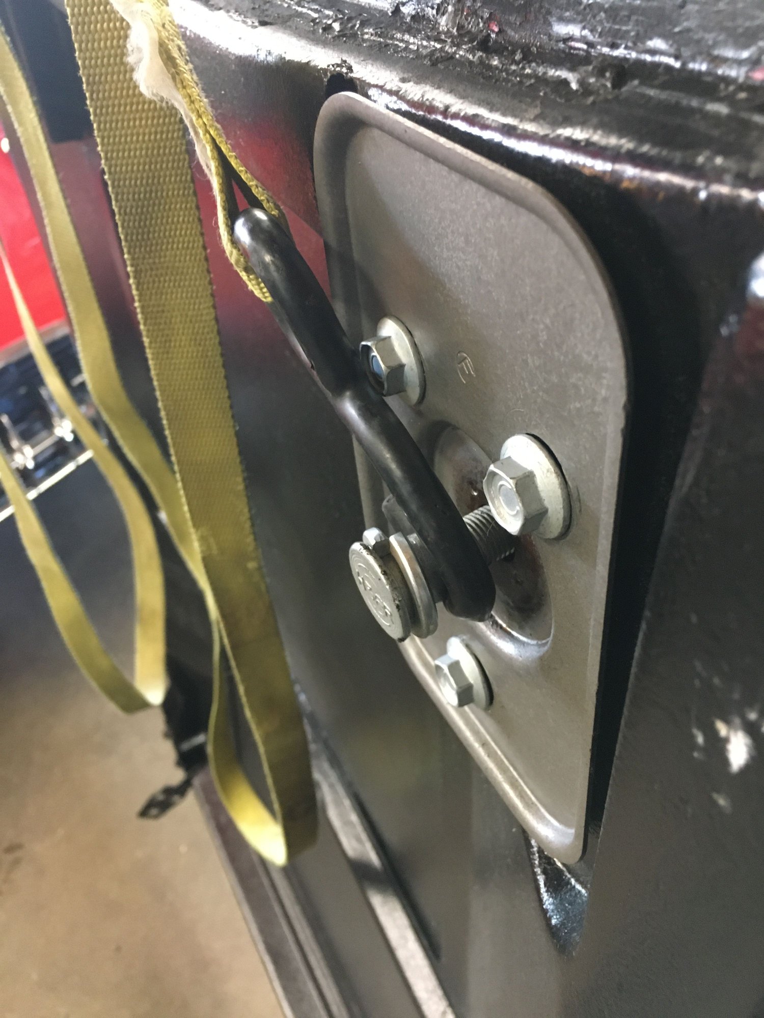

Lifting hooks bolted to the seat belt bracket, witch is solid underneath I don't know why.
Left lower hinge.

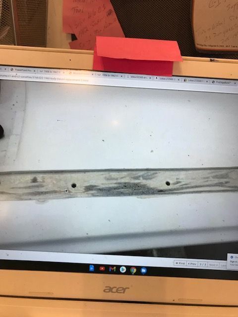

Fiberglass is layered so I cut out a strip above rivets, all holes lined up fine on panel I got.
Here are some pics of the pics from my file. Also smeared bonding glue on it.
