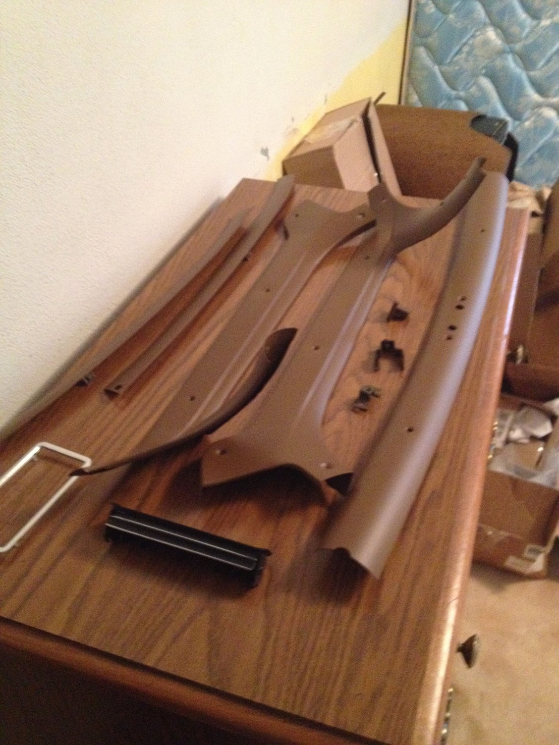

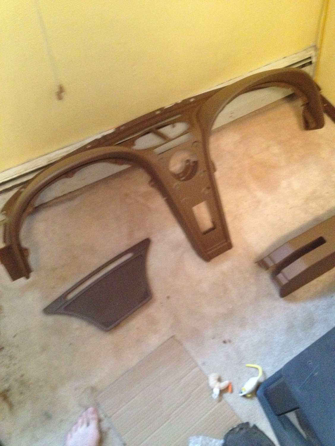

like everything prep is key. I would lightly scuff each part use a good cleaner, and then use a self etching primer and give it a go. I have used both the rattle can and quart paint from CA

Tom I have used CA dye on metal with successes
I used it on my hard top metal trim 15 years ago and it still looks new.

I used it on the metal trim pieces for the kick strips and cleared it with eastwood satin clear and looks perfect
