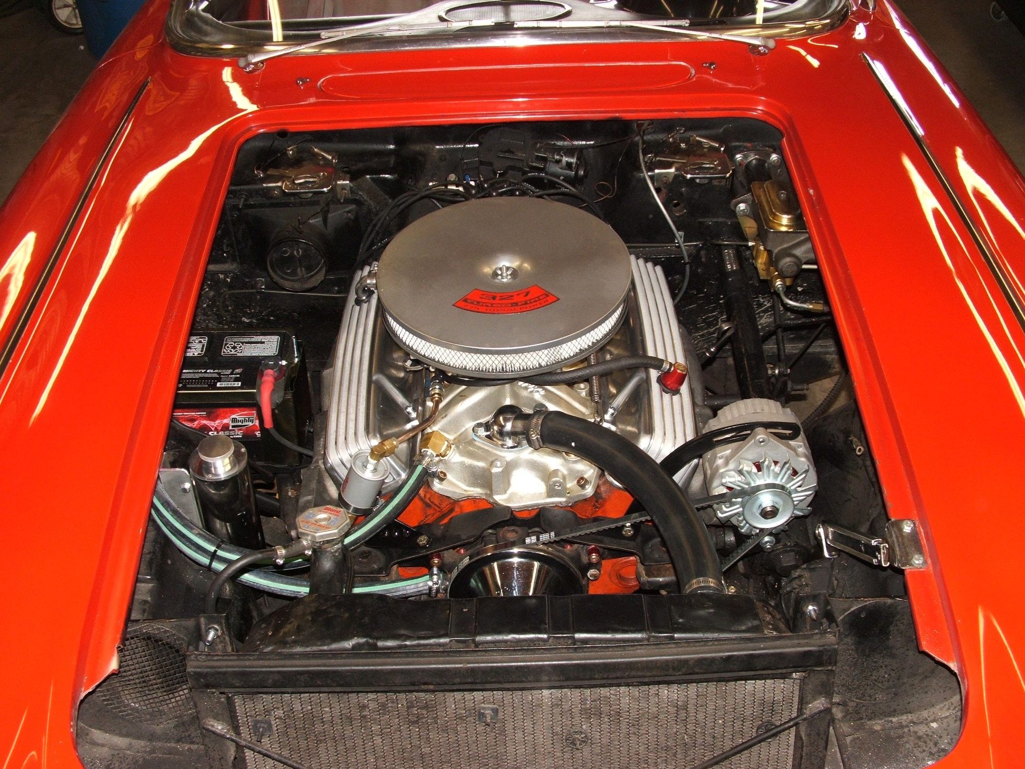

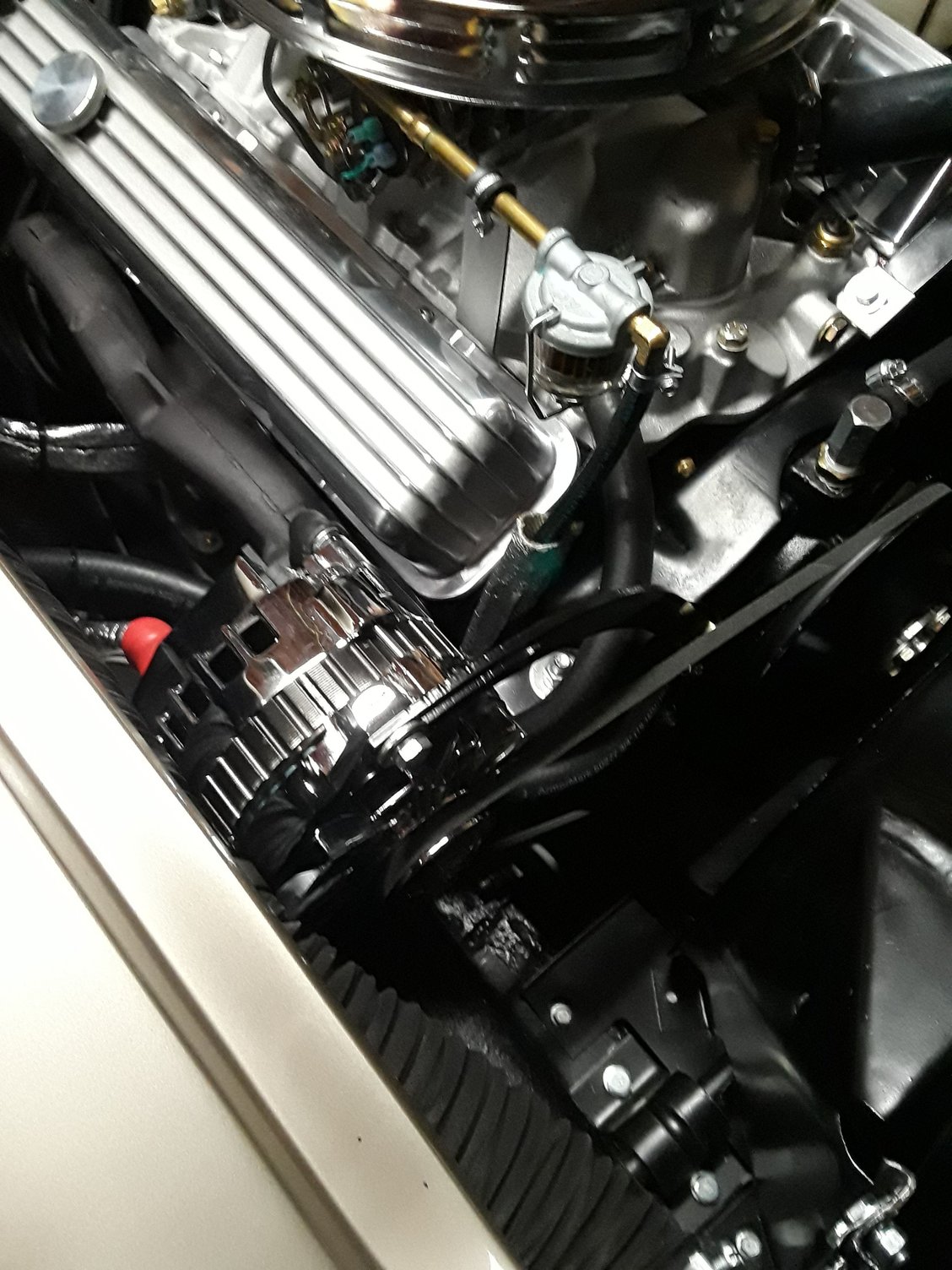

I am sure there are several ways to do it. This is how my mechanic chose to do it on my 57 with Dorman repo 2 1/2” manifolds.Note the twisted steel strap bracket at the back the gives added strength.The rest of it was the original generator bracket.

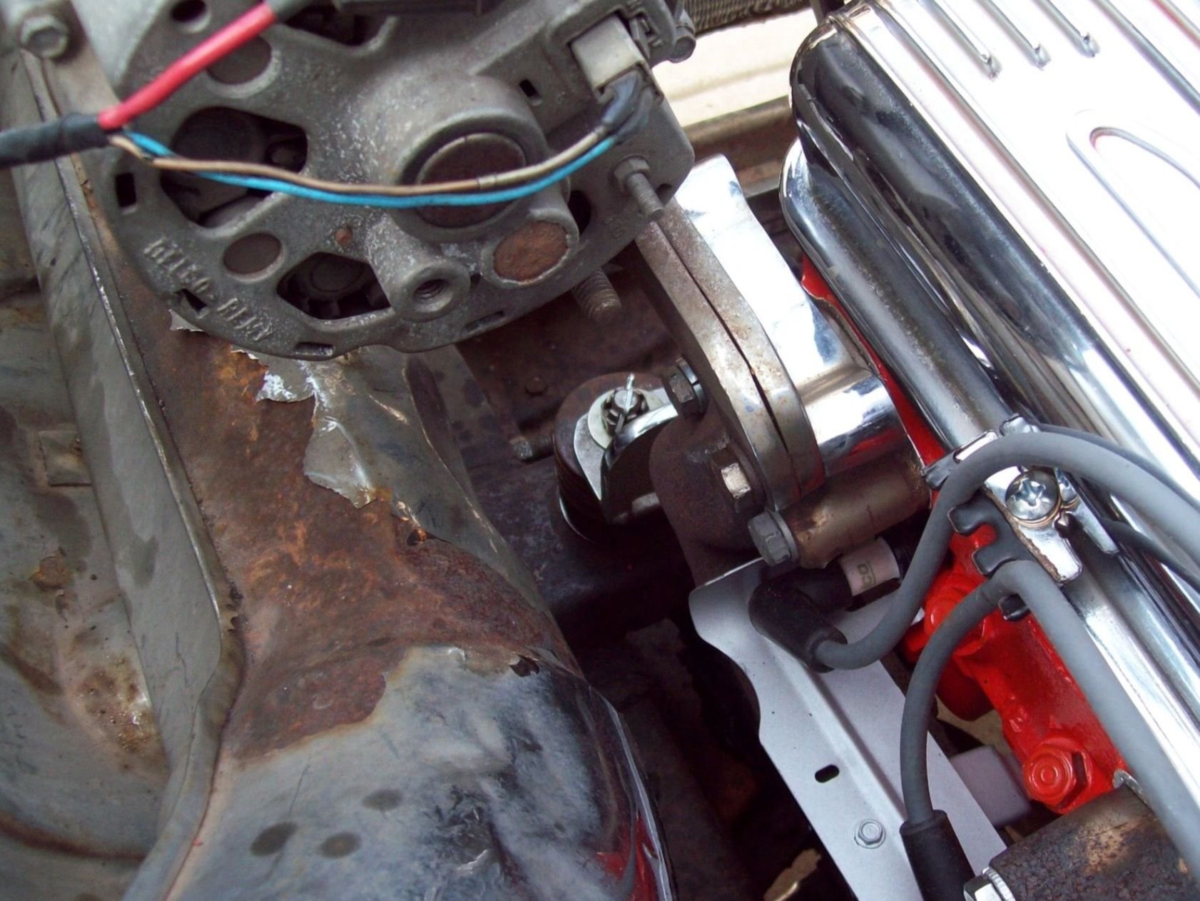

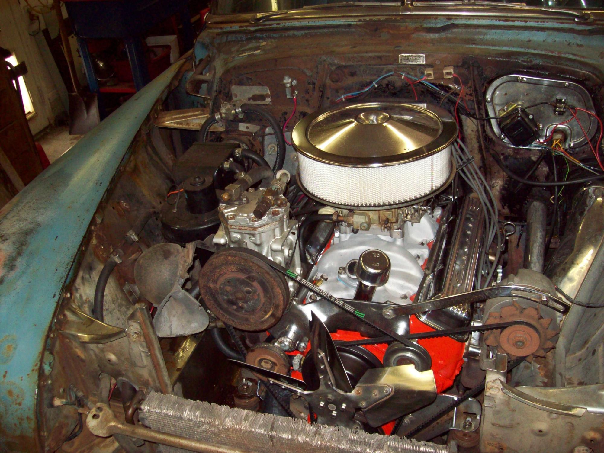

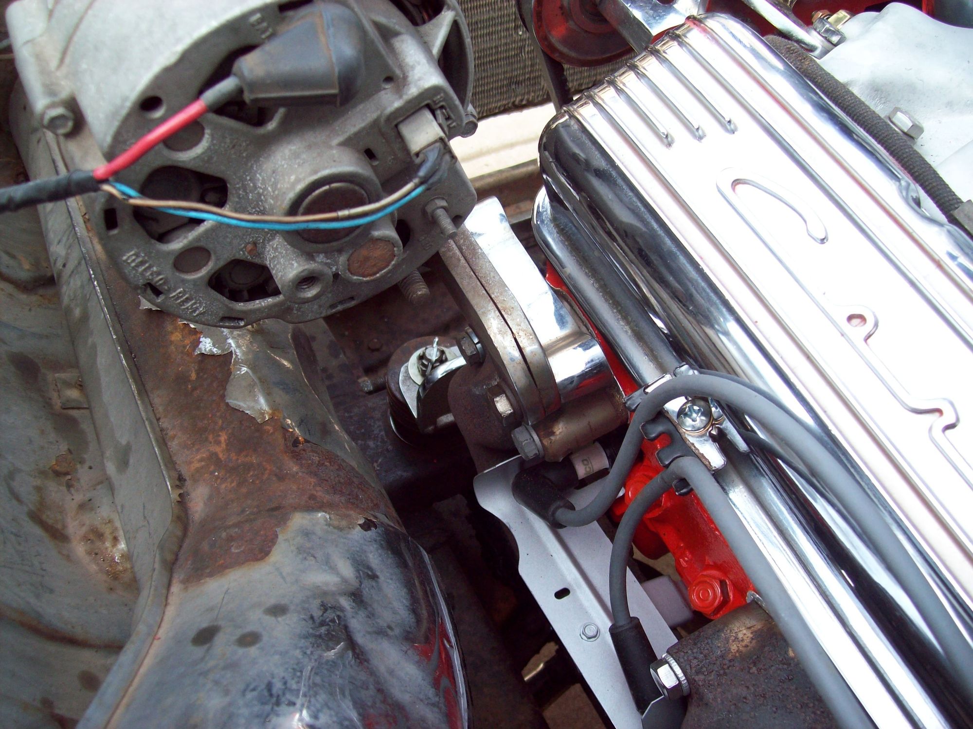

Remove the generator mount bracket (either left or right).
Bolt on an alternator mount bracket (either left or right) where the gen bracket once was installed.
Attach the alternator to the alternator mount bracket.
Connect the wiring as needed (3-wire, 1-wire, whatever you have).
Done, too easy.

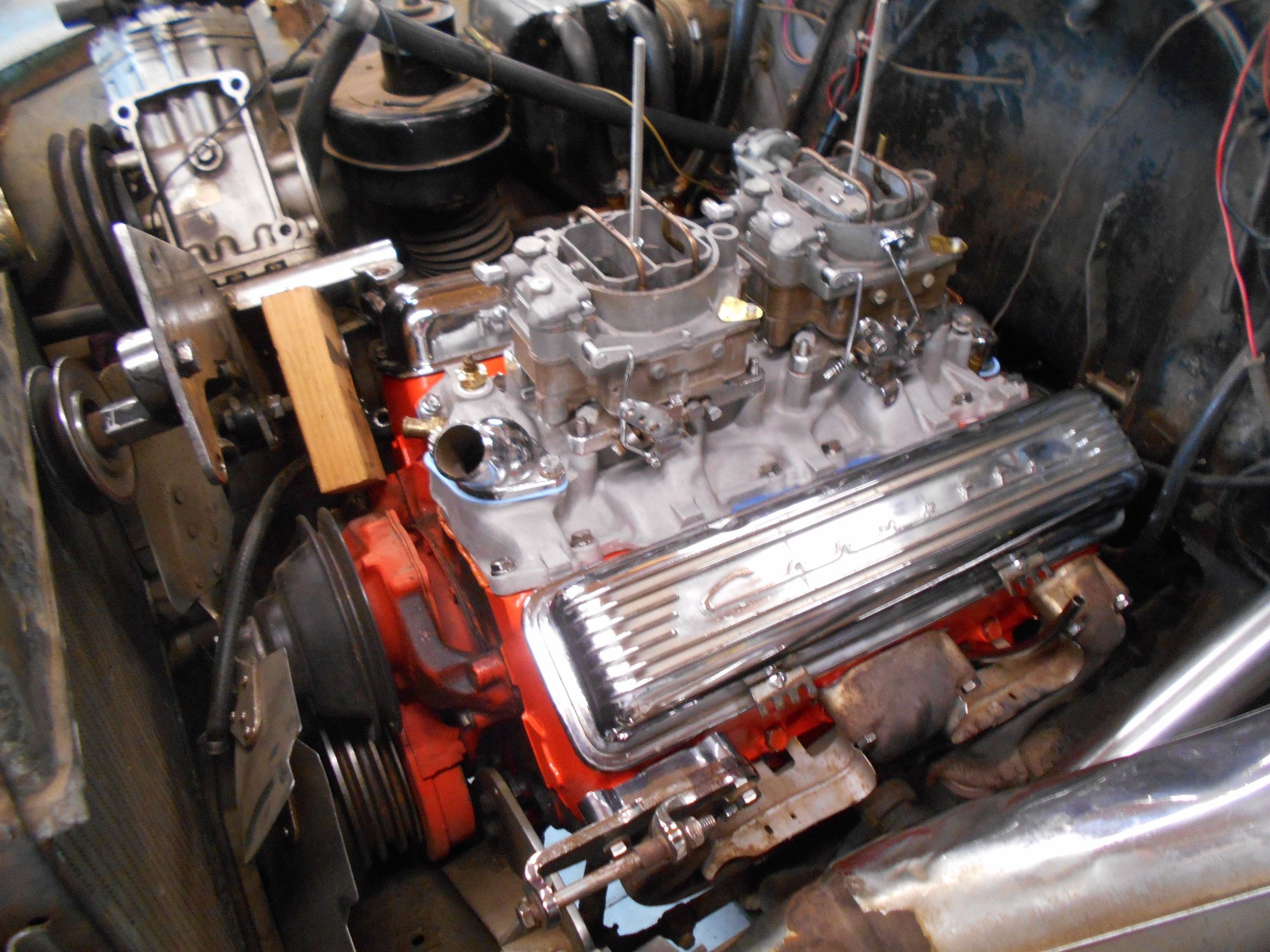

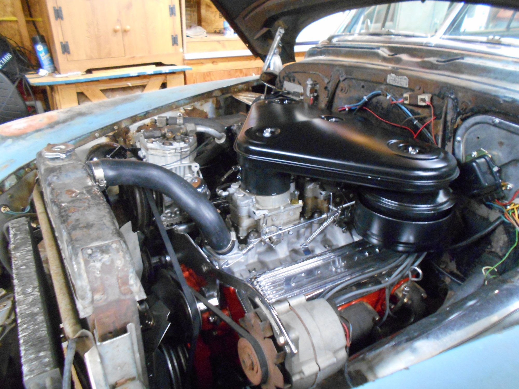

This is NOT a Corvette, BUT, it is a small block with a small block exhaust manifold and an alternator mounted to a left side alternator bracket on a left side manifold. Been that way on my 51 Chevy for over 50yrs.

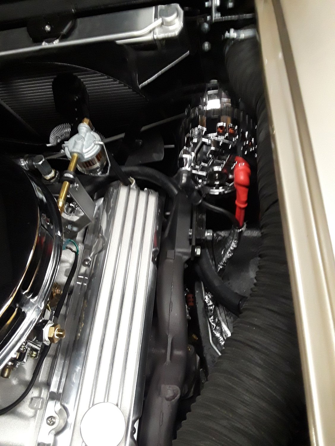

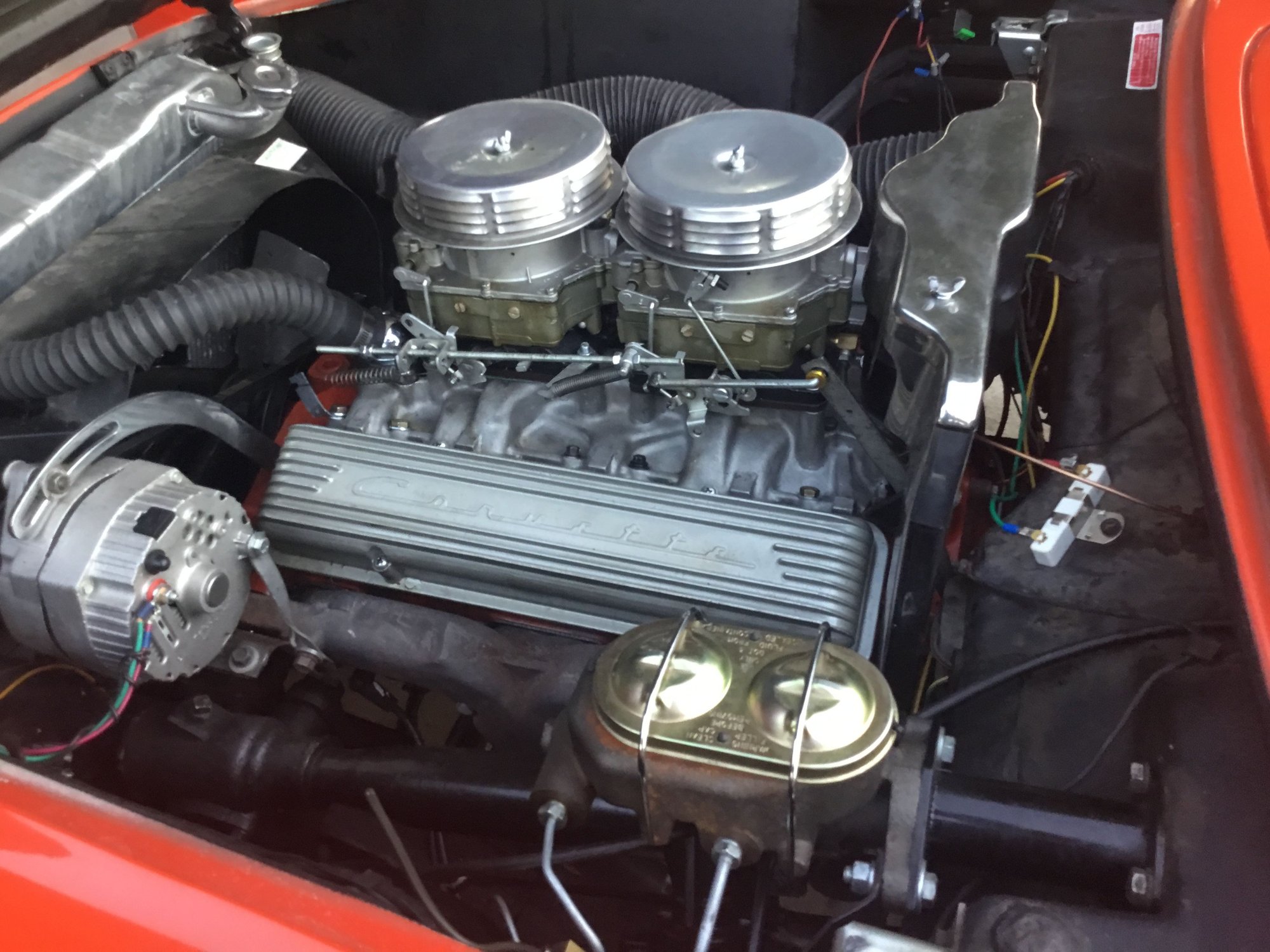

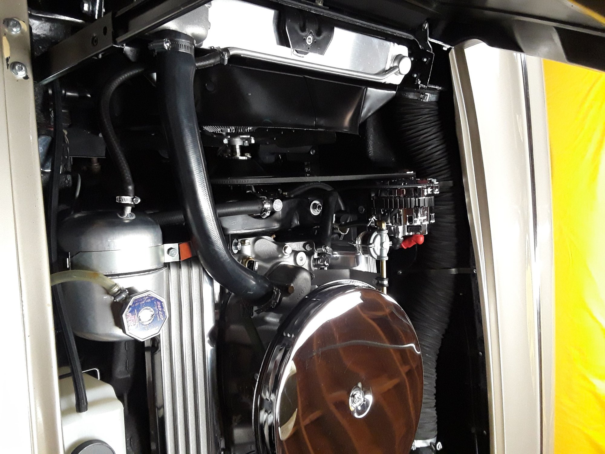

Default Here's what I did.
Works very well. Generator couldn't keep the battery charged with the aftermarket stereo I installed

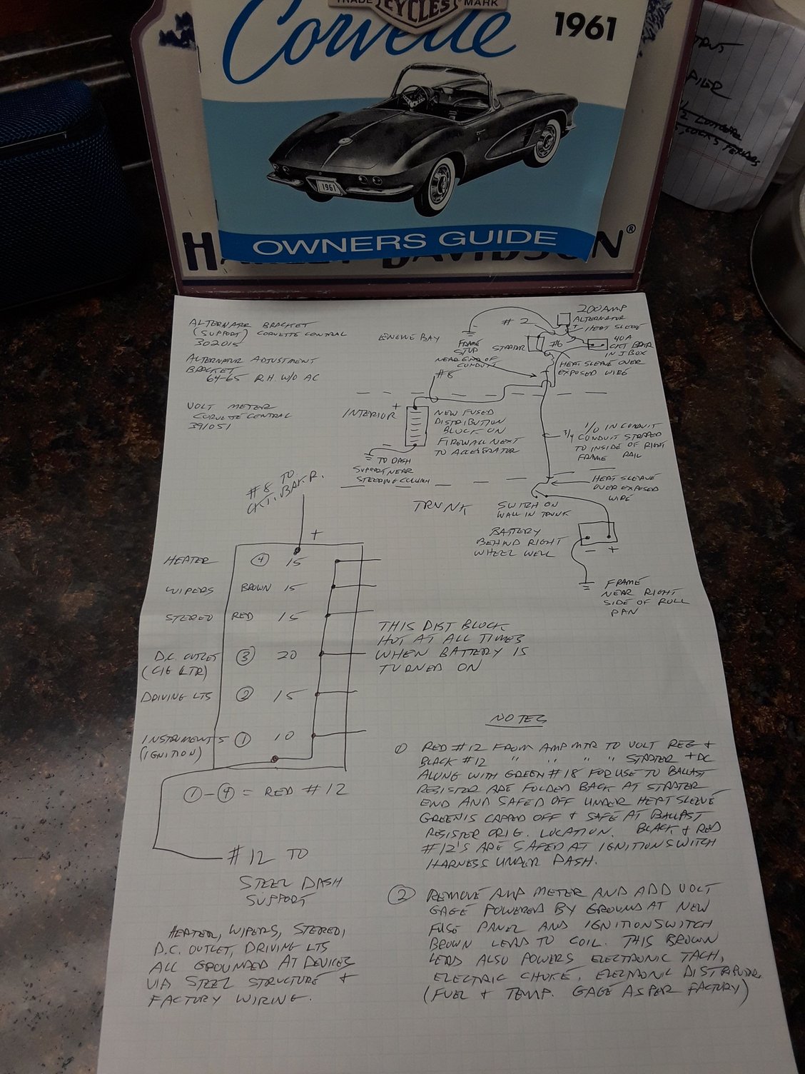

kinabub, you might want to consider changing the amp gauge in the car to a volt meter and run the wiring that went thru the amp gauge thru a terminal block. An alternator puts out alot more than your old generator and you really don't want all that juice running thru your amp gauge. Search the archives on this topic and check out www.madelectrical.com for one wire vs 3 wire alternator.

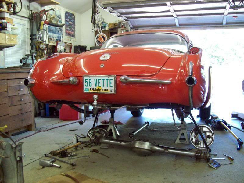

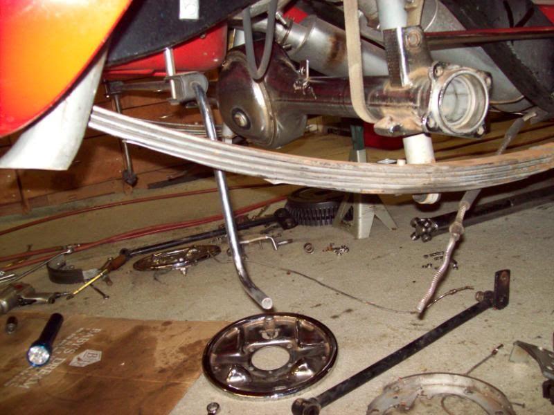

When I was in college, I worked at a chrome shop.
I chromed LOTS of parts on the 51 Chevy, including exhaust manifolds. The heat was not kind to them.
After college, I was still very good friends with the owner of the chrome shop. He would let me come down at night after closing and chrome my own parts.
I bought the 56 in 73 and did the equivalent of a frame off. ALMOST everything that I removed got chromed. Front cross member, suspension, steering parts, rear axle housing and related parts, etc, etc, etc. I even disassembled the soft top assembly and chromed those parts.
WHAT A MISTAKE!!!!!!!!!!!!!!!!!!!!!!!!!!!!!
In 2010, I attended the SACC Natls in Bowling Green. I power washed the underside, then put the 56 up on stands and disassembled almost everything on the underside and polished EACH AND EVERY PART.
When I left home, by the time I got to the east side of Okla City---------------------------IT RAINED ALL THE WAY TO THE FRONT DOOR OF THE HOLIDAY INN!!!!! What a mess!
All back together and ready to leave.

Thanks Capt’n. I am changing to a volt meter vs amp gauge
