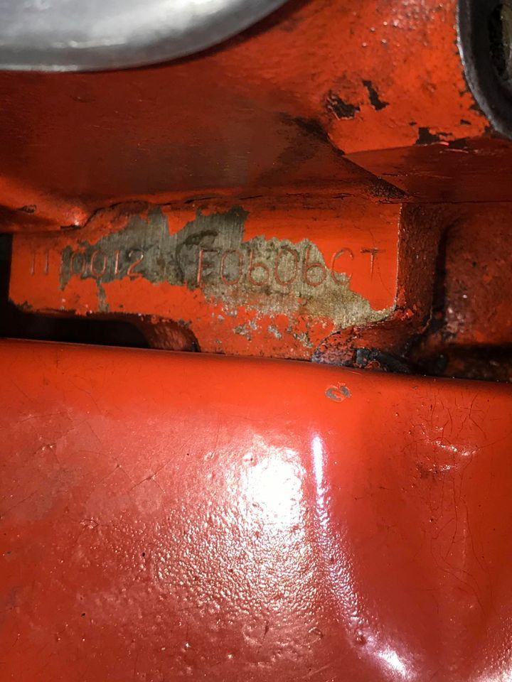

Anyone want to take a whack at this engine block date code?

Here is the pad stamping

Heres something else...I cannot find out what the engine code would have been for a 61 283 245hp with 4spd
