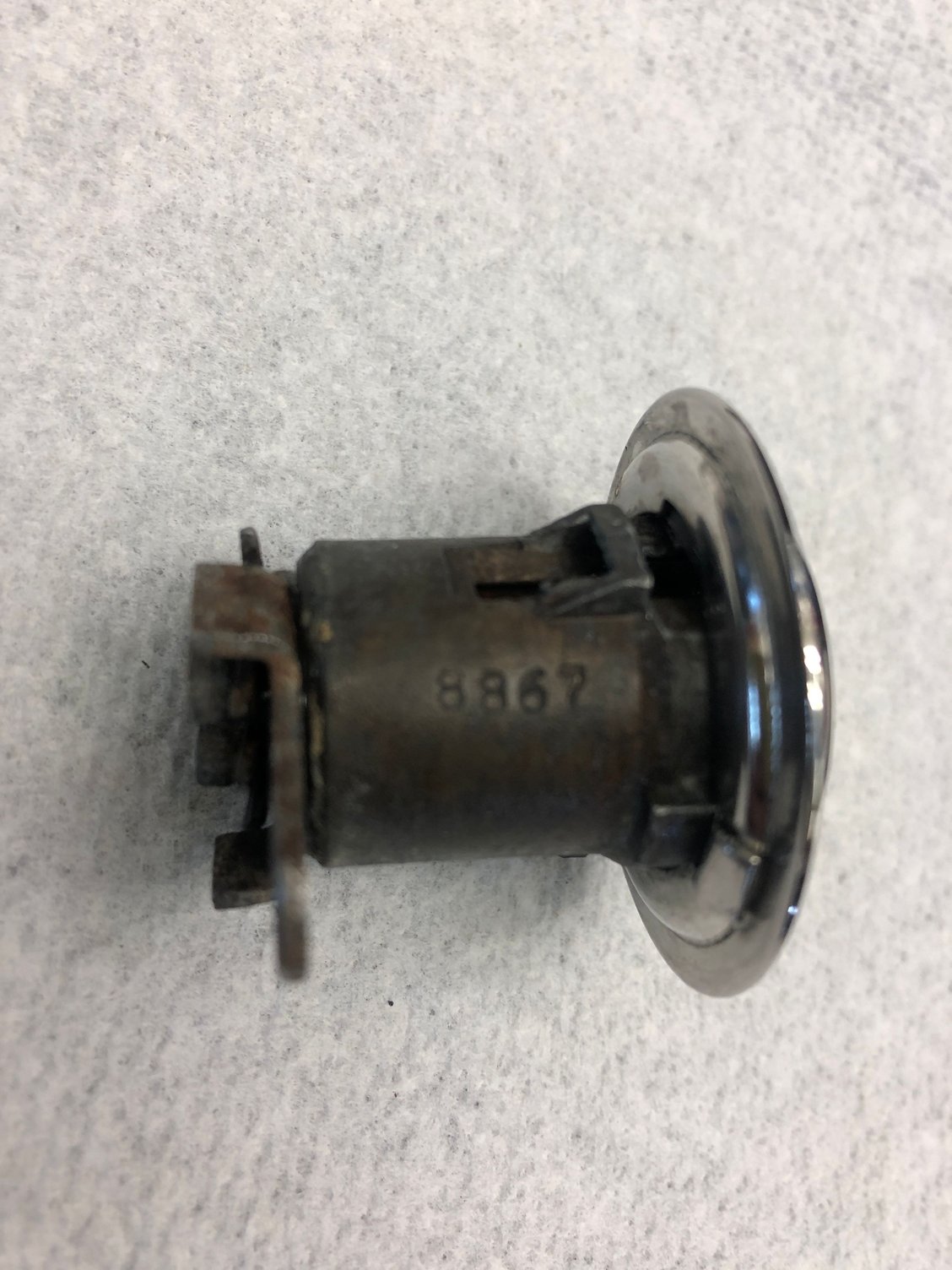

Tony, I am working on freshening up just about everything in the passenger door of my 65 Roadster and believe the stamped 4-digit codes are on all the lock cylinders. Here's a pic of my passenger side door lock.
Mike T - Prescott AZ
Thanks Mike, I actually found my door lock codes codes using an endoscope I picked up on Amazon, very useful, was able to slide down window opening without removing door panel.

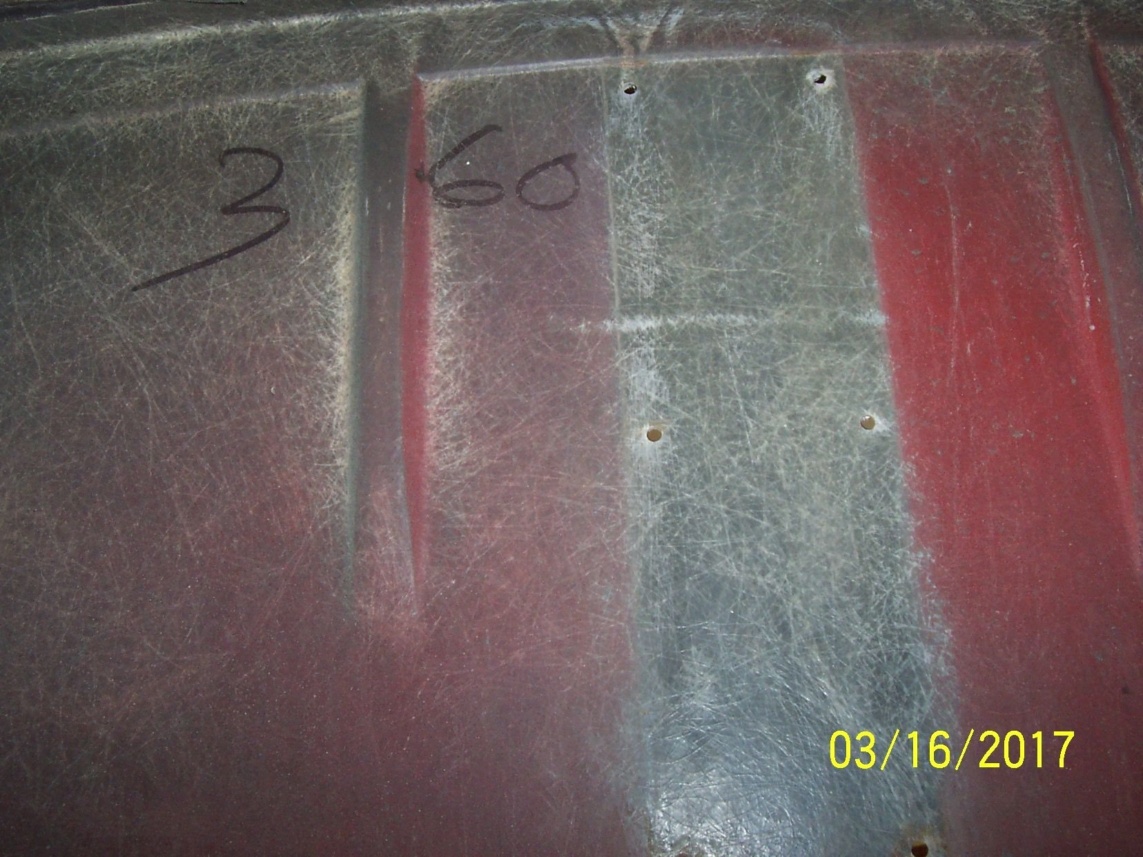

If you have a A O Smith car the key code is written on the bird cage cross bar behind the dash. Take that to a old lock smith and have a key made
So what is my key number? 64 AOS, job #360
I seem to recall John Hinkley saying AOS used a “body number” shown here and the job number.
