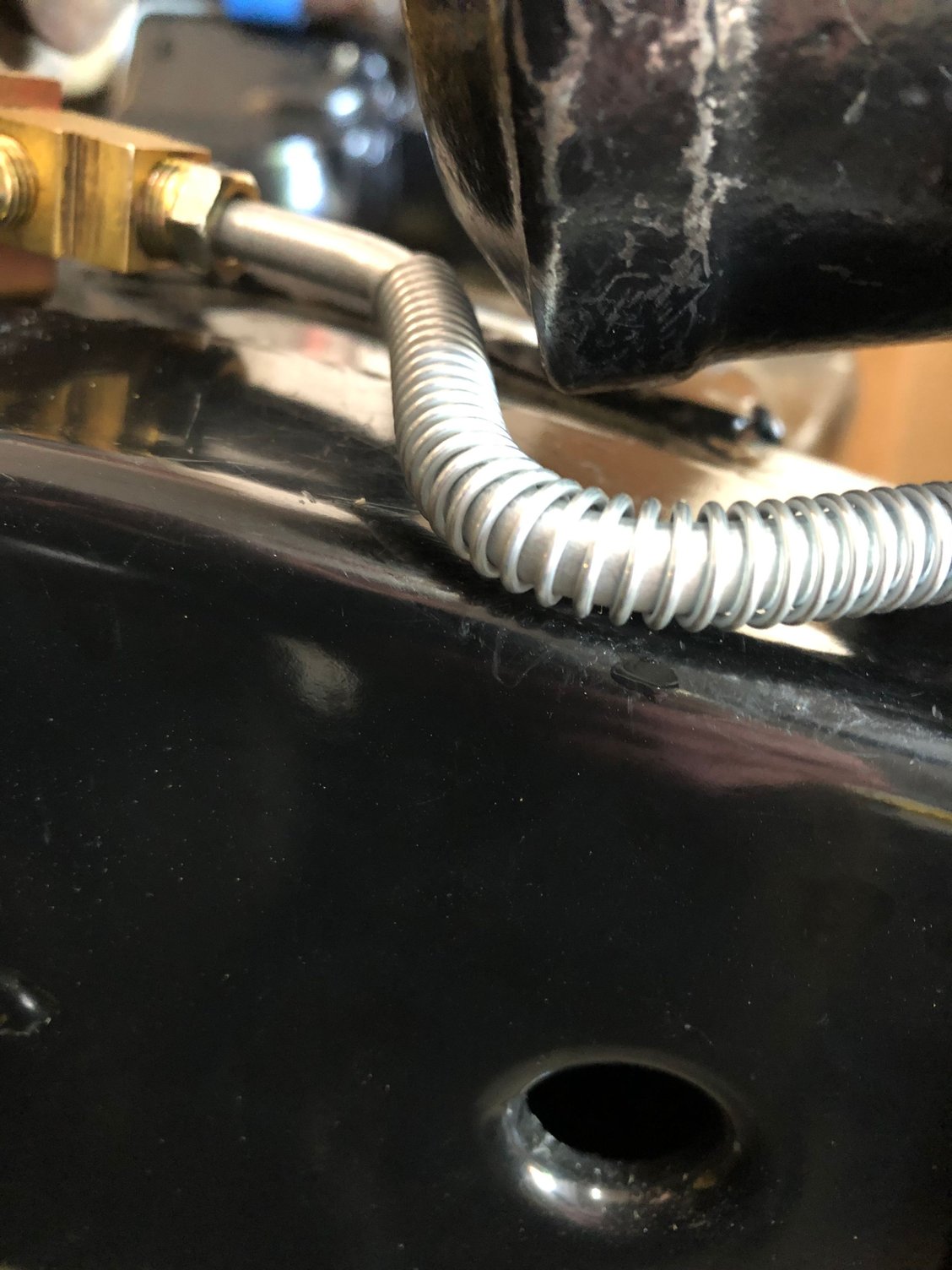

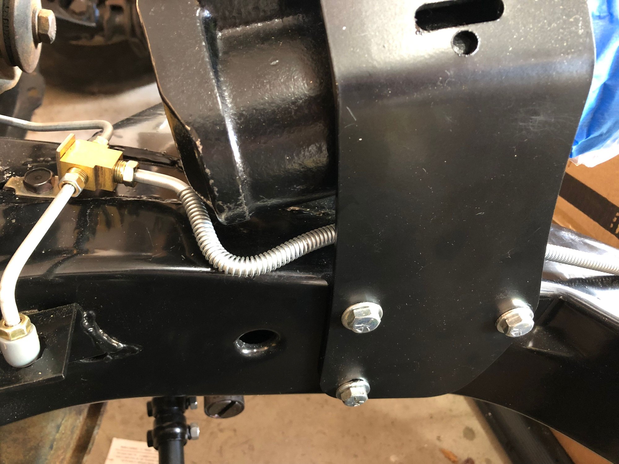

Trying to install borgeson steering box on my 67 small block the brake line interferes with the corner of the steering box. Has anyone had this problem with a c2? I could cut 1/2 in off flared end and re-flare but I can’t do a double inverted flare. Would a regular flare work with the brass divider fitting? I got the brake line from corvette central in 1994

I ran into that. I ended up making a new line and bought the double flare bits for my flaring tool. They weren’t that expensive. I would have liked to put the bend closer to the brass block but needed the room for my bender and flare tool.

There should be enough slack in the brake line to use your hands to bend it enough for clearance and still look like a proper workmanship install.

I was able to bend mine enough by hand to clear.

It will work fine right up to the time when the brake line SPLITS OPEN.
Always double flare brake lines! There are no exceptions.
