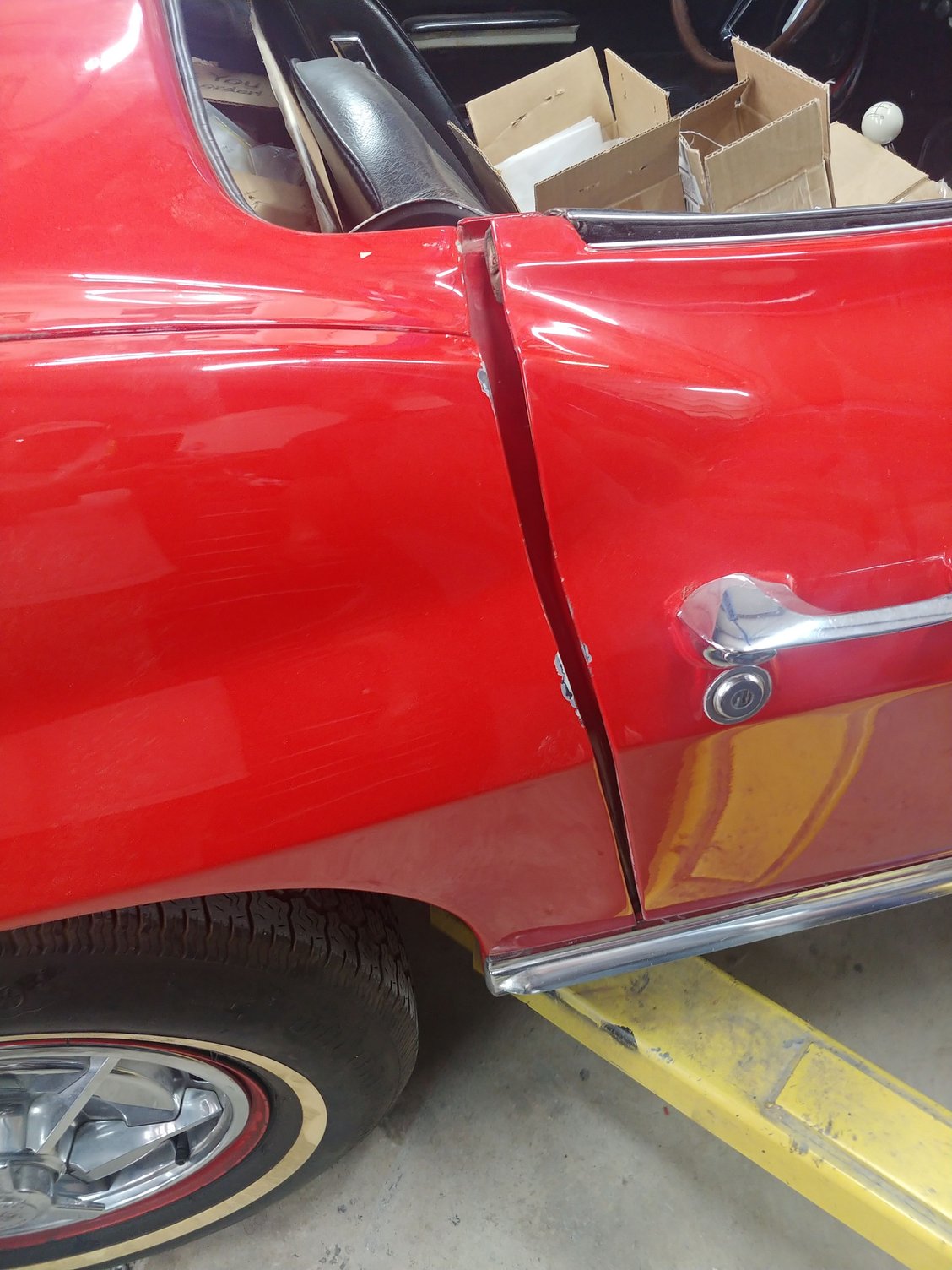

The owner was complaining about the door was becoming difficult to open and paint chipping around the edges.
The frame is rotted.
You think the bird cage is in jeopardy?

Door gap may be the least of his problems. I suspect there is a problem with the "bones" of that car.
Old Jun 9, 2021 | 10:29 PM
65 Pro Vette's Avatar
65 Pro Vette
Joined: Aug 2006
Posts: 3,881
Likes: 1,283
From: Horsham Pa
C2 of Year Finalist (appearance mods) 2019
It looks to me as though there’s a lift under that car. If you put a convertible midyear on a lift with no convertible top or hardtop on it that door gap will open up just like that on every one of them.

Get us a photo of the car sitting on the ground, not while suspended on the lift. That will show your true door gaps.

I agree with those recommending a close look at the frame. To have that wide a gap on a hoist and for the body to flex otherwise to where the gap goes away and there is contact - well, something not normal is going on there.

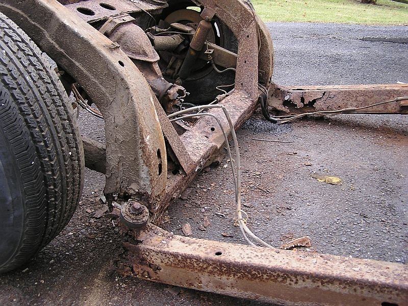

With the extreme gap showing there, I would be very concerned about the frame and the potential for something like shown below......hopefully we are wrong and its not something catastrophic.

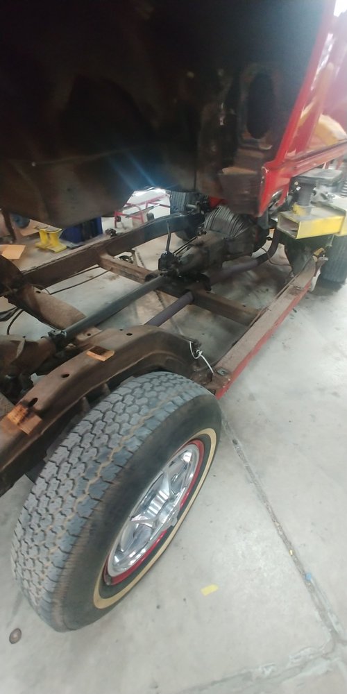

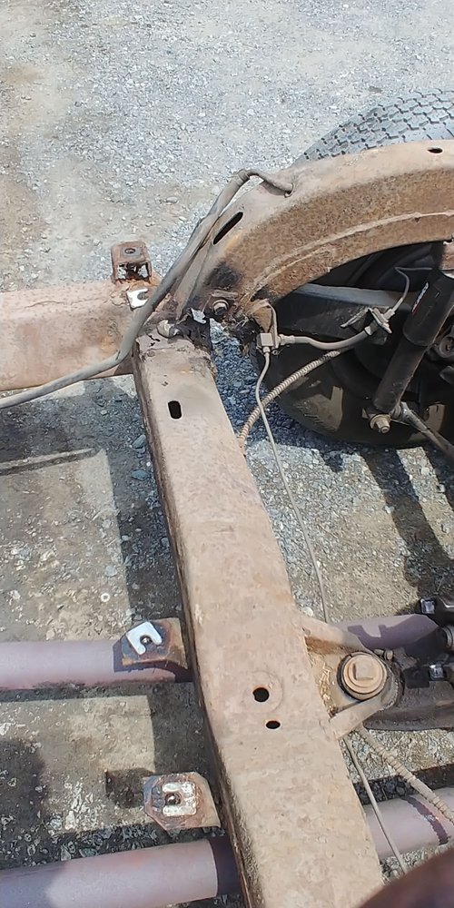

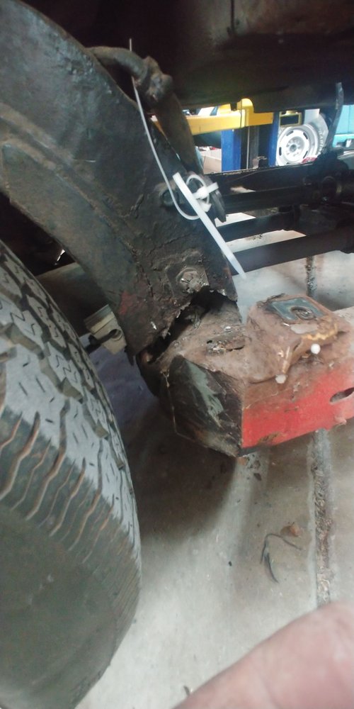

The kickups have disintegrated. There are other areas that make this frame unrepairable.
I'm running a camera into the door jam areas to view the rear uprights.

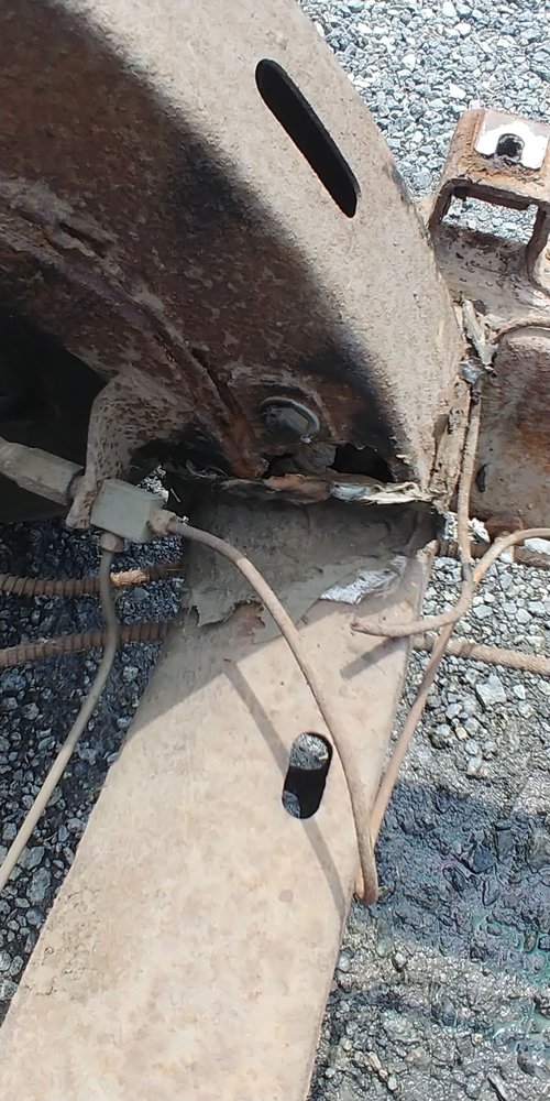

My original question was if you think the bird cage is in jeopardy.
Thanks DansYellow66 for getting to the point. There is still some camera work to be accomplished in the door lock area.
Please note the fibreglass coverup on the inside of the left kickup. And the blob of JB weld on the right side.

That's going to need a lot of JB Weld. I believe that it comes in 55 gal drums.

Boy, that’s scary. For that car to still have been in one piece, I’m going to venture to say the birdcage is still sound - just hope it hasn’t been tweaked out of dimension from the lack of frame support.

about a weeks worth of plating and gusseting should fix that right up
