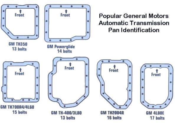

Your stampings don't seem to fit those associated with p/glide transmissions - perhaps you have recently acquired this vehicle? Is it possible that your car was outfitted ('upgraded') with TH350 3-speed transmission, not the OEM 2-speed powerglide? If so, then your pan stamping numbers make sense and decode as follows:
Y = Toledo (TH350) 5 = 1975 ('85?) H = June 24 = 24th day N = night shift
Pan differences shown below. Note that only p/glide has 14 machine screws for pan attachment.

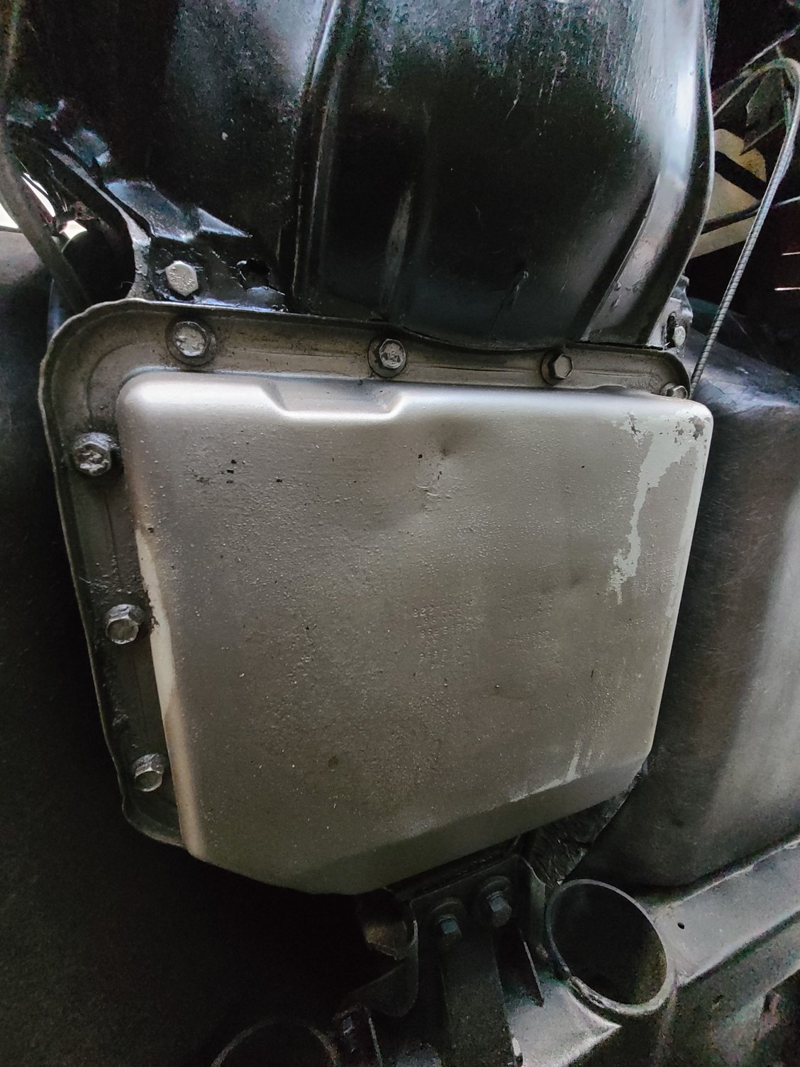

Here's a photo of the side of my pan.

With the above diagrams of GM trans which one do you have
Old Jun 23, 2021 | 05:53 PM
sgorman3's Avatar
sgorman3
Joined: Nov 2009
Posts: 529
Likes: 19
I have the 14 bolt powerglide

Likes: 19
Here's a pic of it.
Old Jun 23, 2021 | 05:56 PM
sgorman3's Avatar
sgorman3
Joined: Nov 2009
Posts: 529
Likes: 19
Here's a pic of it.
Old Jun 23, 2021 | 06:02 PM
Nowhere Man's Avatar
Nowhere Man
Joined: Feb 2003
Posts: 54,123
Likes: 9,437
2015 C2 of Year Finalist
That would decode to August 24 1965. So the pan is not original to your car. But there is no id marks on the trans it self.
