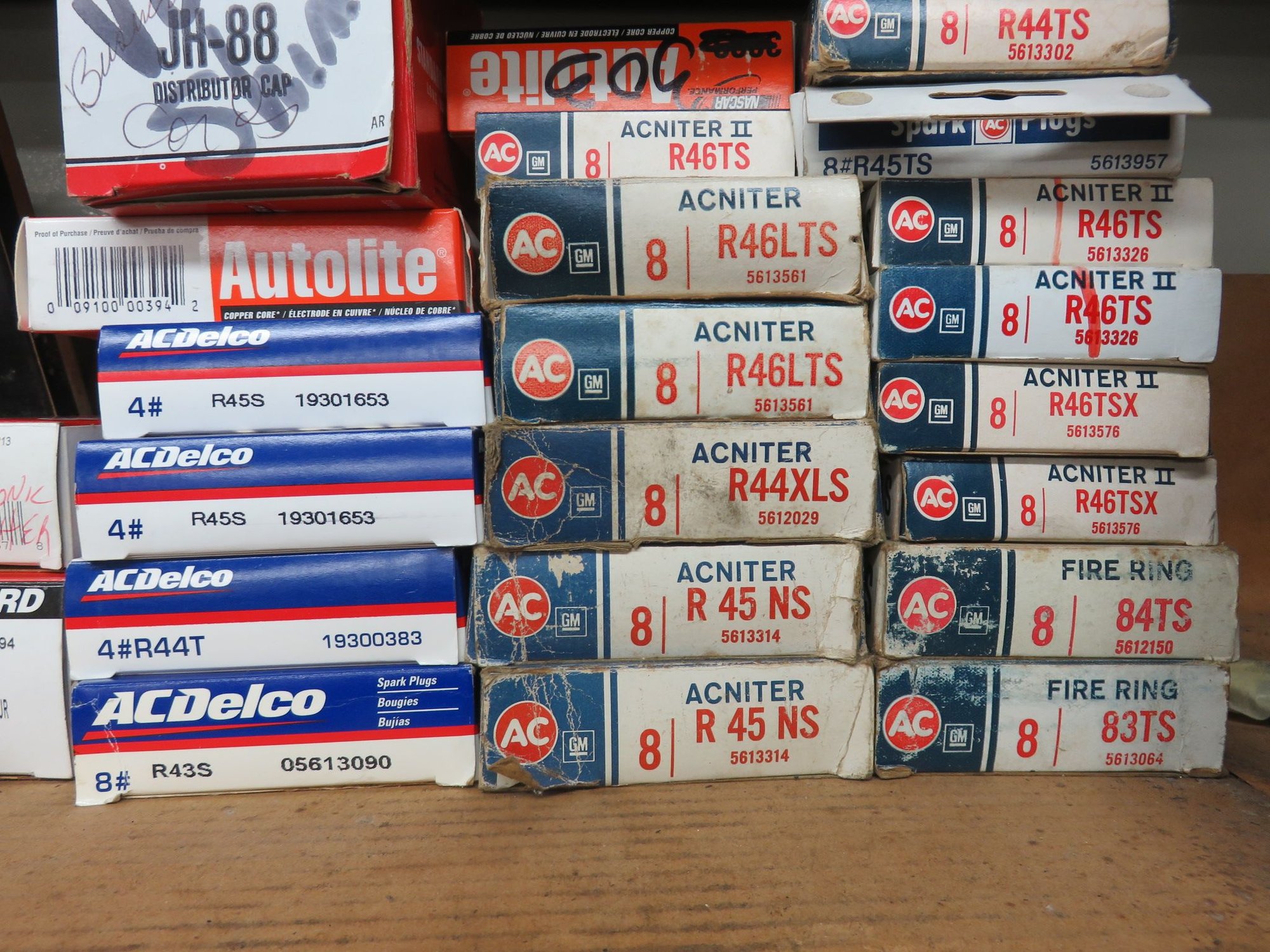

I have a couple of boxes of R45NS and a box of R44XLS if you are interested.
Joe

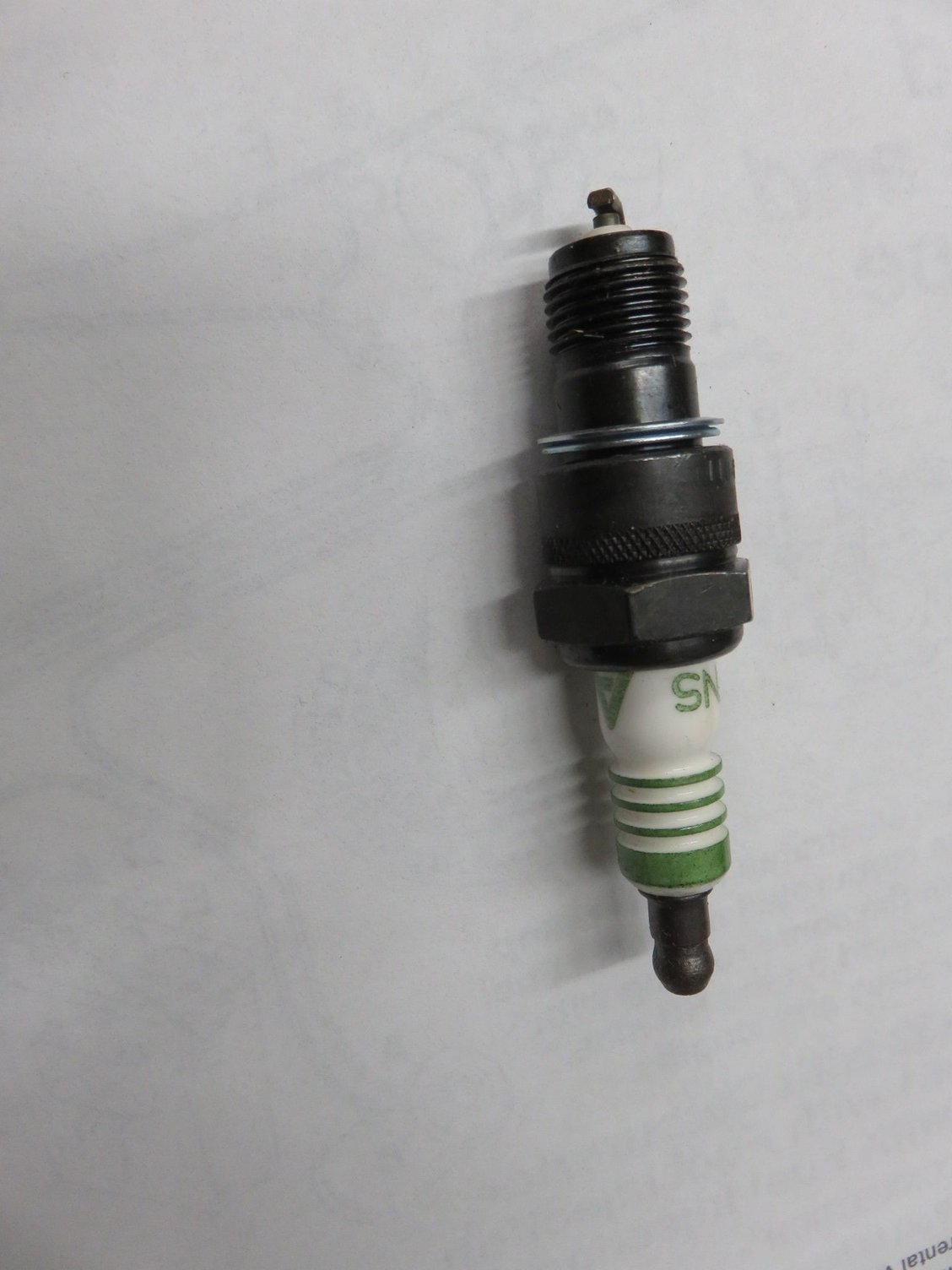

Trent - Perfect timing with this thread, I was just about to look up the spark plug recommendations for my Nassau Blue 66 L72, now running a replacement Bigblock with a solid lifter cam. Just got it a few days ago and I'm already going through the service replacement #3247 due to it sitting for long periods and old gas.
The plug I just pulled out of it is an AC Delco R43XLS and very sooty looking, which no doubt was caused by the old gas (color of 'tea'), incorrect carb adjustments (mixture screws 1/2 and 3/4 turns out), etc but while I'm freshening up the carb, I'll be looking for a set of replacement plugs and the R45XLS seems to be the one I'll need.
Mike T - Prescott AZ
