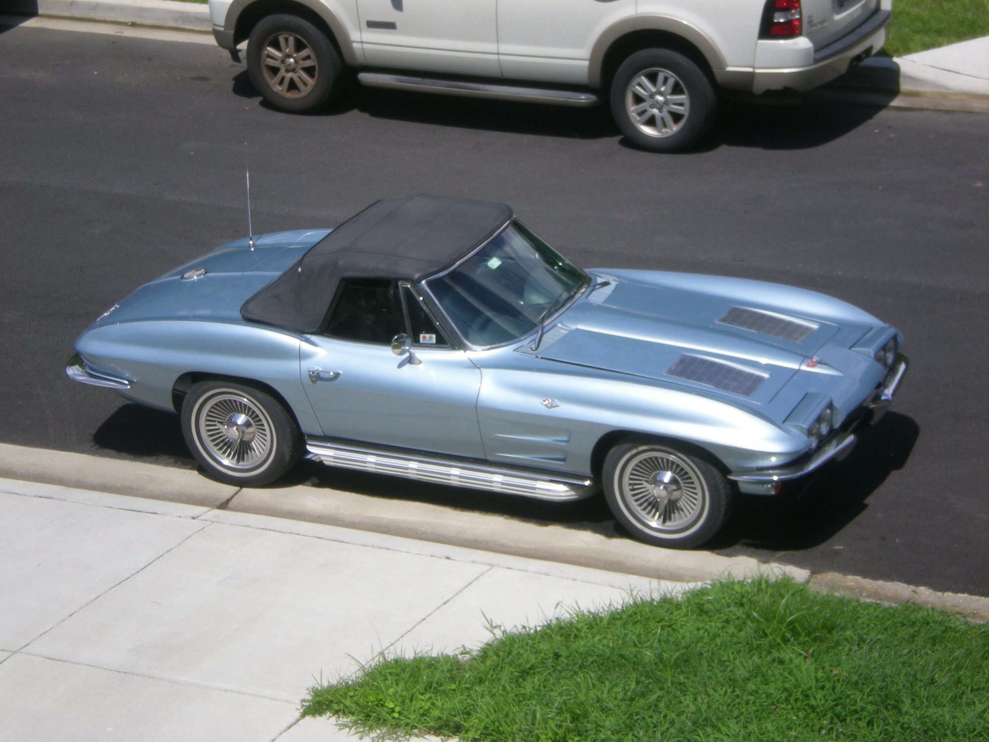

I added one to my ‘64
Old Oct 13, 2021 | 05:10 PM
bodaboom69's Avatar
bodaboom69
Joined: Jul 2002
Posts: 402
Likes: 141
From: Charlotte NC
this is mine... I love it. Good to have a passenger side rear view. A safety upgrade
Old Oct 13, 2021 | 05:16 PM
SJW's Avatar
SJW
Joined: May 2005
Posts: 7,354
Likes: 2,278
From: Central Maryland
My '63 wears one, too.
Live well,
SJW
