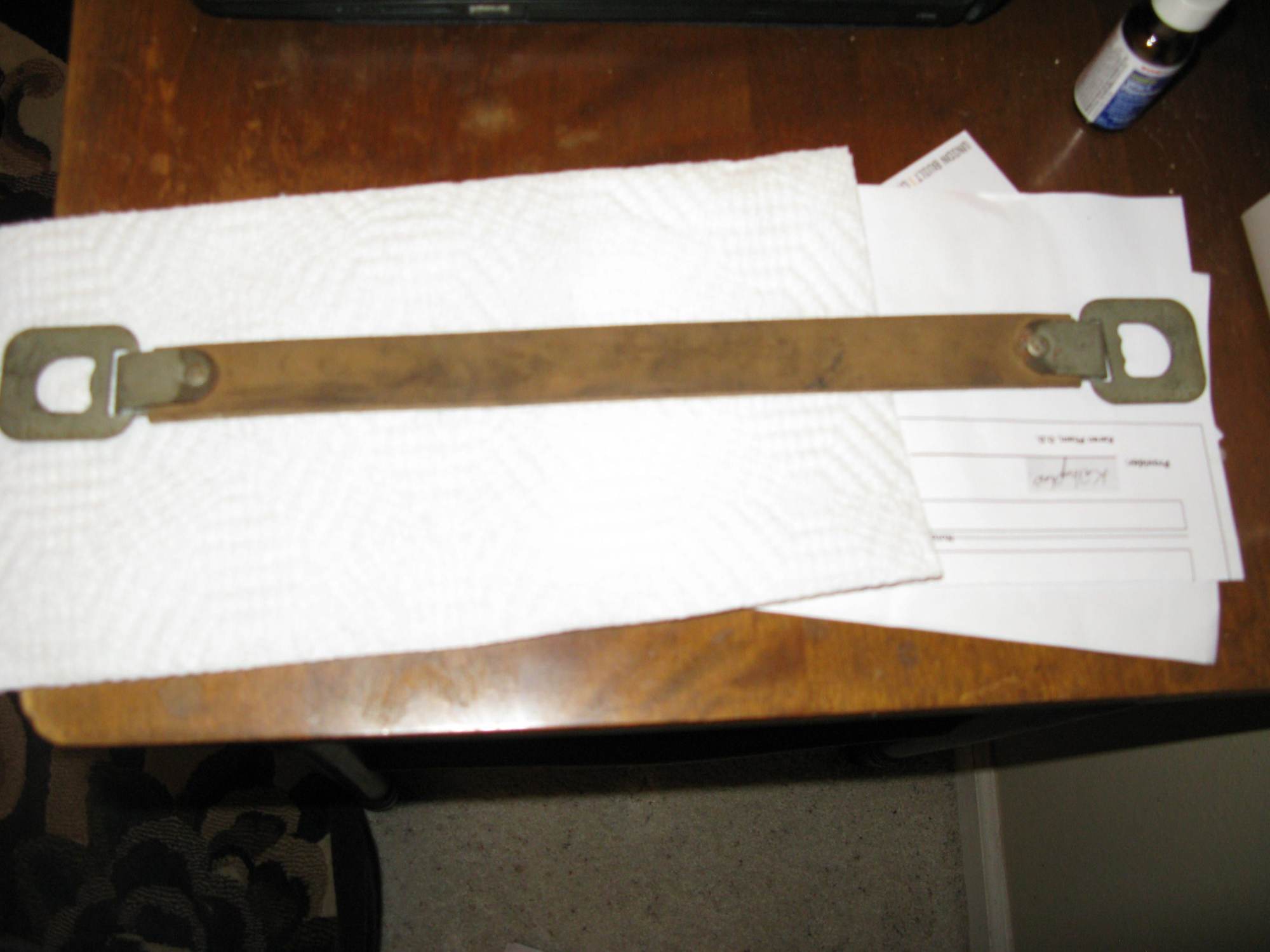

Removing the expansion tank is a 5 minute job. Unbolt the straps and tie the tank off with some plastic tubing (a piece from ace hardware was 2 bucks) or a old boot or shoe lace. leave the hose connected. It takes longer to remove and replace the hold down piece. New maint. free battery's have a built in removable handle.
After removing the old battery place the new battery on it's end in the tray and then lay it in position and reconnect it with the hold down and cables.
If you have or can buy an old school strap ,it will allow you to remove the old battery. Replace the exp. tank and your done. About a 1/2 hour job .
Battery strap
