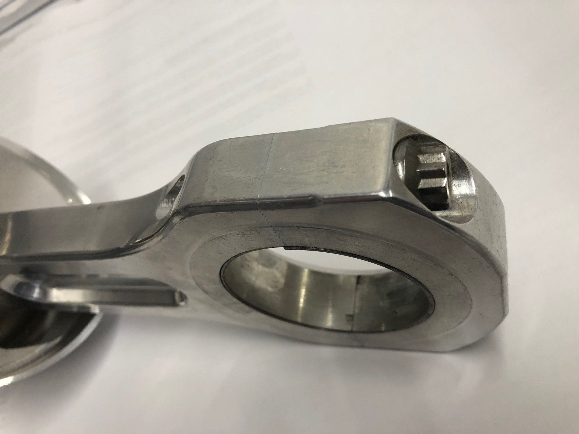

I thought ARP bolts were tightened to a stretch?? Or maybe that's only for the rod bolts. I didn't feel comfortable with that myself so when I built my engine for my 72 Porsche 911 I had my shop torque and measure the bolts.

I have a rod bolt stretch gauge and use it. Never work and not needed on pp bolts.

We use all ARP fasteners in our motors, and yes, they say the best for rod bolts is to measure stretch..... With swapping out rod bearing uppers after each pass, we never had time to do it that way..... torque them to 90ft/lbs, and slap the pan back on.....

Worked on cars all my life but the idea of measuring the stretch of a bolt was to much. Soo when I was building a new engine for my 72 Porsche 911 I took the engine to the race shop that was helping me and Mike did the torque/stretch on the ARP rod bolts.
