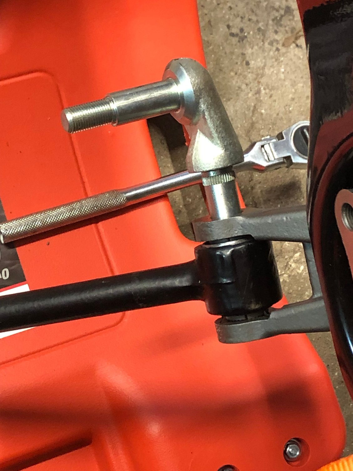

Hi guys.
I'm having a problem putting the pieces in ( see picture )
The part of the piece that holds the shock only goes through the first hole of the bottom on the A-arm.
I hit it gently with a rubber hammer, but, it doesn't help.
I can put the handle of a ratchet through, but the bolt part gets stuck.
The option would be to ream the hole out a little.
Your looking at the right hand side.
Any suggestions would be appreciated.

Check the d-flat hole for paint build up, sometimes when they are painted it will drip in. If the shock mount slides through the strut rod then it's probably paint that can be scraped out

May be the photo angle, but looks like you are not aligned straight with both holes. Mark the shock mount and take it out to see if it is not hitting the bottom and needs to be aligned better. If the rachet handle will go thru and is the same size, it has to be alignment.

Will the mount pass through the strut rod eye without interference? How about the two trailing arm ears without the strut rod in place? As GTR1999 mentioned, there is an internal D-shape in the trailing arm ears that will impede the mount if it's not lined up correctly.

Thanks Gary.
I never noticed if there was a flat part.
I will check tomorrow. and scrape out any paint in there.

The cachet handle in a touch smaller.
And, tight.
IT may need a little arm twisting on top of scraping out any paint.

Make sure you have the shock mounts on the correct side, they are different left and right due to the flat that orients them correctly.

I had them on the correct side. It would be hard to mix them up as they are marked on the end, "R" & "L" lol
Gary (GTR1999 ) was right about the paint.

You were right about the paint in the hole. Some painters are just sloppy. lolol
I scraped it out the paint and tapped the pieces in.
Unfortunately, since I didn't know there was a flat side, I must have much up the threads on 1 side a little, so the nut was hard to get on,
but I used the air ratchet and it's own tight now.
Both sides are good.

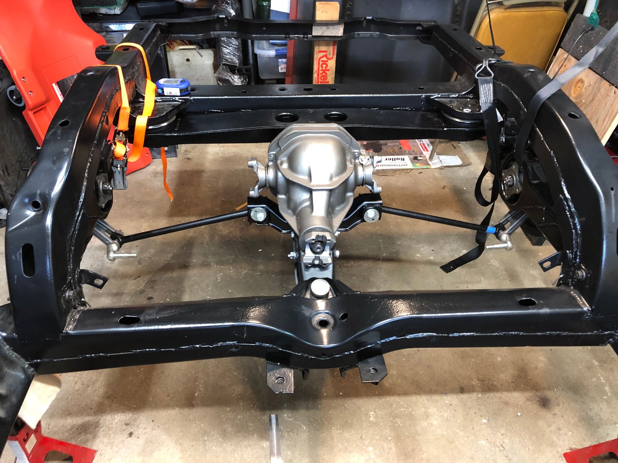

Forgot to attach the picture
Have to take the tape off tomorrow. lol
