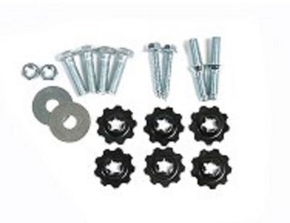

I found out what my problem was. I removed the nut and stud from the lower position of the vent window mount. The large washer that goes on the stud behind the mount was missing. So the slotted mount stud did not move the window mount in or out as it should.
This is a hardware kit for the vent window.
I checked the other side of the car and the washer was there and worked as it should.
Thanks for the help!
