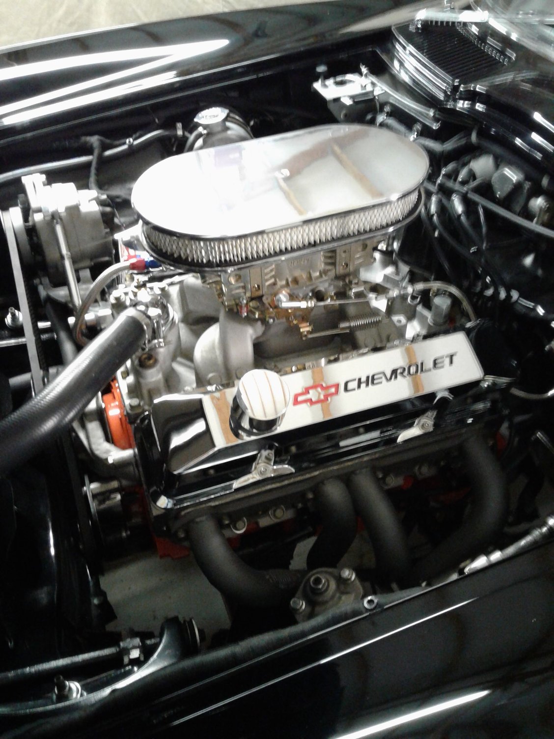

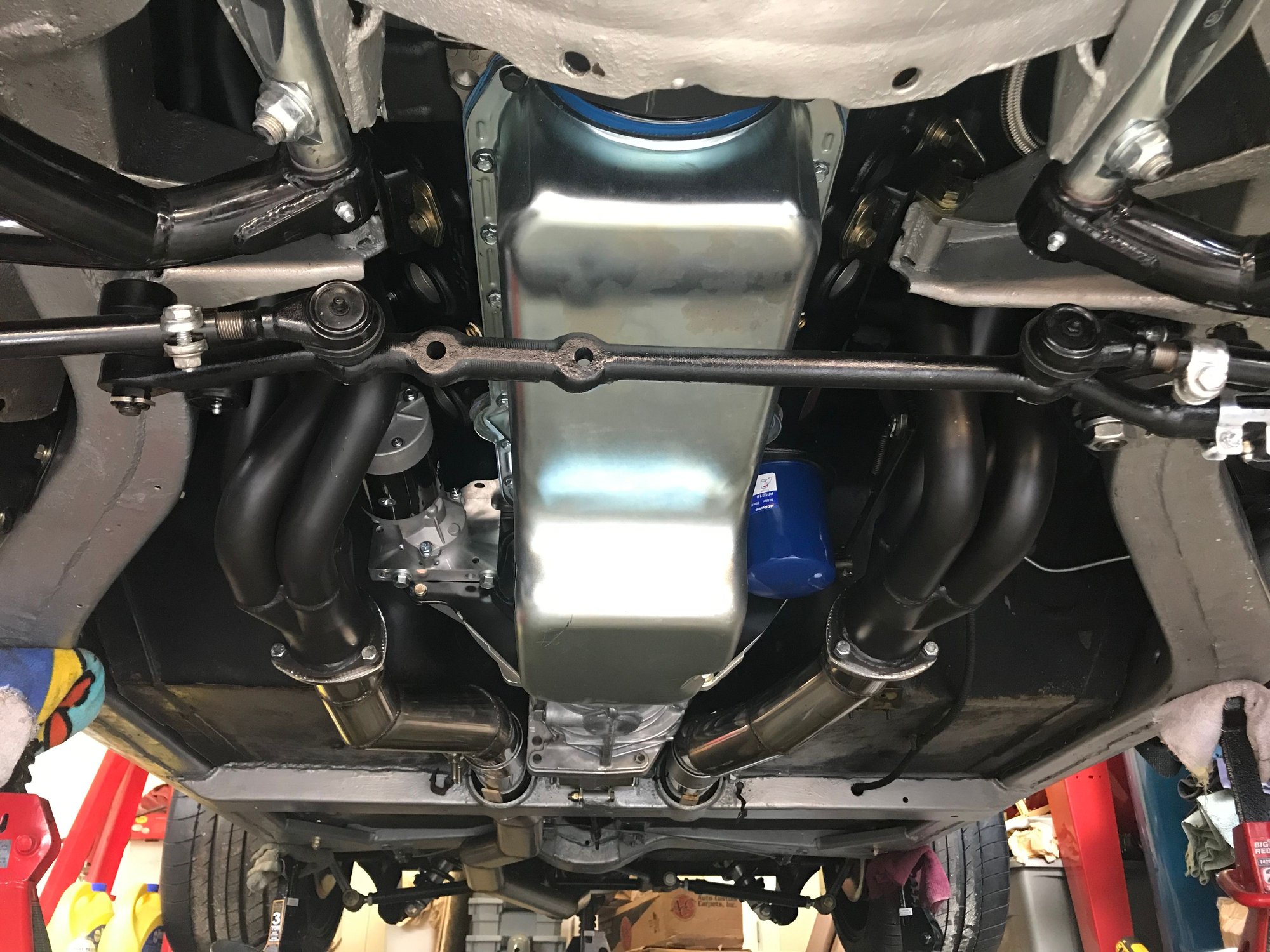

Here is a pic of my BP 427 sbc with Doug’s big tubes and a dual 3” exhaust. No clearance issues.

Wow....the care you take for your C2 is something to be recognized ! And...thanks for the pics. Now I feel compelled to include detailing the under body of my car during winter! I can see the clearance and intend to order Doug's 1 5/8 headers from Summit as they're $416 vs $444 on Doug's own website. What's terrific is Doug's provides all that is needed from collector downsize, to headers bolts, head & collector gaskets....makes the decision pretty simple! As in the past, I have & was planning on a thin coat of Copper Permatex between header gasket & heads but what I've read recently is not to use an RTV....just Permatex gasket adhesive ...which I also do have.
FYIW.....There are terrific heat shields available for our starters & oil filters that I currently have that prevent overheating from the headers which I will also re-install.
Much Appreciated Fellas..............
