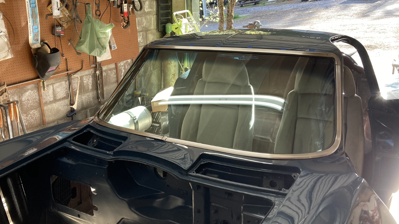

I think all the vendors supply the same repo chips and they are said to be “less than desirable.” I just order a complete set but plan to reuse my originals if possible. The glass guy has saved them and will reinstall my windshield with a new Corvette rubber gasket when the body shop gives the go ahead.
Below is a link to a thread showing my windshield channel.
https://www.corvetteforum.com/forums...5-repaint.html

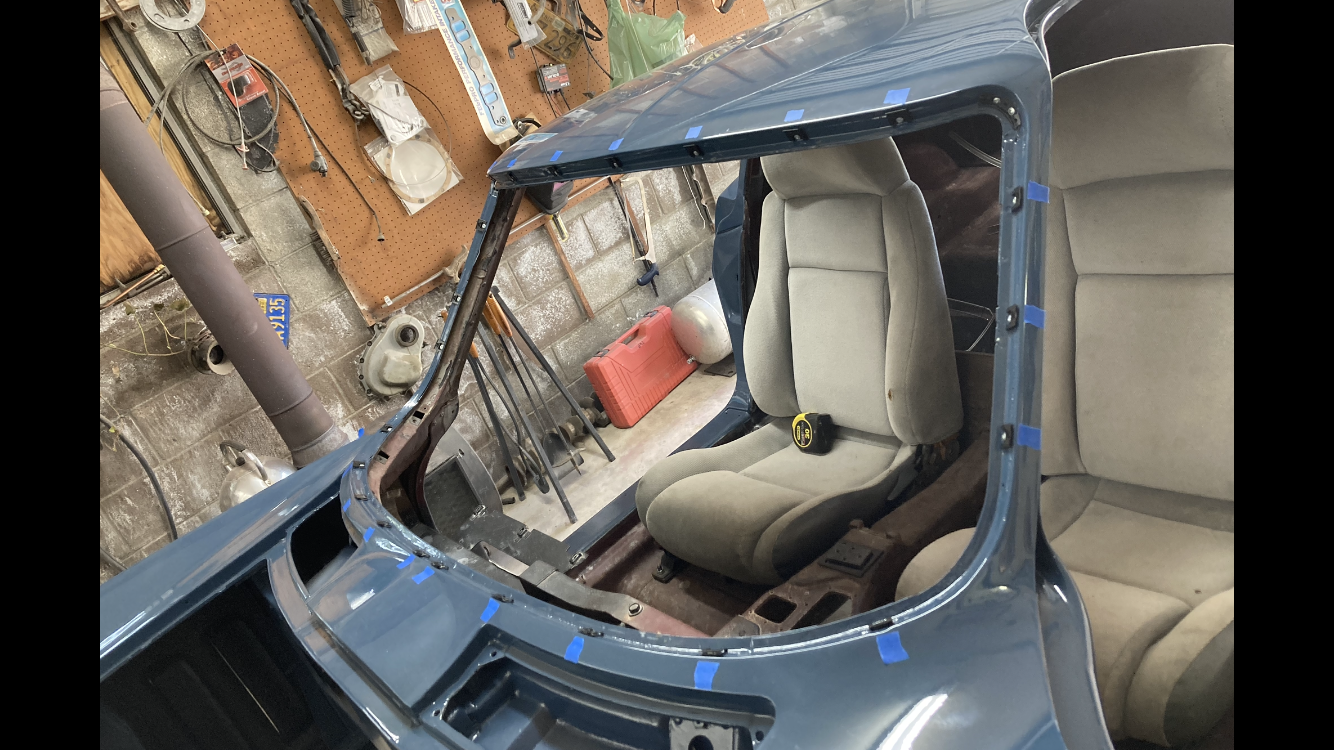

Got my clips from corvette Pacifica they looked just like the ones that came out of my car but I don't know if they where originals. I tried everything to get the trim to fit perfect. Even trial fitting with out glass and rubber. It turned out ok but not perfect. Thought it was just my luck until I saw a resto mod that a very well known builder on this forum did and his trim was worse. Not bad but mine was a little better. Man what a relief. I talk to him about it he said he's never had any fit perfect
Put tape where clips are so you know where to strike it
