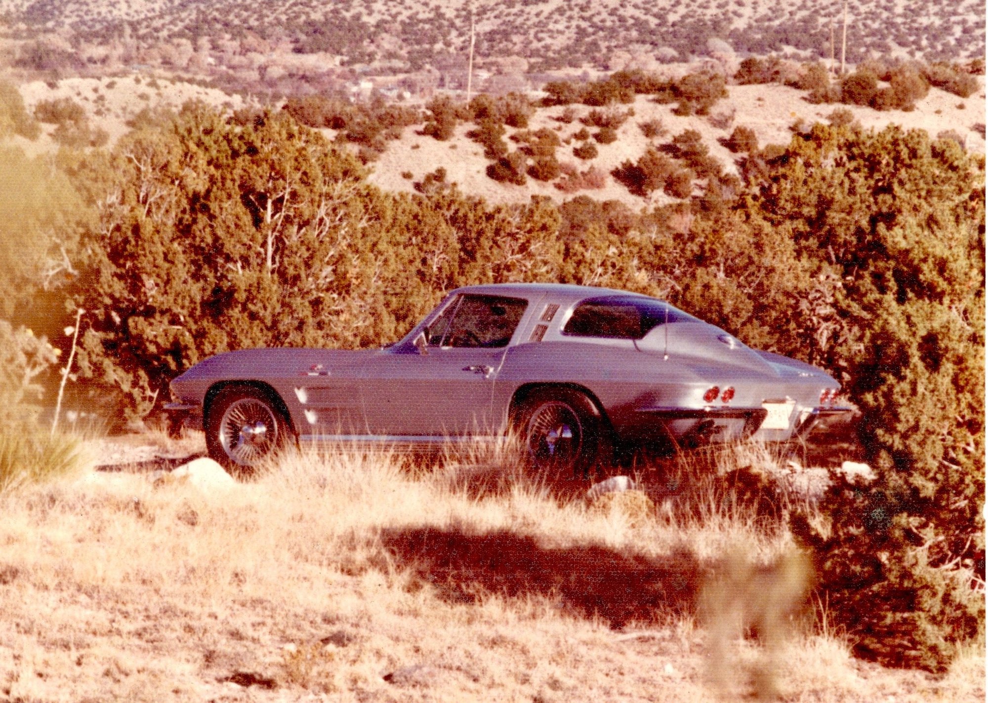

I had a 64, L84 with 3.55 rear gears, it required a little finesse when dead starting on a hill but, other wise was a good all around combination. This even provided more than 25 mpg when driven on thei hiway.

Pacha, that is a cool pic. I bought my 64 because of my dad (also a Vietnam vet),
he had a 63. Here is a pic of him and my grandfather in 64. (Sorry digressing from the thread.)
