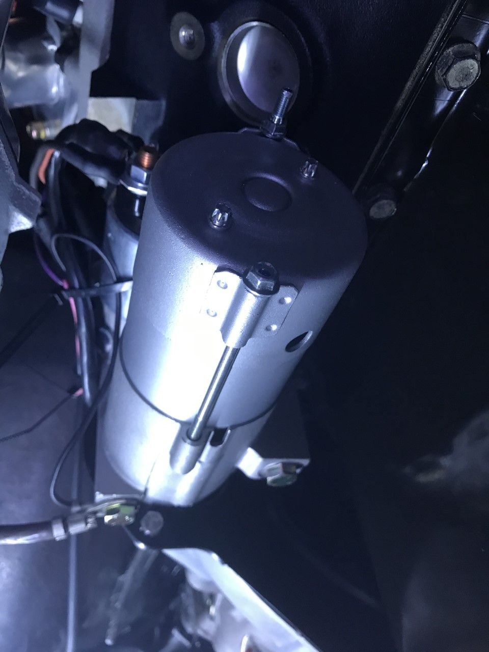

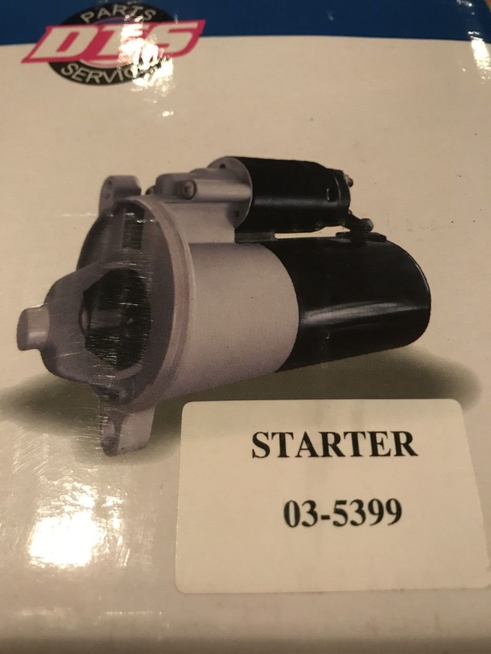

When I installed the ZZ427 in my car in October of 2018 I decided to go with a high torque mini starter instead of the correct style/type for a 67 BB. I was up at GM Carlisle in the summer of 2018 and saw this one on a vendor's table for less than a hundred bucks. It fit fine with no issues and it rocks the house when I turn the key. One of my better investments. A couple of pictures for you. One of the box and one with it installed on the ZZ427. Hope you find what you are looking for. C.J.
