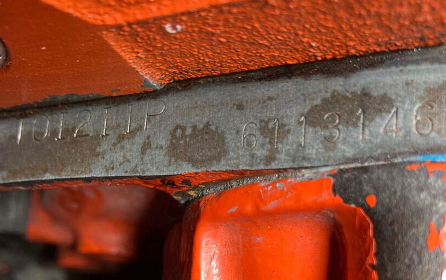

The engine stamp on my 66 coupe is covered in orange factory paint that makes it difficult to read all of the numbers. Below is a picture of a stamp that has had the paint removed. What is the easiest and most advisable way to remove the paint from my engine so it that is easy to see the numbers like below?

Any chemical like paint remover, lacquer thinner, acetone and alike products. Never use any abrasives

Any chemical like paint remover, lacquer thinner, acetone and like products. Never use any abrasives
It will most likely take several applications of the above products. Soak a cloth and use LOTS of elbow grease. Again...NO ABRASIVES!!

IIRC, the factory did not paint over the stamp pad. So any paint on that pad was added later.
But yeah, use acetone, take your time, and use no abrasives, not even a hard bristle brush.
What you want to be able to see is the original engine factory broaching machine marks on that stamp pad. Any abrasives can remove those marks.
Since original broach marks are nigh impossible to replicate, having them intact is key to validating your pad's stampings.

Use a Q-tip or small soft bristle brush to get the paint out of the number indentations after you get the overall pad surface clear. Don't use an icepick or anything sharp.
Did you mean to type 65 coupe? HN was used in 65 for a Fuelie plus the pad stamp begins with a 5.

This is not a picture of my engine - it is from a '65 fuelie.. My car is in storage for the winter
