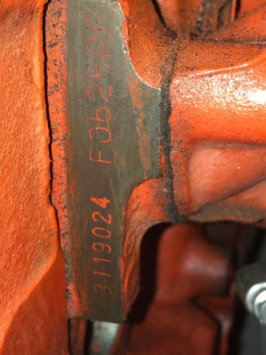

Old Jan 31, 2022 | 11:53 PM
cwp63's Avatar
cwp63
Joined: Apr 2020
Posts: 23
Likes: 15
Default RF code
Originally Posted by RREEVES
Thanks for the information, I would love to find the right block, I believe I can get the right fuel injection unit from Jack Podell.
I believe the car at one time in the 60s was a race car. Don’t have any history the first 5 years before I bought it.
My friend has this engine in his 64. Not correct for his car but might be convinced to sell it to get it in the correct car.
Old Feb 1, 2022 | 08:17 AM
emccomas's Avatar
emccomas
Joined: May 2005
Posts: 31,496
Likes: 1,313
From: Huntsville AL
The original car for this engine (30867S19024 / 30837S119024) does not appear in the NMVTIS database.
