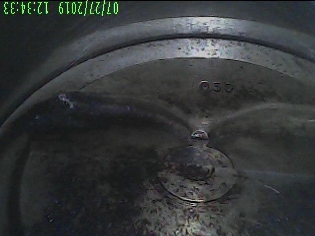

To the OP, do you have a borescope? If so, pull a plug or two and send the probe down into the cylinder and if the piston tops aren't too carboned up, maybe you can see if there is a number stamped on the piston indicating it was overbored.
I've had my 65 300 horse Coupe since '85 and it needed just about everything rebuilt or replaced but the engine, luckily, ran well and had good compression numbers so in all this time, I had never torn it down other than in the beginning when I reinstalled the
original cast iron intake and rams horn exhaust manifolds. About a year ago, I was curious as to what the cylinders/pistons looked like even though I had already seen those composition gaskets peeking out from the corner of the heads so broke out my borescope and
looked inside and was surprised to see domed pistons in there but also saw the .030 stamped on the piston top. See pic.
Mike T - Prescott AZ
