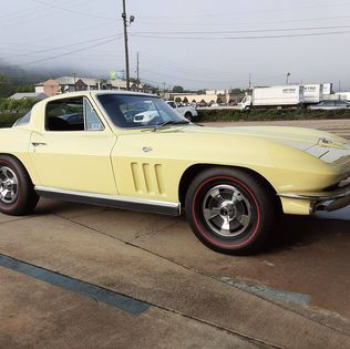

I've owned the sunfire yellow '66 coupe for five years, and have not been diligent on information gathering for this car. It was a K19 California car, bought there, and later restored for sale at Barrett Jackson. I purchased the car from the individual that purchased it on Barrett Jackson. It's developed a cold engine rattle, so I looked for the manifold temp rise valve to see if that was the problem. There is none, so I assume they were not added to the K19 cars. I'm posting the frame plates in the hope that people in the know can give me some information on the car. Would like to know more about the car. Thanks.

Great looking car, I like Sunfire Yellow.
