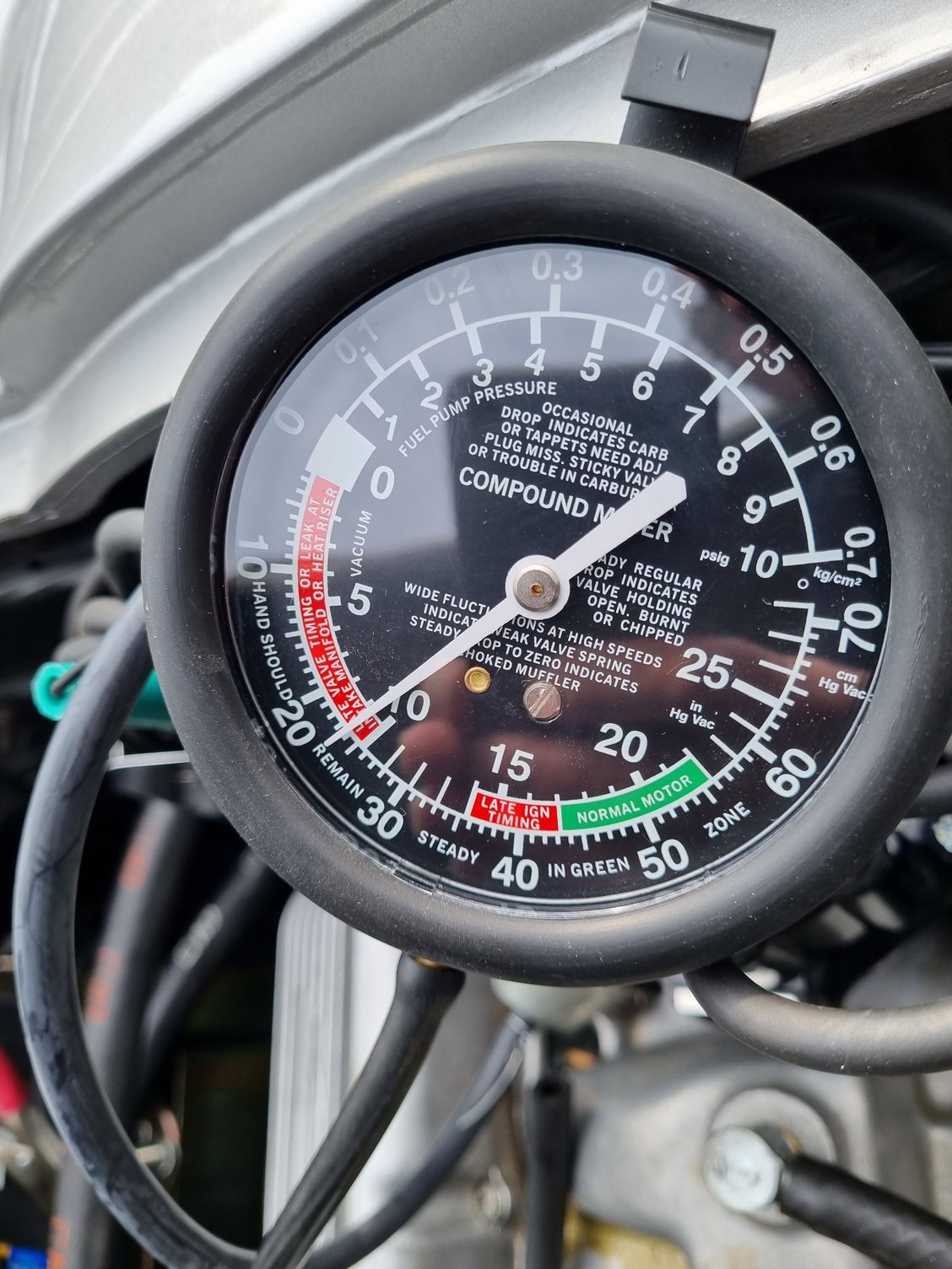

Happy that I had some time today to continue the testing on the timing and vacuum.
These are my findings on the vacuum test (vacuum dial connected to the vacuum advance port on the carb and vacuum can disconnected):
  • 10" at 665 RPM idle
  • 14" at 1040 RPM
  • 19,5" at 2040 RPM
I've looked through shop manuals but couldn't find any reference to what is expected at specific RPM's except that one should try to set to the lowest possible vacuum reading.
What are the expected values?
The BTDC is at 8 degrees at idle (I'm waiting for spring kits to get the centrifugal back to the right values). Dwell angle is now stable at 30 degrees.
Now back to the 'Buba' vacuum can:-)
Hooked up the vacuum hand pump directly to the can while having the engine at idle:
  • At 4" measured 0 degrees extra advance
  • at 8" measured 0 degrees extra advance
The shop manual talks about 16,5 degrees advance with 8" vacuum. Which can can should be the best fit?

A real L-79 cam should pull 14-15" at 750. Your vacuum reading indicates that you have a higher overlap cam, so less vacuum at any idle speed, and you need a 8" B-28 to pass the Two-Inch Rule and have an acceptable stable idle. Set idle speed at the lowest commensurate with acceptable idle quality, which is your call, and my bet is that will be 850-900.
Your data indicates the installed VAC may be DEAD, but either dead or alive it is not functionally correct for you engine configuration. It's a boat anchor!
Duke

If someone can show me how to create a table and add pictures and description to cells it I can comment on the sequence of the pictures.
The above pictures show each time the RPM reading combined with the vacuum readings. Some pictures show the hand vacuum pump (8" and 4") but no changes on the advance on the light gun qualifying the current can out of spec for the engine.
