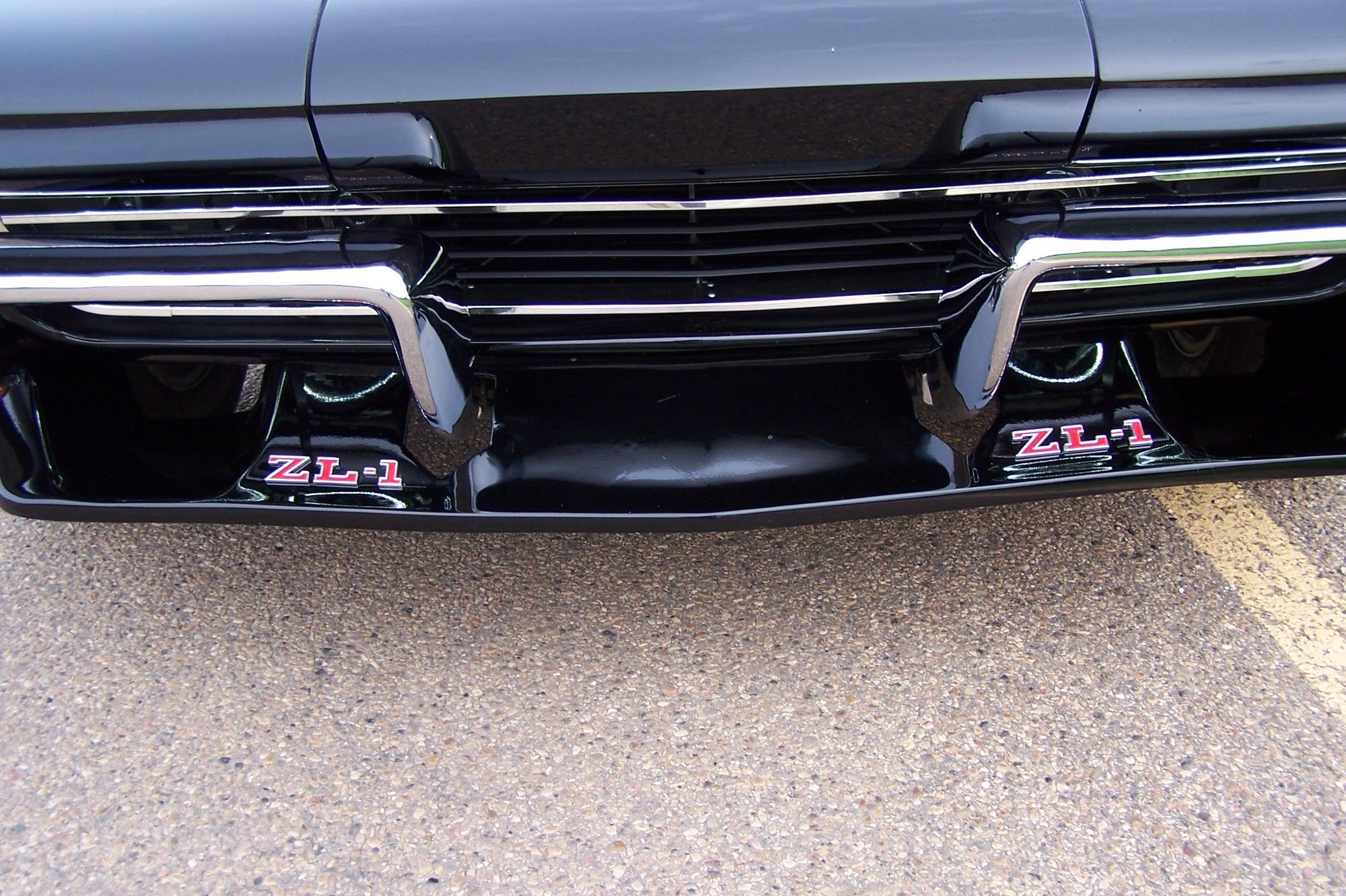

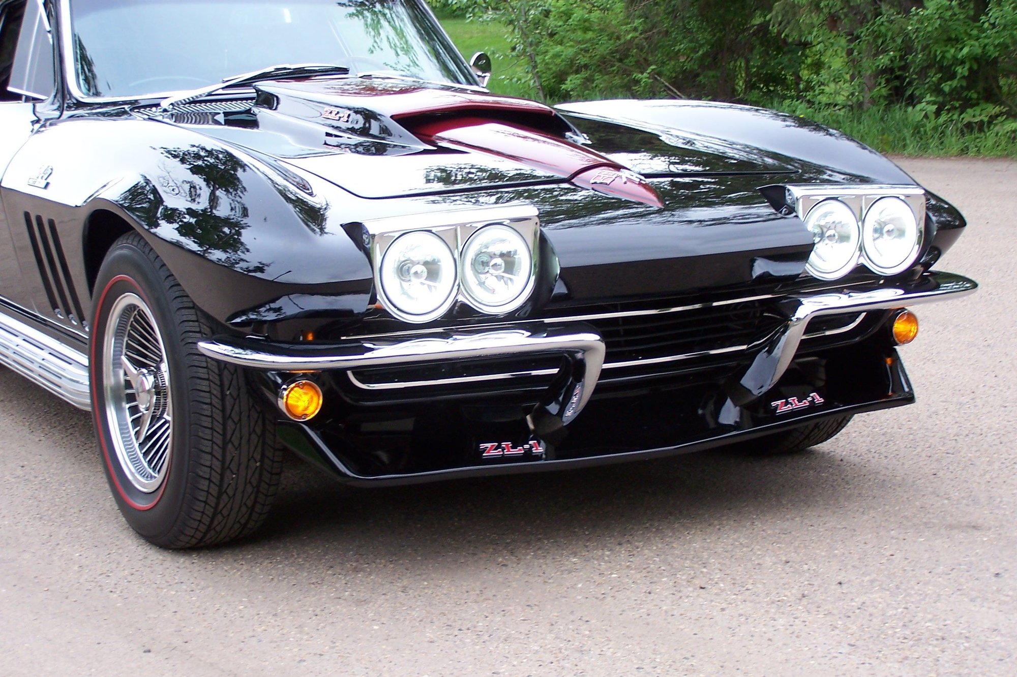

I use one but for a few other reasons: 1- for me I like how it looks, but that's just me; 2- for cooling my front brakes on the '65 because I have the side vent louvers' and my spoiler accommodates this function; and 3- if I ever drive that fast again I want to know I'll stay done with the front end. I've tested this in the past when I was much younger. Here's what it looks like.
There are ducts on both sides to send the cool air to the brakes and exits out the 3 vents behind the front wheel.
Side view shows the profile as the spoiler is not a straight line but a shallow 'V' shape.
You can see where the cuts were made in the spoiler for the bumper to come through.
My spoiler was built back in the 70's by I believe it was Phase 3 Motion or something like that. I've had it that long.
For many years it was off the car but after my resto in 2007 I put it back on and have not looked back. It sits at the just right angle and height that I have not scraped it on any speed bumps or curbs.
I guess what I'm saying, if you think you will like to have one on your car than go for it. Whether you drive at those speeds or your looking for the cool factor it's all good.
Wayne

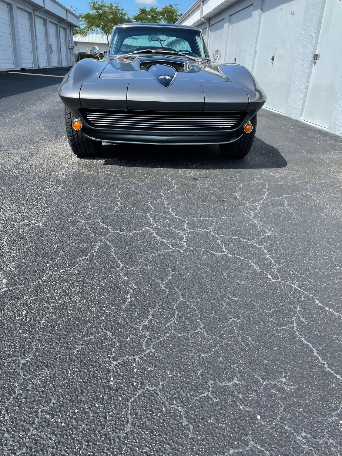

heres a picture of the 67 with the ecklers front spoiler can't tell you about speed, don't drive that fast anymore
