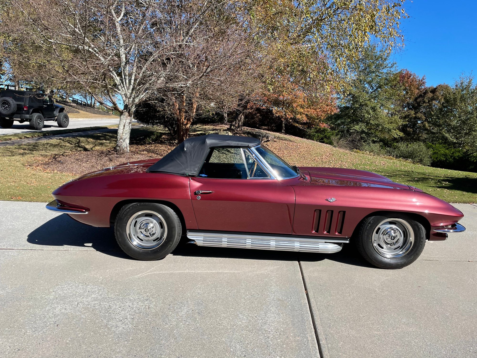

I have 65 L76 Roadster with factory AC, TI, Power Windows, Hardtop, Teak telescoping steering wheel, Wilwood brake syste . Car runs and looks great. I would classify it as very nice driver, but the heater core and evaporator both need replaced and the shop suggested I install a 134a conversion kit. I am considering selling the car and I'm trying to figure out if it makes sense to have the recommended repairs done as they are pricey (3k-3.5k). Would it better to sell "as is" or would having the repairs done increase the value enough to justify the expense? Would the AC conversion diminish the value of the car?

The car was completely restored in the early 80's and side pipes were added (I have the original valance panel for rear exhaust). I have had the car repainted, interior refurbished and added a Wilwood brake system to the car 2 years ago as the original brake system had corrosion problems which were causing reliability issues. I have also replaced the carburetor (have the original). I am open to suggestions as to target market, but I would think the most likely buyers would be someone looking for a very nice driver or a collector who wants it due to its rarity. Only 25-30 were made with the 365/AC/TI combination, add in all the other factory options and the car is pretty rare.
