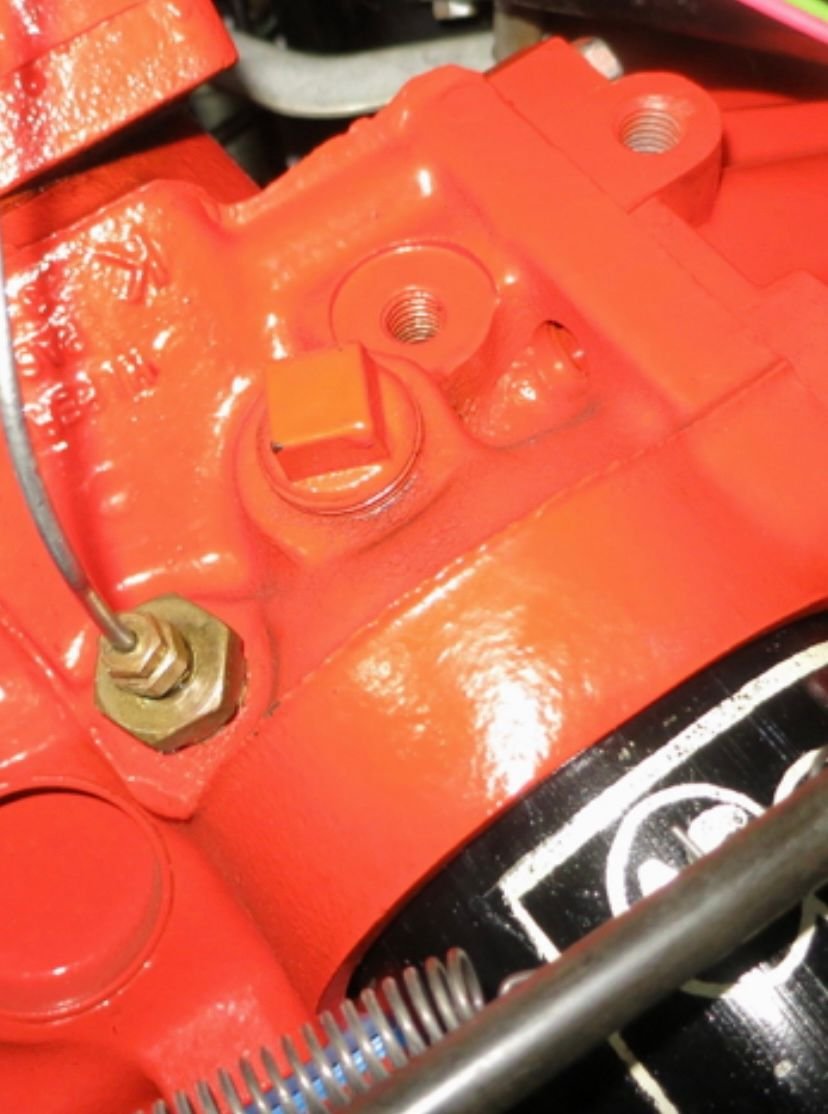

So the upper rear main bearing insert just acts as a dam for that 1/2" hole drilled from the upper main bearing saddle into the passage from the oil pump to the filter?
The Bowtie block i have has two larger pipe tapped holes above the oil filter boss (3/8" and 1/2" to my eyeball), guess I will plug the large one and bush the front, smaller one down to 1/8" for a pressure gauge take off.

Originally Posted by AZDoug
……… i have has two larger pipe tapped holes above the oil filter boss (3/8" and 1/2" to my eyeball), guess I will plug the large one and bush the front, smaller one down to 1/8" for a pressure gauge take off.
This is what I believe is the correct configuration (see where line is attached), the other picture shows the size/thread of the holes in question
To Big Block oil system questions
