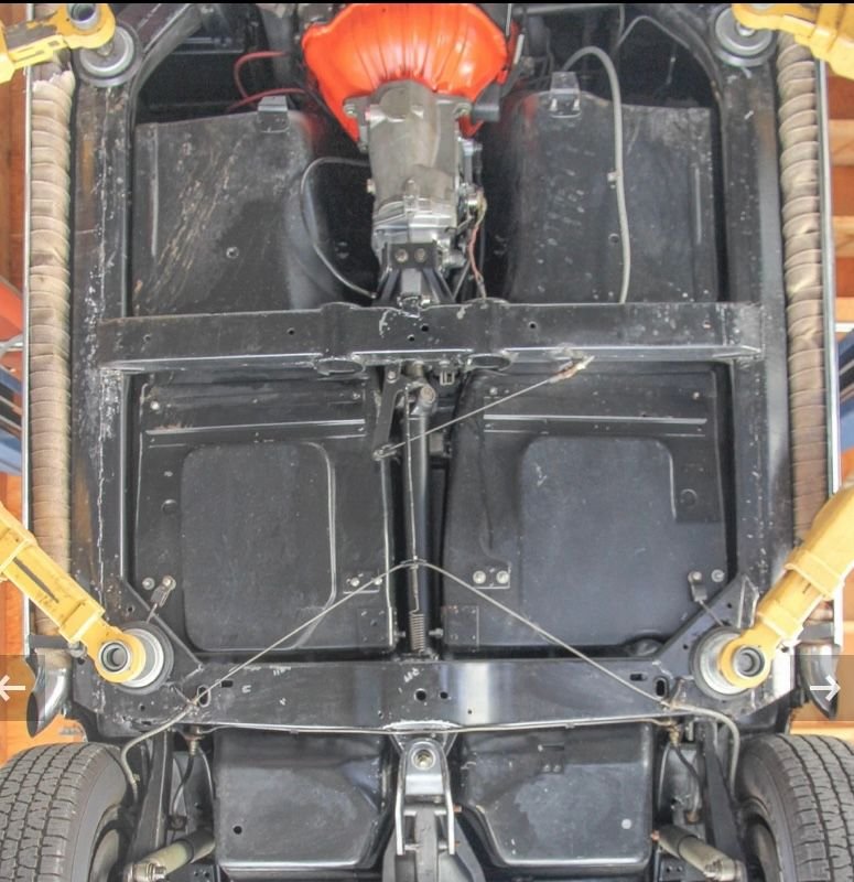

Regarding the OP’s concern about heat, I’ve had side pipes C2’s since the early 70s, never experienced any abnormal heat problems, just the opposite, keeps heat out of the cockpit and away from the drivetrain components. However, I have seen some people wrap them, I assume to reduce heat? see below

That is how I wrapped mine. In the Florida sun and heat, you will do anything to keep the cockpit a few degrees cooler. Having a black/black coupe does not help. Jerry
