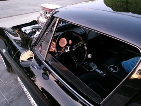

I love my LED dash lights. Haven't missed the dimming feature once. I think I've only used that in cars when I was up to no good, and I'm far too old for that now

mine are bright as can be but did go after market with classic instruments gauges .
