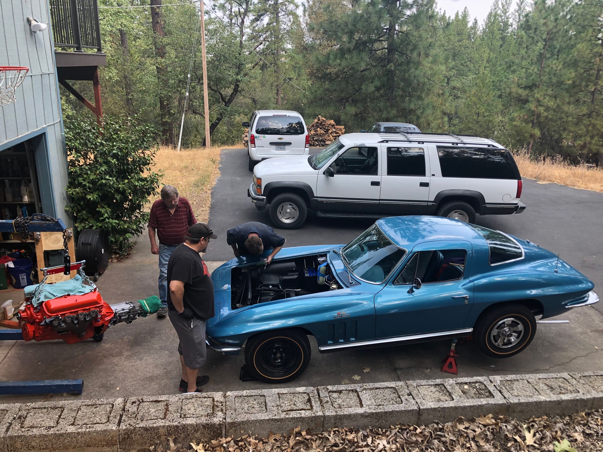

Yes, absolutely. Here's mine with Hurst and rods about to go in. The towel taped around the shifter is to protect the shifter and the tunnel insulation.
Edited to add: Without the tilter I don't think we could have done it this way; the precision of the tilter was paramount to being able to ease it into position with the shifter installed.
