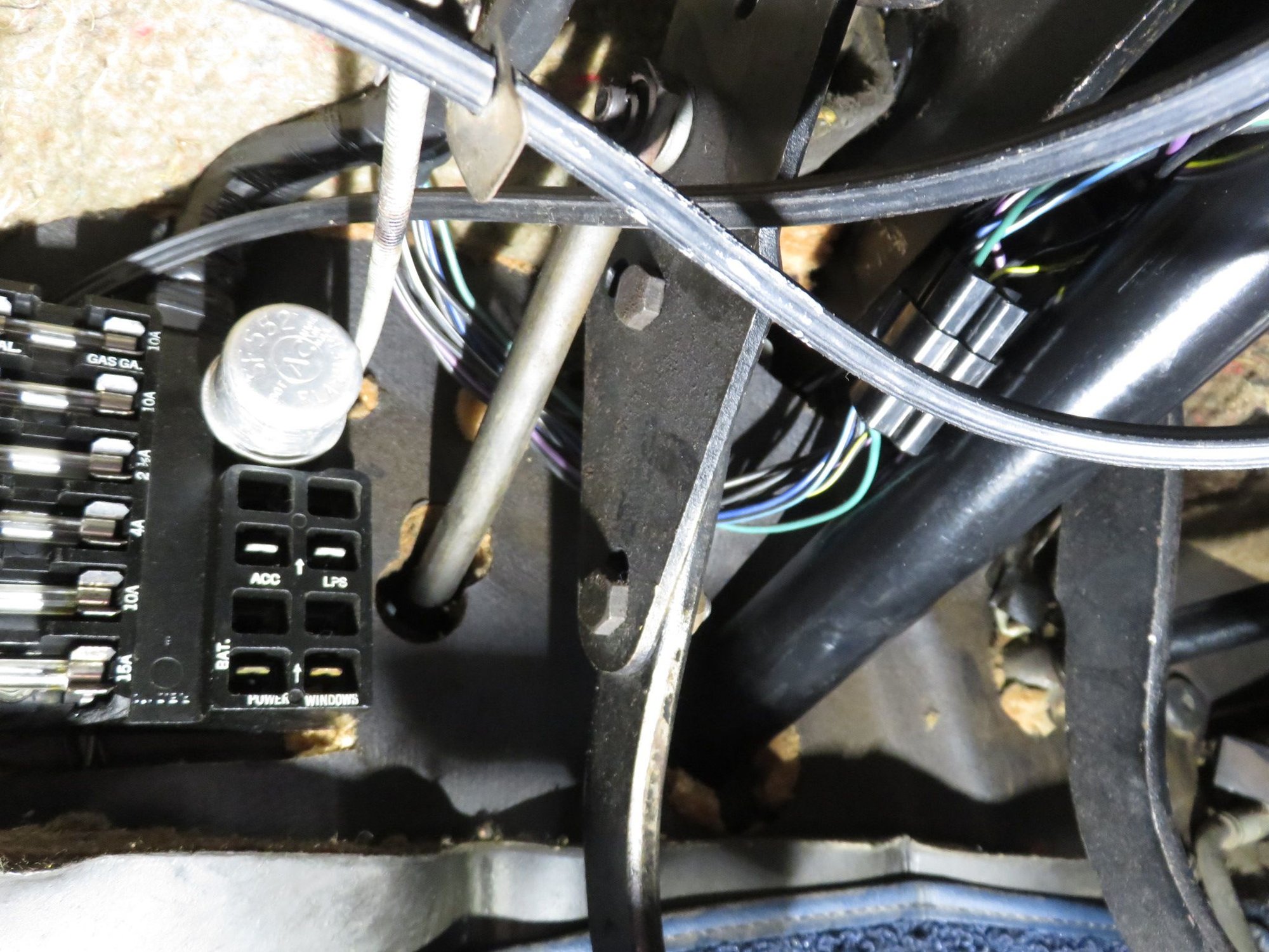

Pulled the a/c vent on the drivers side and the radio panel on the passenger sid and a few other things to get a better look. Looks like there is a clear flasher in the upper right corner of the old fuse panel. Maybe it never had the two wires?

Final update. First, I would have restarted with an OEM harness, but this has an LS2 with 4L60E, I have no idea what other changes would be involved. So, I did what I suggested, I took power from the brown connector that should be to the blower. Since this is an AC its not needed for that and then I took a purple wire and put on a male packard type 56 connector and a male spoon connector on the other end. I hooked up purple to L and brown to X on a local store bought 2 pin flasher. Turn signals work (as does the brake lights)! A bit of a Bubba, but easily undone if unwanted. Will get a clip and attach to radio panel. Thanks all.

Here is where my signal flasher is and my car is stock.

His is a 64.
Old Feb 27, 2023 | 06:58 PM
plaidside's Avatar
plaidside
Joined: Apr 2000
Posts: 5,098
Likes: 1,351
From: New York New York
Originally Posted by 65GGvert
His is a 64.
And so is mine in the pic.

I've never seen a 64/65/66 with a flasher in the fuse box. They have all been mounted on the radio side panel. I haven't seem all of them, so maybe some did.
UPDATE: I just read a post from 2006 on a 64 turn signal flasher that said early to mid 64 flasher was plugged into the fuse panel like plaidside said, and showed in the picture. It won't help in your (slwhittenburg) case because you have a replacement fuse panel, so your solution makes sense.

My 63 is mounted in the fuse box as pictured above. Is that correct?
Old Feb 27, 2023 | 08:52 PM
65GGvert's Avatar
65GGvert
Joined: Jul 2006
Posts: 22,162
Likes: 4,171
From: Kannapolis NC
63 diagram shows that to be the case
