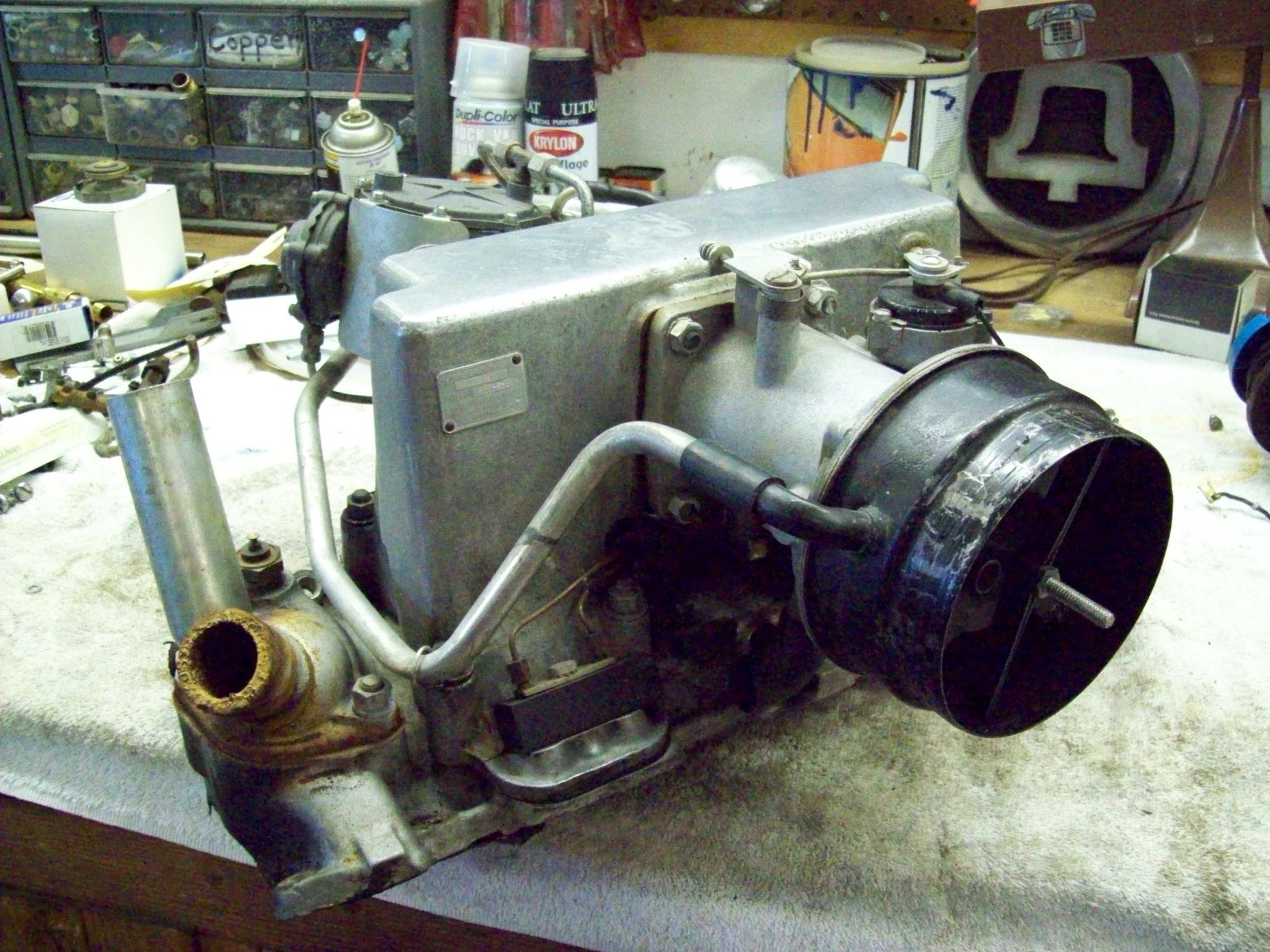

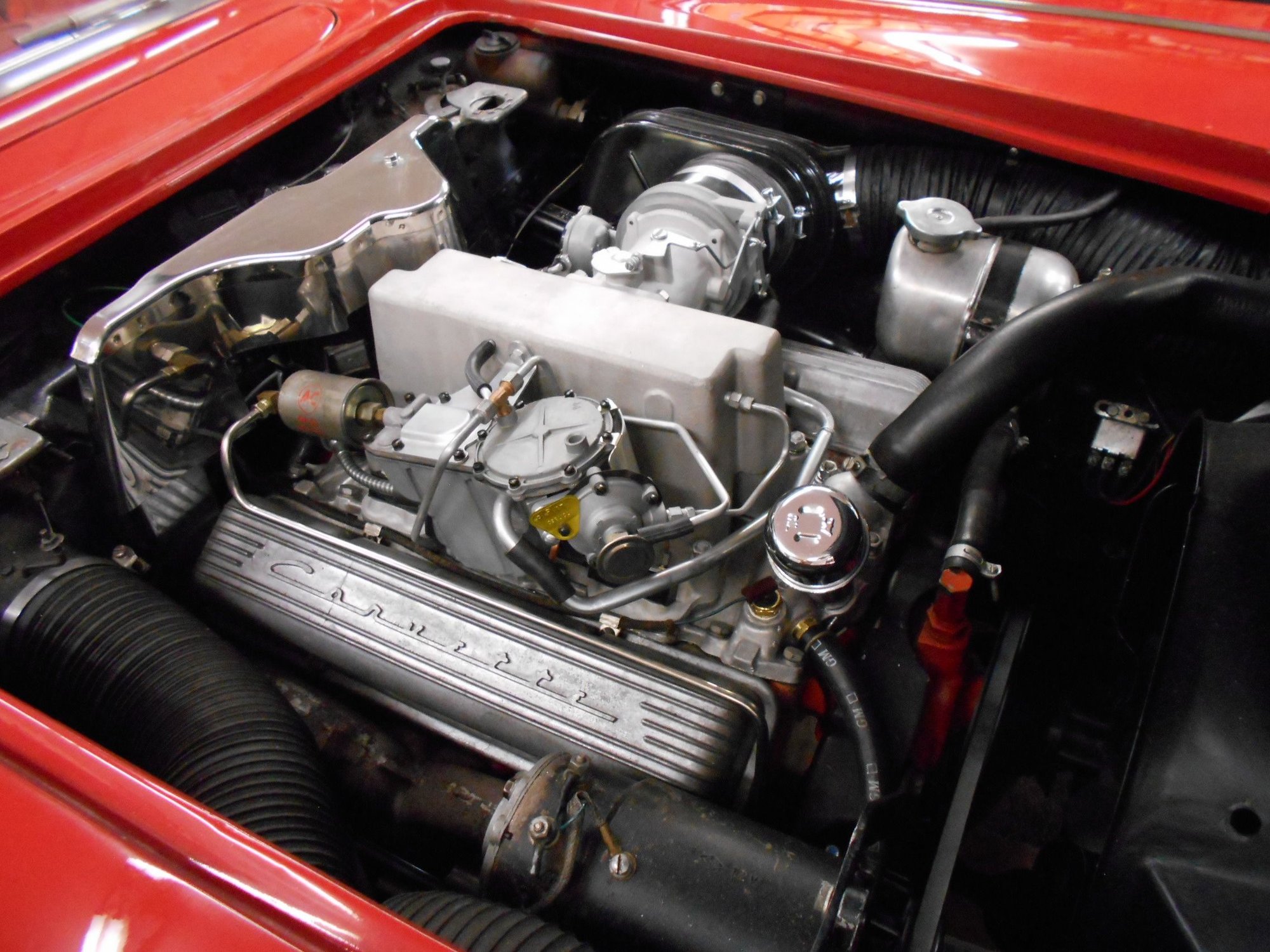

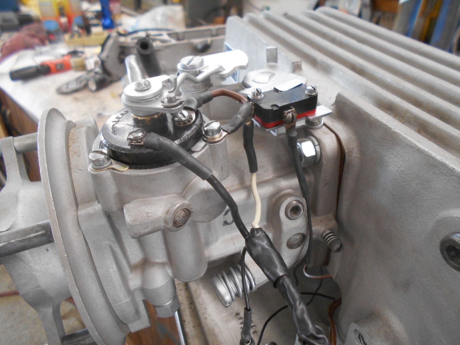

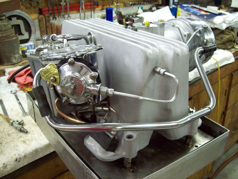

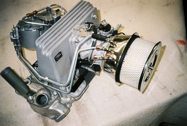

Only if an EXTREMELY knowledgeable person observed the FI unit, would they know a 57 (and 4 different models) from a 59. They ALL have the finned top plenum, with the main differences being in air meter and fuel meter changes. Thus, for example, a properly rebuilt 58 unit (4900 or 4900R), to the MAJORITY of observers, would not have a clue what unit was on the engine. In 1960-62, the FI units VERY CLOSELY resembled the appearance of a 57 unit-------------------------EXCEPT-------------- they had a smooth top plenum. Of all the early units with a smooth top plenum, there are some noticeable differences in the 62 units. But again, VERY FEW casual observers would know the difference between a 60-61 and 62 unit.
SOOOOOOOOO, if the desire is to have a Rochester fuel injection unit on the engine that LOOKS authentic (to most people), rather than absolute period correct, there are often FI units up for sale that would work fine.
ALL 57-61 FI units had the choke (enrichment housing) mounted on top of the air meter. One quick distinguishing feature of the 62 only units is that the choke housing is on the side (facing firewall) of the air meter.
The 4 different 57 units were 7014360. 4520, 4800, 4960.
This is a 57 4520 unit.
These 2 are a 57 4800 unit.
The next 4 is a hybrid 57 unit. It has features of both a 4520 and a 4800 unit. It was modified many years ago by a knowledgeable FI person in California for Steve McQueen's 57 Chevy convertible, which is now owned by Ruth Buzzy and her husband.
This is a 1960 7320 unit
These 2 are a 62 unit. Notice the choke housing on the side of the air meter. A quick distinction between a 60-61 and 62 units.
And last of all, this is a highly modified unit on the SB400 in my 56.
It has an early finned top plenum (to resemble a 57) which was heavily ported, a 62 air and fuel meters and several other modifications.

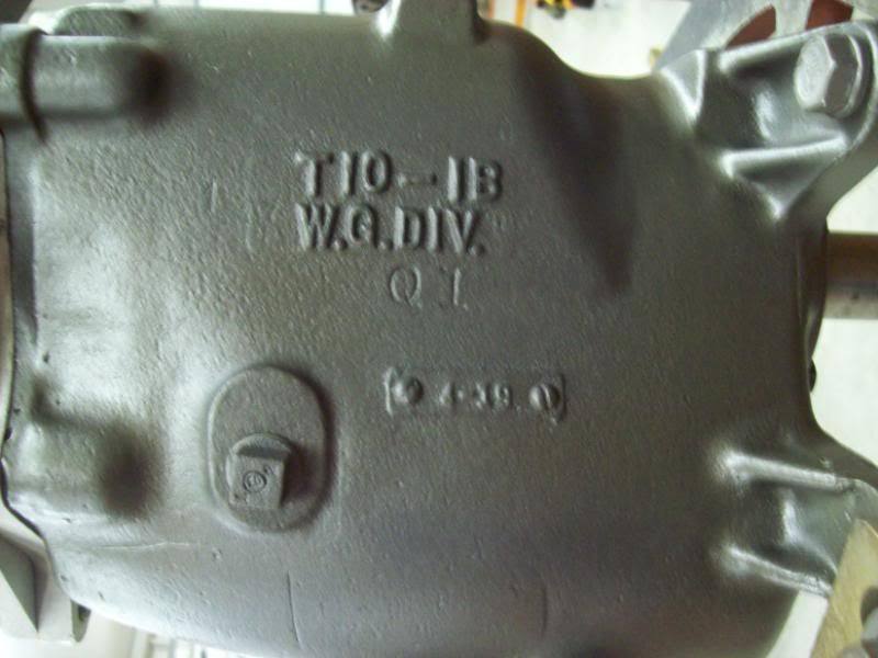

Pre-production and prototype B-W T-10 4spds were built in late 56-early 57, but they were NOT factory installed in a Corvette (NONE in a 57 pass car) until later in Apr 57. Thus, a CORRECT dated 57 T-10 will bring premium prices. BUUUUUUUUUUUT, a 58-60 T-10 are more reasonably priced, and to the NON-knowledgeable person, they appear NEARLY the same.
Although, since I am not a correct numbers person, I much prefer the upgrade to a Muncie for my 56 (OH YA 4spds were not even available in 56!).
The 57-58 T-10 had a round boss for the filler plug and 59-60 had an oval boss.
Muncie on the floor while replacing the clutch.
