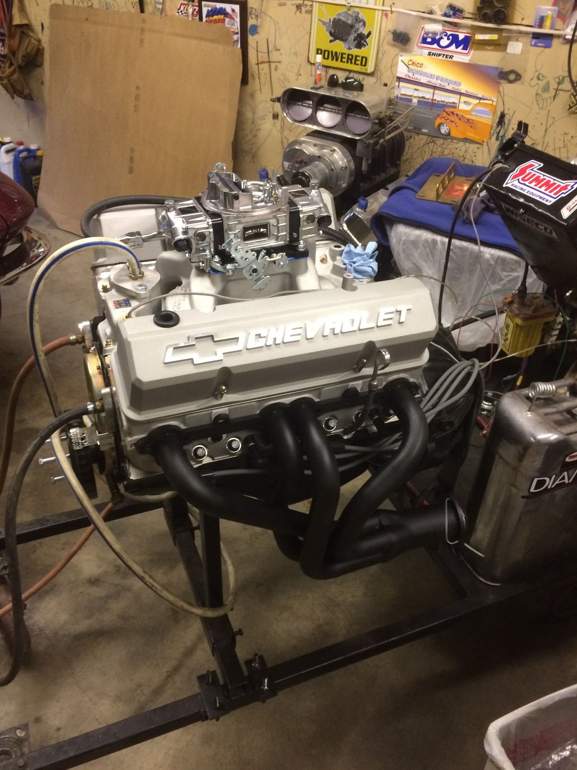

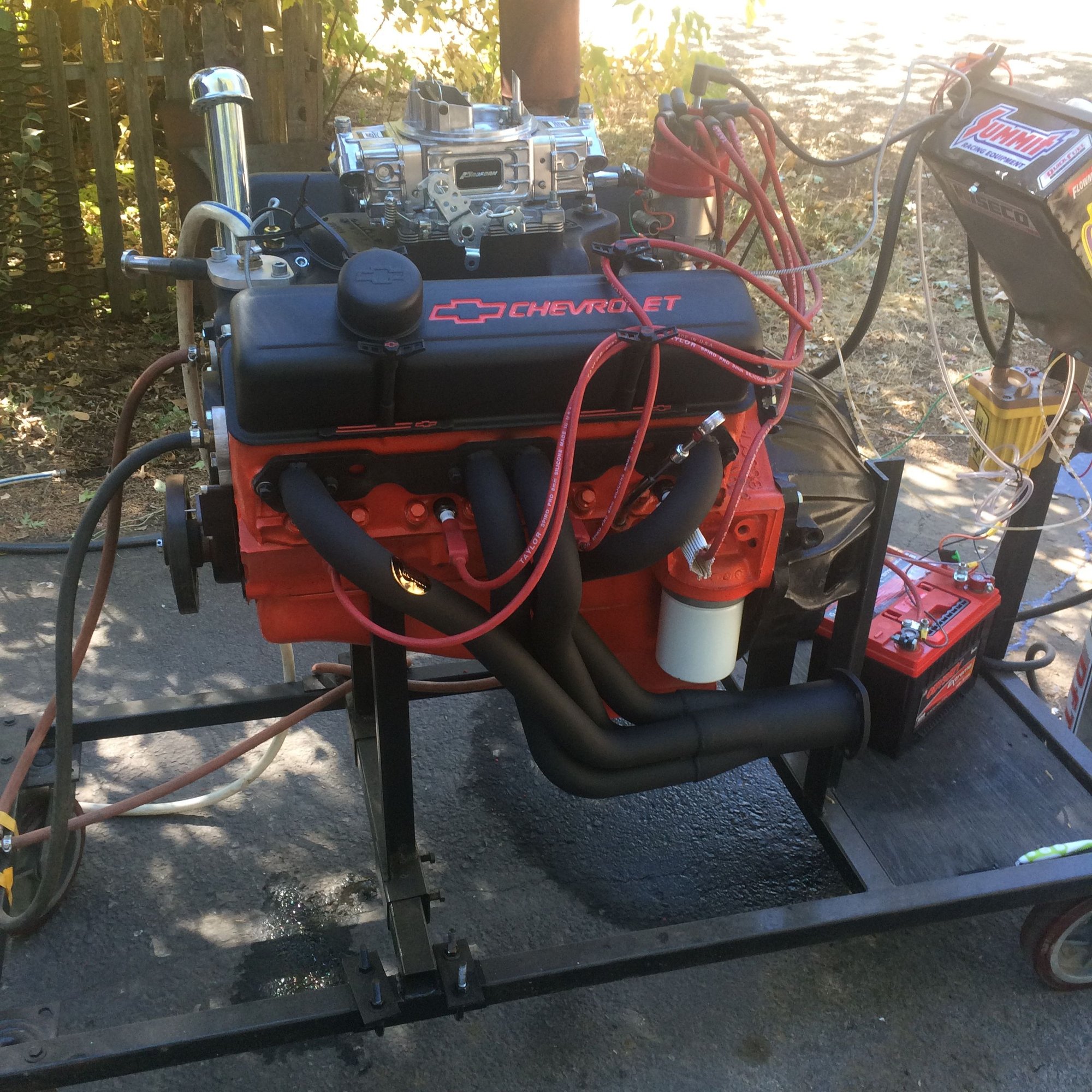

Do not waste your money on shorty's Summit long tube are an excellent choice I have a set on a 500hp stroker no clearance issues. I also have Hookers Summit are better

Post #4 are the Summit headers I like the way they are made the fitment it better around the oil filter and the starter and there is more ground clearance. These are the Hookers cost more and not made as well
