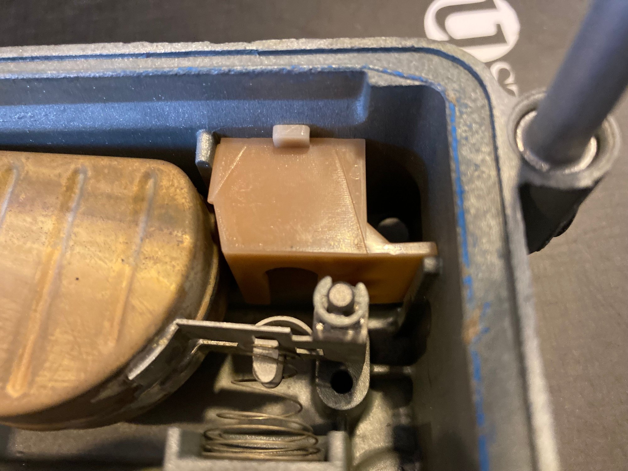

About to replace float as well as needle and seat.
A. Any tips on removing the ‘C’ clamp holding float in place?
B. Understand fuel rails leak when reinstalled.
Likewise any tips to prevent leakage.
Again, thank you for the assistance

In anticipation of that clip taking a flyer, I removed the bowl and ordered an extra clip from Holley.
Frustrating to have experienced such a severe leak. Fuel was gushing from the secondaries.
Ironically I had replaced that needle valve 2 years ago.

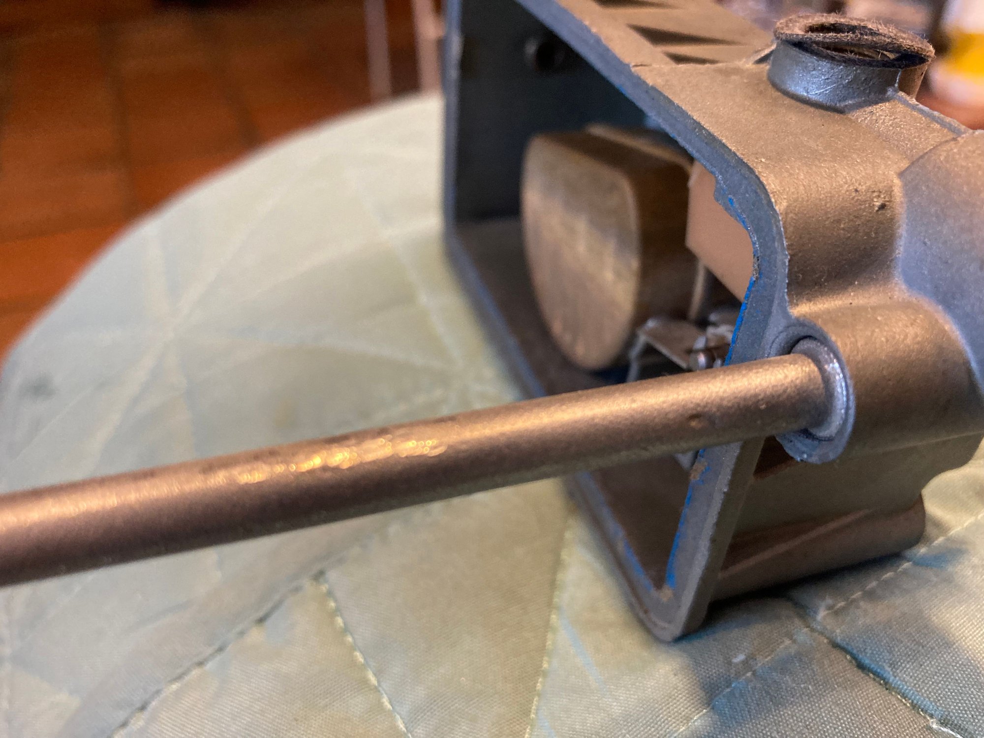

When removing the ‘E’ clip from the float, the pin on which the float pivots came out as well.
Does it merely push back in, or do I now have a problem with the bowl?
Thank you for your assistance

My principal concern now relates to the pin on which the fuel float pivots . It came out when I attempted to remove the ‘e’ clip .
Can it merely be pressed back in, or am I in need of a new bowl?
