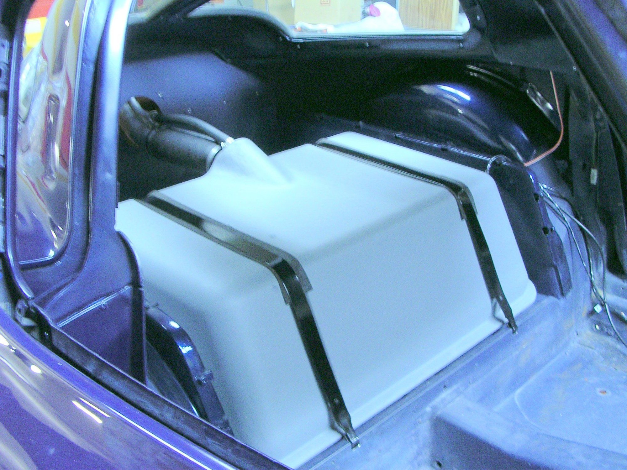

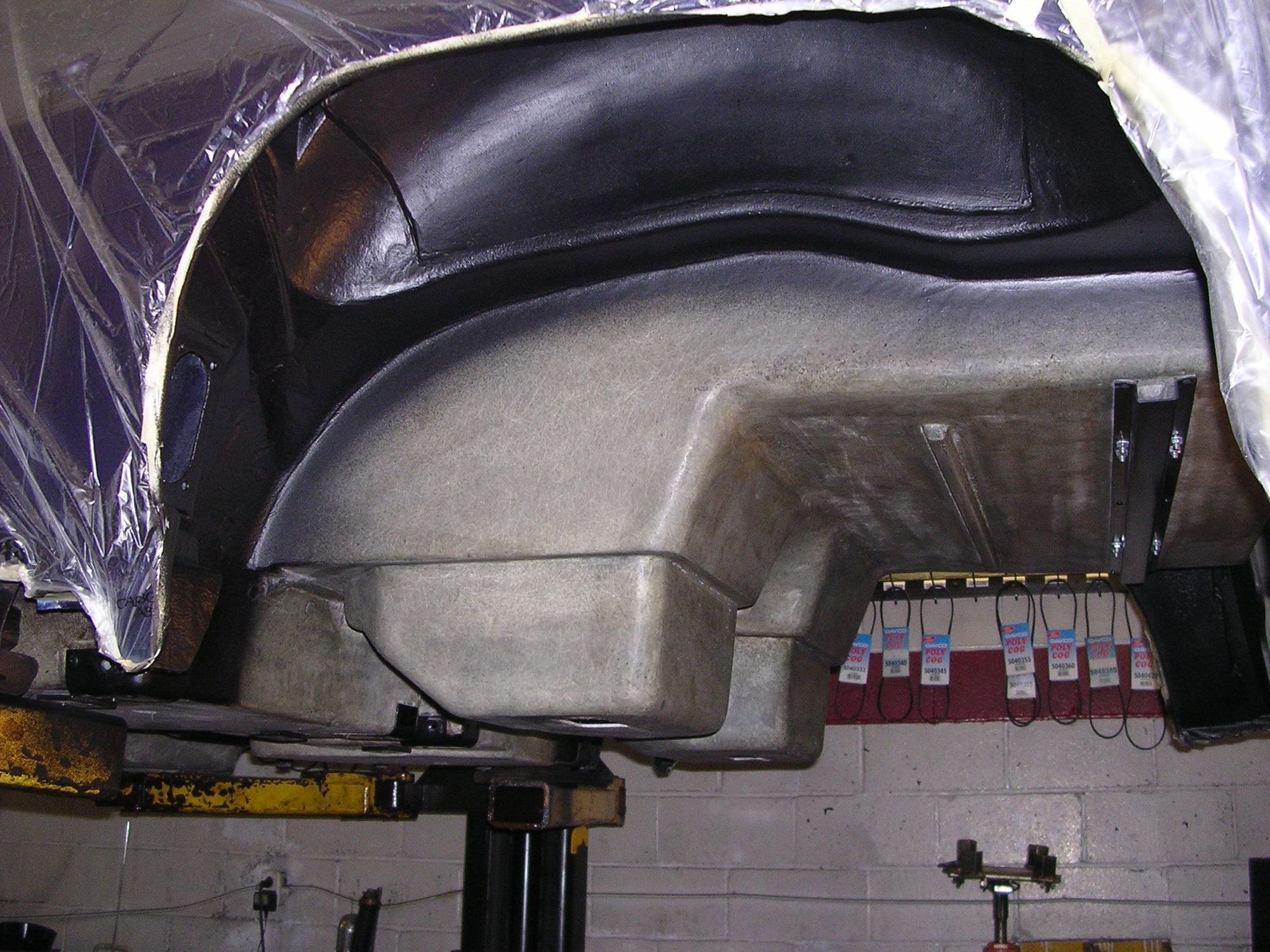

My 63 Tanker restoration they were not call patches, each rear Wheel Well section were cut out and wheel well caps were installed and bonded from the inside to give extra clearance for larger tires
