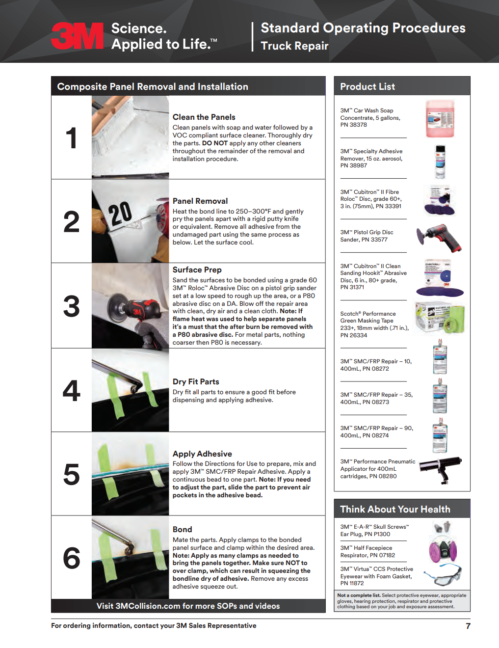

This 3M procedure for heavy truck panel repair may be of some interest. Hoods for over the road heavy trucks these days are almost exclusively adhesive bonded assemblies of SMC, FRP, or pDCPD without mechanical fasteners. The procedure below and link describe panel replacement steps when spot or local repair is not possible and the entire panel needs to be replaced.
composite-panel-removal-and-installation-hd-truck-sop.pdf (3m.com)
