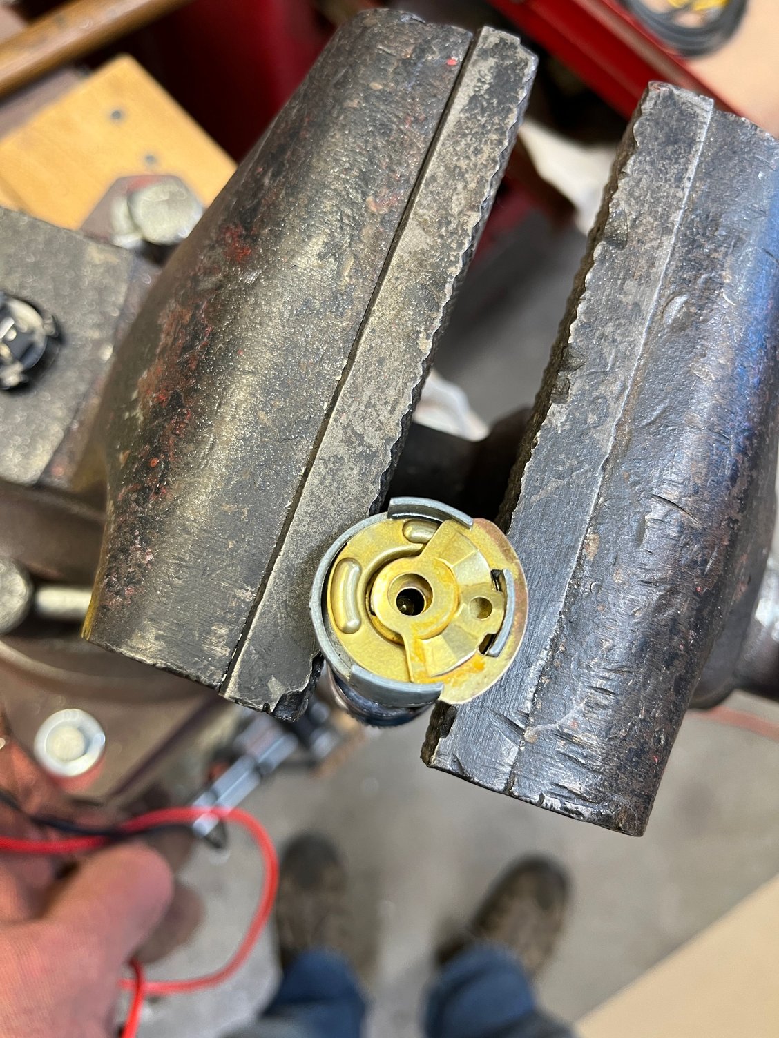

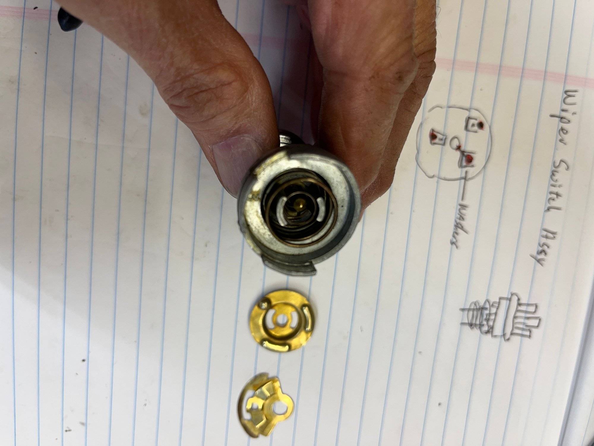

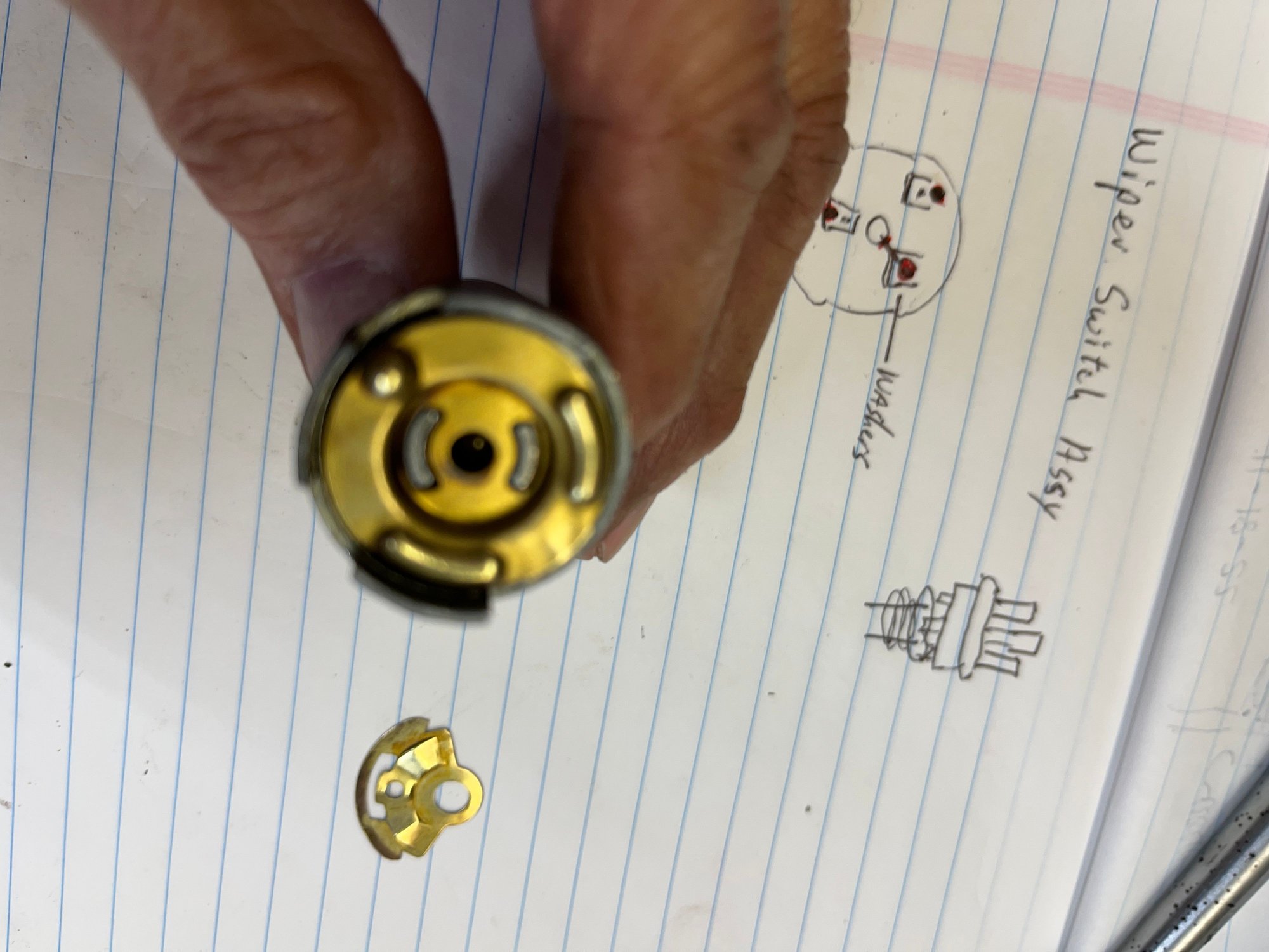

If its the factory switch....Mine came appart when trying to unplug it for removal. It had been appart before and not properly crimped. I have pictures of how it goes together. Picture in the vice is ready for reassemble. Big-K

Thanks, Big-K. The pictures are great, but bring sadness to this garage, as it appears we are missing a piece. This is the second time the switch has come apart. First time was a couple years ago. It went back together so easily, I just stuck the pieces back together and reinstalled the switch into the cluster & cracked open a beer to celebrate another victory. This time, when I got everything out, I had only one of the brass-ish looking plates (the circular one). Cannot, for the life of me, figure how the switch has worked since I put it back together last time - the mysteries of mid-year corvettes. Any how, thanks for your quick response. I've now got it saved away on the computer and am moving on to Railroadman's suggestion to get a new one.
