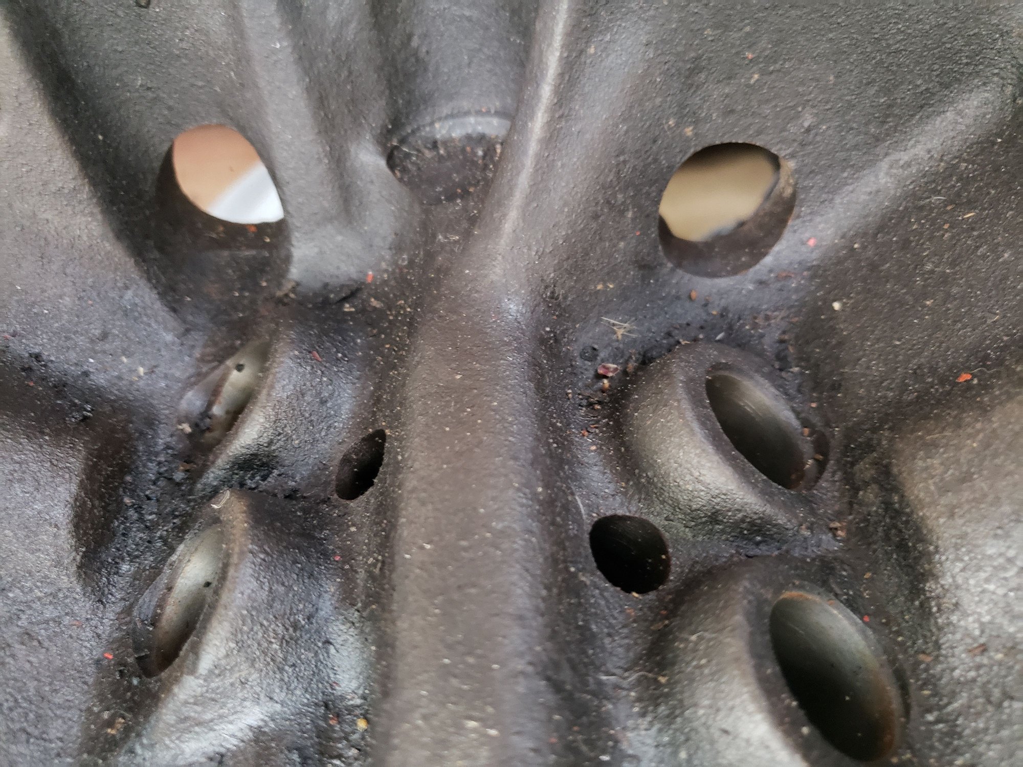

I am looking at this block to replace my blown engine.
I am not having a lot of luck so far figuring out what it is out of, year, etc. Worried if it has the opening for the road draft tube (I want to use the finned aluminum type).for pcv.
Any help on identification and suggestions on suitability for use for my rebuild is appreciated. My plan is correct looking 327, look, sound, and perform like original higher hp 340 hp plus, carb set up with practical upgrades where they make sense.

1968 2-bolt The H is a mystery to me. It should be followed by another letter. Try cleaning the surface. Dennis

The partial VIN shows a D for Dorvaville GA. assembly plant, they built Impalas there, so the H makes sense, although it should have another letter following it. It would have been a 250 or possibly 275 hp 327.
If the block is in good condition, it should work fine for you, as it should have the draft tube hole, etc. Of course you'd want to check a lot of things about it before buying it....like any other used part..

I agree it is a D for Doraville. Which is consistent with what they told me (Impala).
The year had me confused. I think the H is HM. It is hard to see in pictures. I saw HM for both a 65 and 68. So if it is a 68 I was not sure if there was still a draft tube hole.

If you don't have the block to look at, get more pictures of it, showing the entire block from a few different angles, if possible. But that casting number block should have the hole in back. That was the last of the engines that had it.

Here's a few pics of my 68 L79 block (Chevelle L79). In 68 they still had the casting where the road draft tube used to be but in 68 it was not open anymore.

Are you planning on having the block decked to remove the numbers? The T indicates it's a Tonawanda small block of which none were installed in Corvettes, so correct looking would be an F for Flint engine plant. I'd remove the stampings altogether.

Looks like an HM in the picture to me.

Couple more pics.

Yea, that was my fear/concern.

I agree with Factiod, it looks like "HM" to me too, a 68 327/250 with a Turbo Hydro in a passenger car (except Corvette). The "660" was a new block casting used in 68 only, so I'm pretty sure it won't have the opening for a road draft tube, and probably not even the boss for it.
"HM" was also used for the 65 Corvette 327/365 and the 69 passenger car 350/250, but the casting number identifies it as a 68 engine.

The last block to have the rear crankcase vent provision was casting 3933180, this is a large journal 327 used through 1969.

Thanks. This is consistent with what my friend who found it for me said (large journal). And what it looks like as far as rear crankcase provision.
Now, will I still be able to keep finned valve covers. Not liking any of the options I am finding so far. Still researching whether large vs small journal will matter to me. I wanted 6500 rpm and small journal but sounds like this will be going in a different direction with this block.
