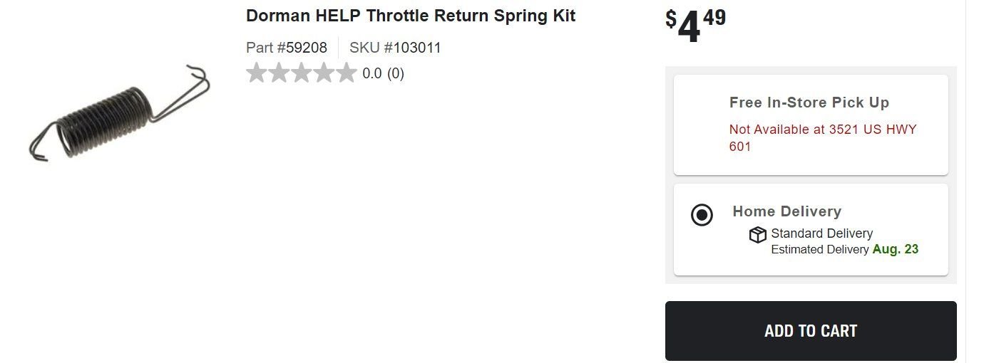

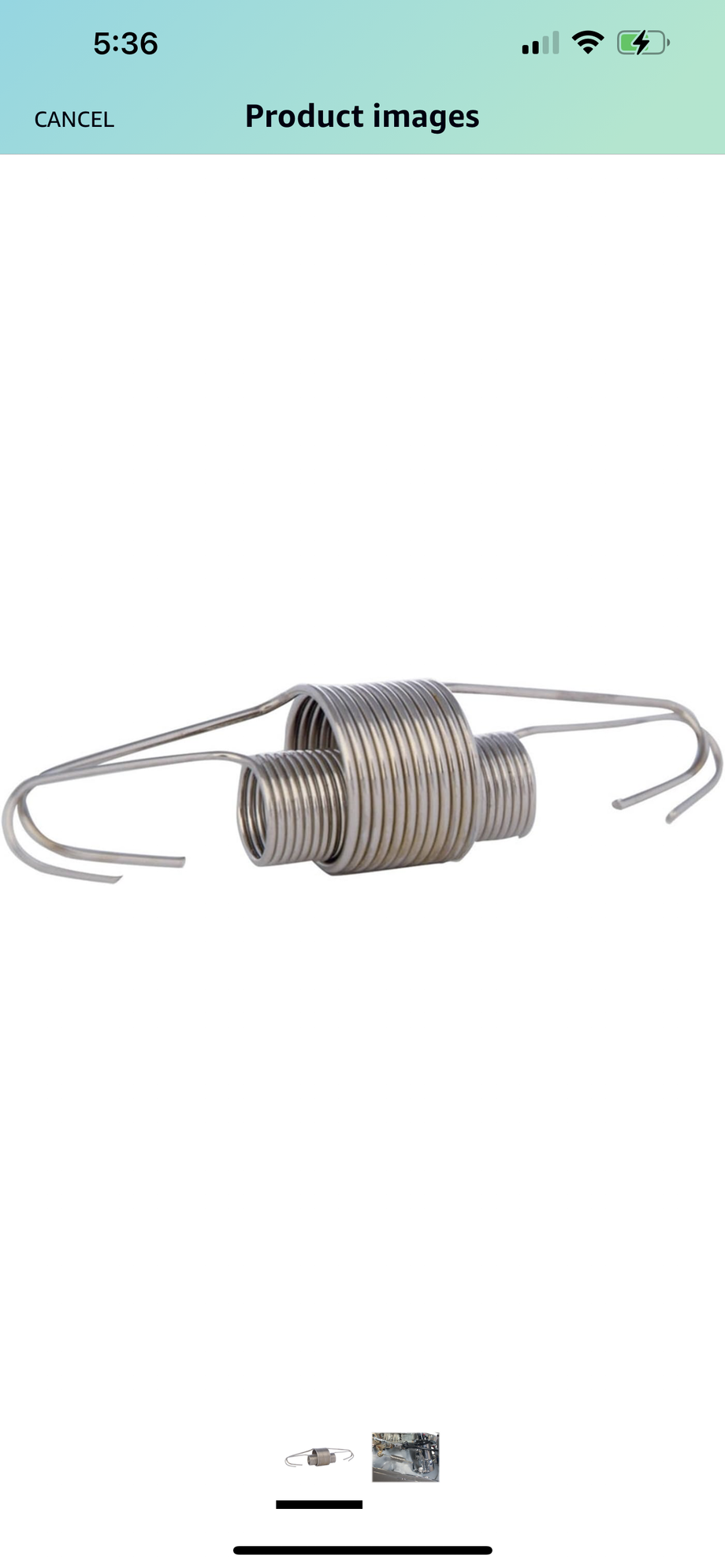

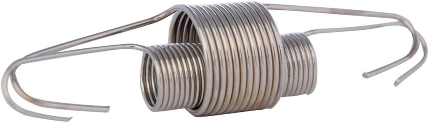

There's a least a half dozen ways to run a double spring. Some are practically invisible. Go to any auto parts store and look at throttle return springs. The have different lengths and strengths. Having two won't hurt you, here's just two types. There are more. I ran the first pictured below on my C2's because they didn't look like doubles and if one "hook" broke or slipped off, there would be a second. For no particular reason, I have a single on my 60 283 230hp and it's doing fine too.
