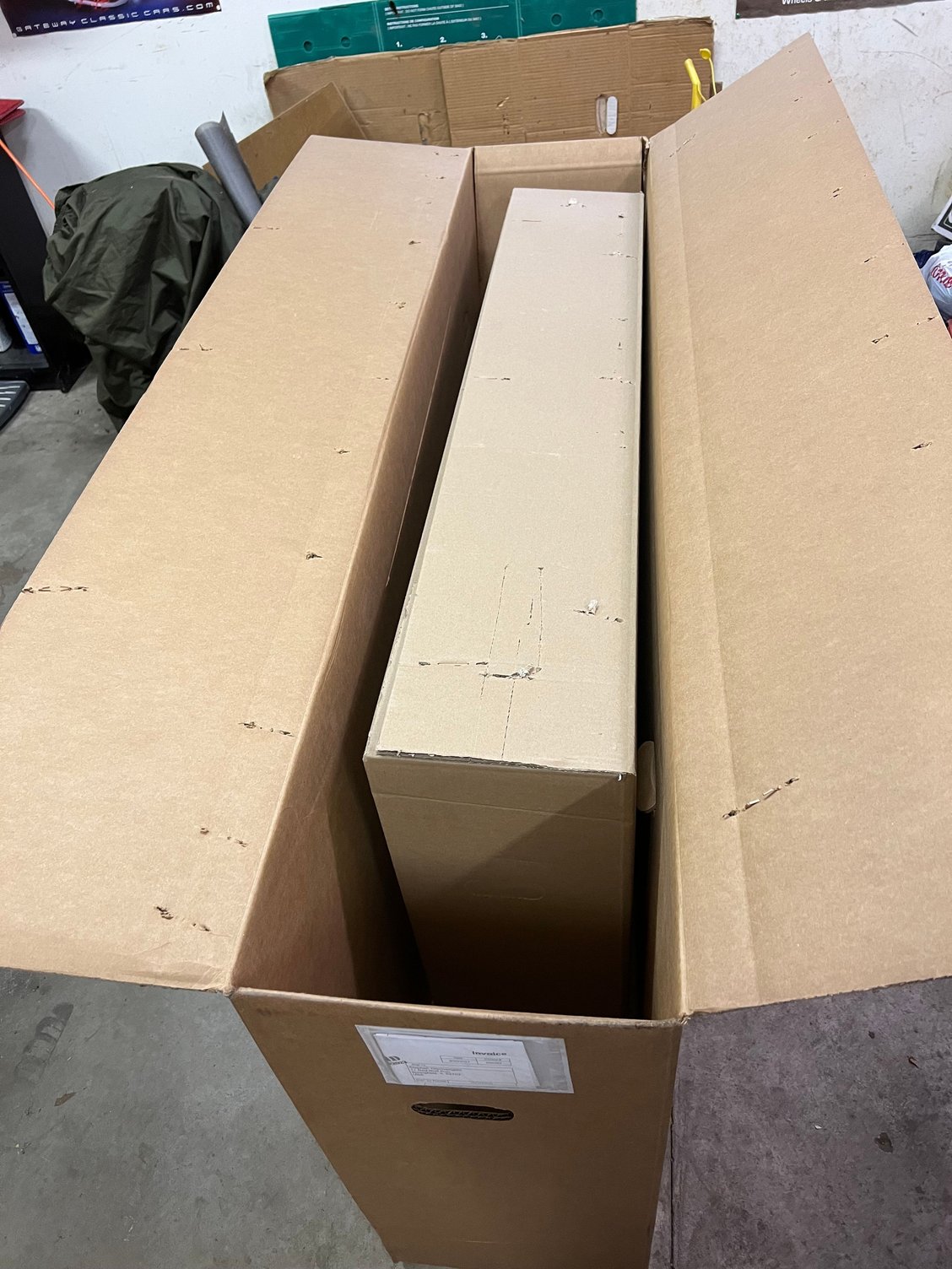

So I ordered the windshield and it arrived, with gasket, dated and marked properly in 6 DAYS in a bulletproof box, markings as hoped for:
